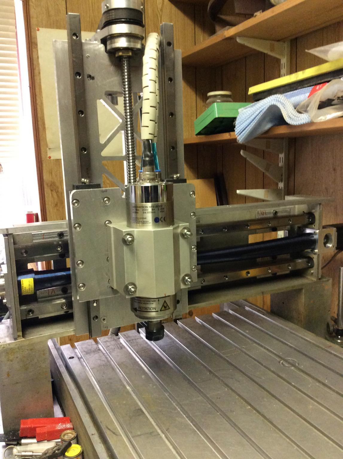

    This is from my own way of working I think you are going way overboard with the construction of the Z axis adding more and more to it.
    I made a Z axis 510mm high x 220mm wide using 12mm backing plate with cut outs to ease the weight on the Y axis with 20mm Hywin rails direct on the plate no packers and carriages direct on the spindle plate, I made a rotating ball nut and fixed 1605 screw which helps to have the very minimum of overhang and adds to the strength of the design.
    Attachment 27525
    It carries a German 2.2kw water cooled spindle, (I know not as heavy as yours) I do not get any drop of the Z when powered off weather this is down to the 2 to 1 reduction to the nut I am not sure but it works very well, it has cut wood, plastics, aluminium, steel plate and stone with no problems whatsoever.
    Recently I setup a 4th axis to cut 2 1/2D designs around the edges of 150mm disks again works really well.
    I am currently designing another machine with extended Y axis to be able to have a 4th axis running down the length of the X axis, and be able to cut around 300mm dia disks and have no problem using the same kind of design in fact I am going to use a rotating ball nut on the X & Y axis as well it is more compact and so smooth compared to turning screws.
    Attachment 27526
    Phill

    I did say I was throwing a spanner in the works, I know it's not a conventional way of making this and yes contradicting to what has gone before but it works and works really well it is compact, less weight, and the machine cuts very well, just wanted to give you an idea of what works without going to far.
    The screw is bolted tight to bottom of spindle plate (no bearing) and screw goes up with plate, attached is an image when I first put it together.

    Oh my! You have quite some Z-axis travel height there. I can see that the screw will be sticking out in the air when Z-axis is fully retracted (at the top end position). I think you rarely use that Z-height or are you doing some custom jobs?
    Looks like the gantry clearance is around 100-120mm, am I right? It would also be interesting seeing a video of its performance in aluminium/steel!
    You have definitely given me something to consider, thanks for that.

    You can't be serious.? You are using a rotating ball-nut on the Z-axis and you think he's going overboard with things.!
    That design with the screw sticking up 400-500mm above the z-axis when at the top is just a crazy, pointless design and overly complicated for its application. Rotating ball-nuts are great on longer axis but for a Z-axis they will make no difference because the screw is so short that whipping or inertia don't factor into the equation which is the only reason to use a rotating nut, even with servo's which spin much faster than steppers.

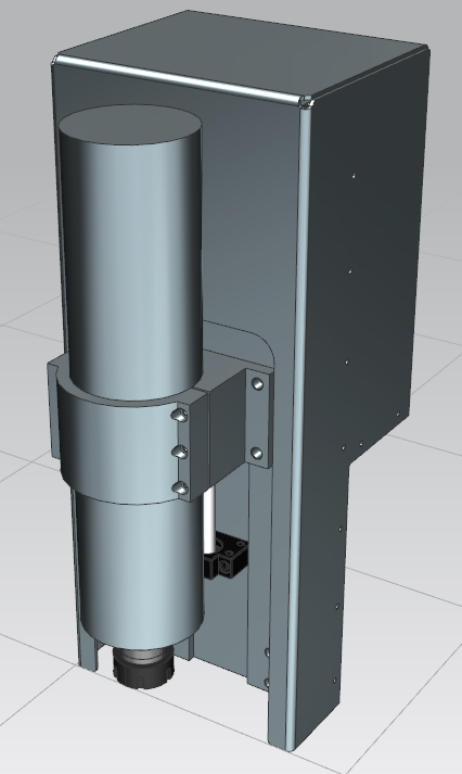

    JAZZ, I think the way you have installed the pneumatic actuators and the Z-axis cover design is great! The whole machine design is phenomenal.. I hope you don't me taking ideas and copying some features from it?
    No don't mind at all , go for it.! . . . Thou bare in mind some of these pictures are not of the finished article, the covers, for instance, are still missing some fastenings and slot covers, etc but hopefully show what I've been saying.

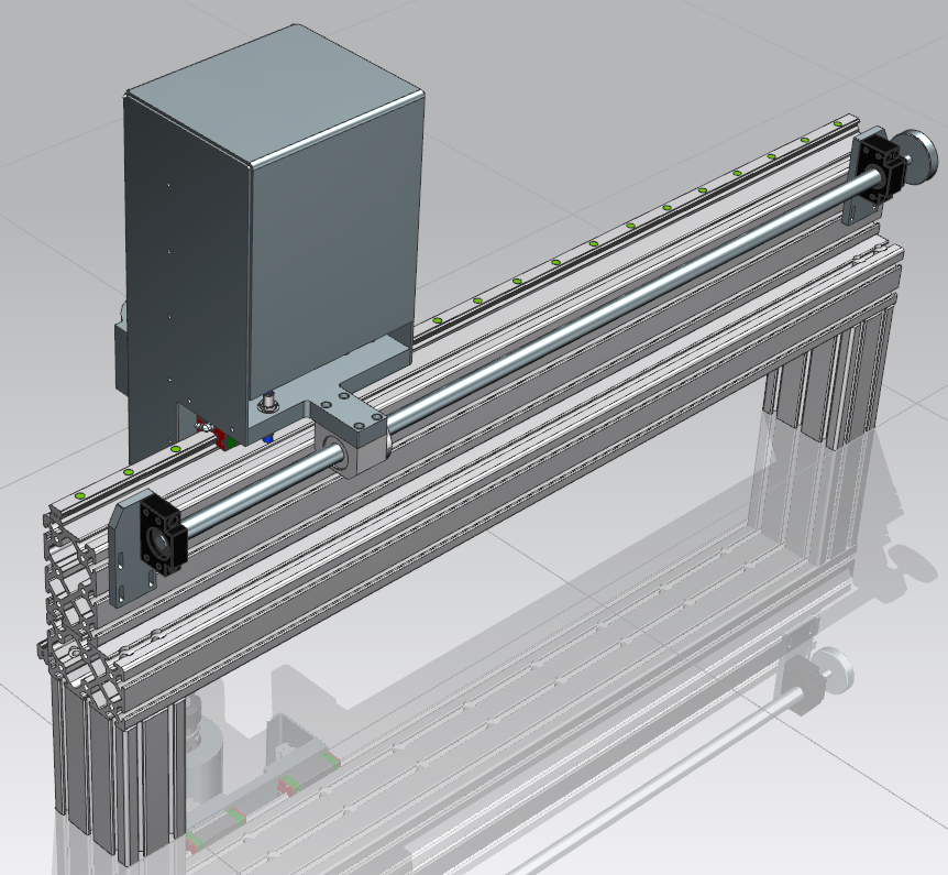

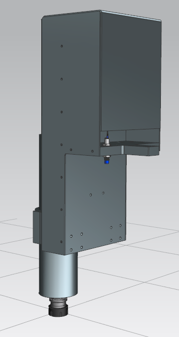

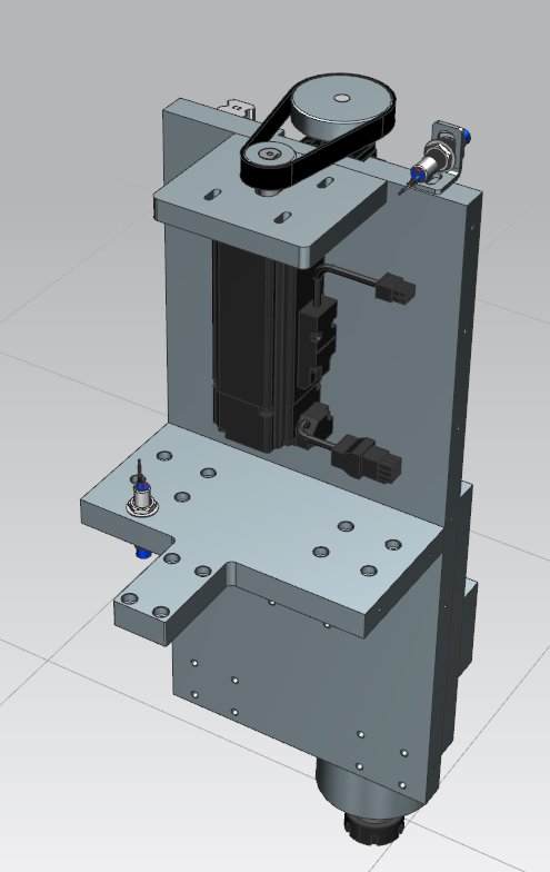

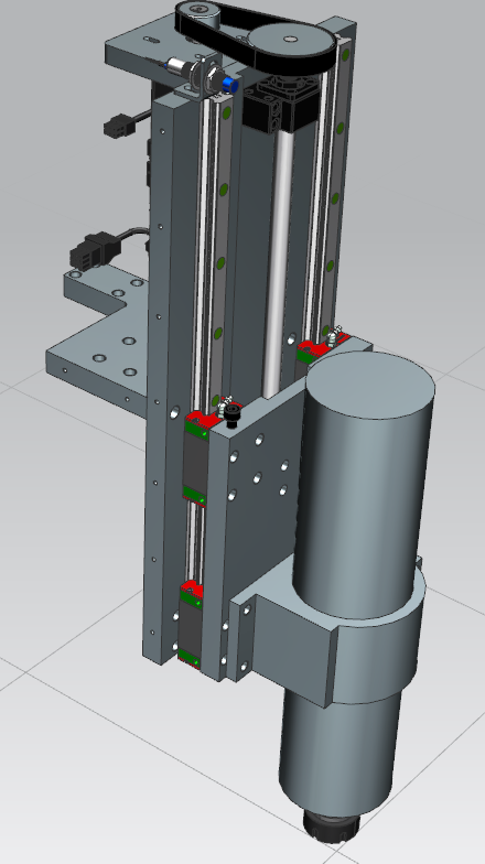

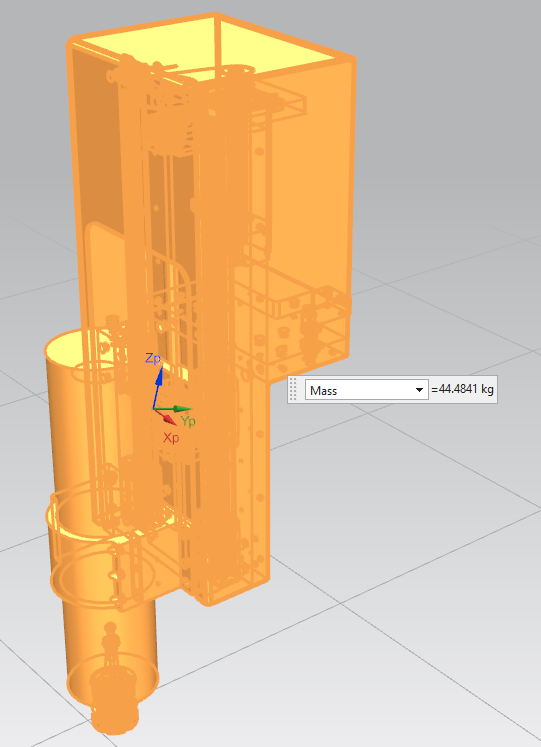

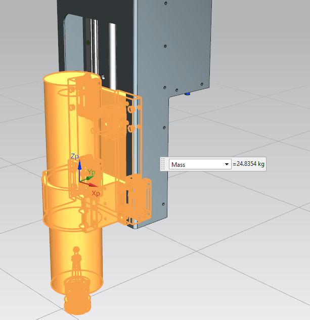

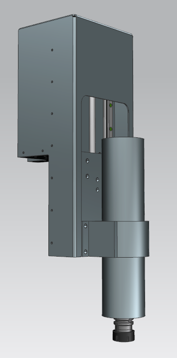

    Short update on the Z-axis design! You might notice that the design is heavily influenced by JAZZCNC's build's (e.g. the cover and L-shape gantry), although still very different and definitely no where near his quality!
    Modifications:
    1. Based on feedback I have now removed the stiffening ribs from the front plate. The reason is that since the front plate is directly mounted to the X-axis bearings with literally no overhang, the stiffening ribs would add nothing but weight. Instead a 3mm aluminium sheet is bent and welded, forming a cover that is structural while also protecting the components and cables from chips.
    2. Removed the linear rail spacer plates and added machining to both the rear and front plate, to make room for the BK12/BF12 bearings and the 1605 ball screw.
    3. 180W servo motors are no longer a constraint. Now I am thinking about getting Delta 400W servo motors. On the Z-axis I plan to use one with brake: https://www.aliexpress.com/item/3267...23d152a8ZJcwMZ. On the X- and Y-axis I plan to use ones without brakes: https://www.aliexpress.com/item/32671356516.html?spm. All axis with still be geared 2:1, to limit the ball screw maximum speed to 1500rpm.
    4. Modified the top bearing plate to account for BK15/BK15 bearings and 2010 ball screw on the X-axis (in design process).
    5. Preliminary positioning of proximity switches. The X-axis will only need one, but for the Z-axis I might need 2 if I can't find a location which I can use for both homing/top limit switch as well as bottom limit switch.
    6. New Z-axis weights are 45kg (total) and 25kg (moving).
Name:	Z-axis cover front 1.PNG
ID:	27538 Click image for larger version.
Name:	Z-axis cover front 2.PNG
ID:	27539 Click image for larger version.

Name:	Z-axis total weigth with cover and delta servo.PNG
ID:	27543 Click image for larger version.
Name:	Z-axis moving weigth with cover.PNG

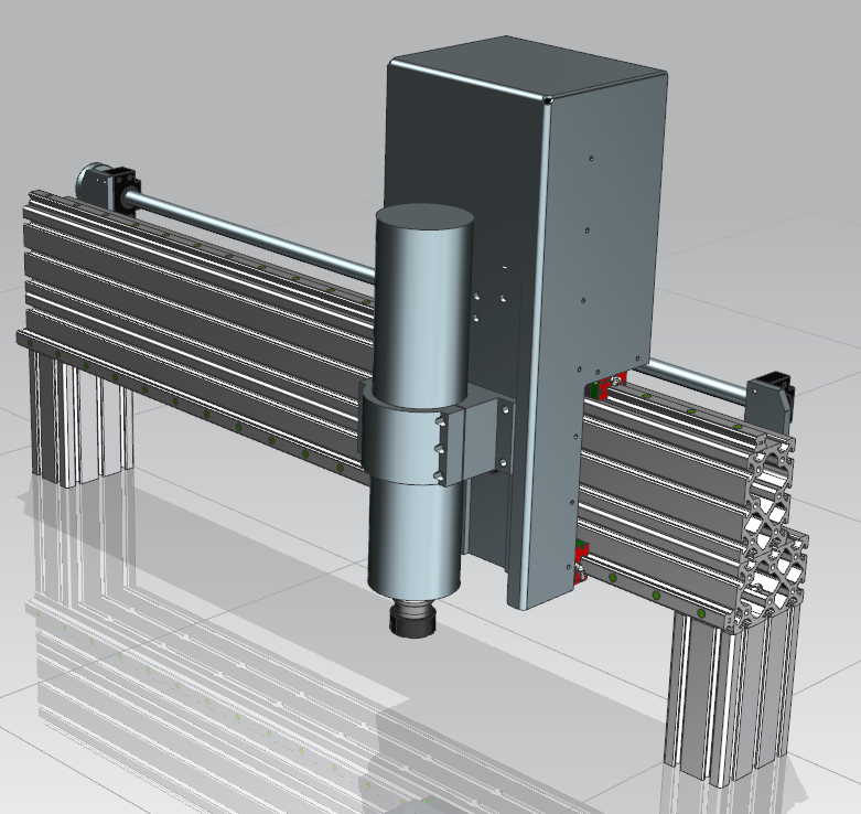

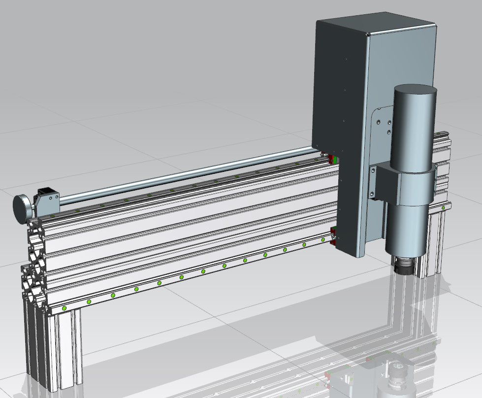

    Here is the Z-axis mounted on the draft X-axis design, made with 120x80 Item profiles (I will post a more detailed X-axis design description later):
Name:	Z-axis on X-axis draft 1.PNG
ID:	27545 Click image for larger version.
Name:	Z-axis on X-axis draft 2.PNG
ID:	27546 Click image for larger version.
Name:	Z-axis on X-axis draft 3.PNG
    Its not easy or practical to put a bottom limit switch on the Z axis as the tool lengths will all vary .
