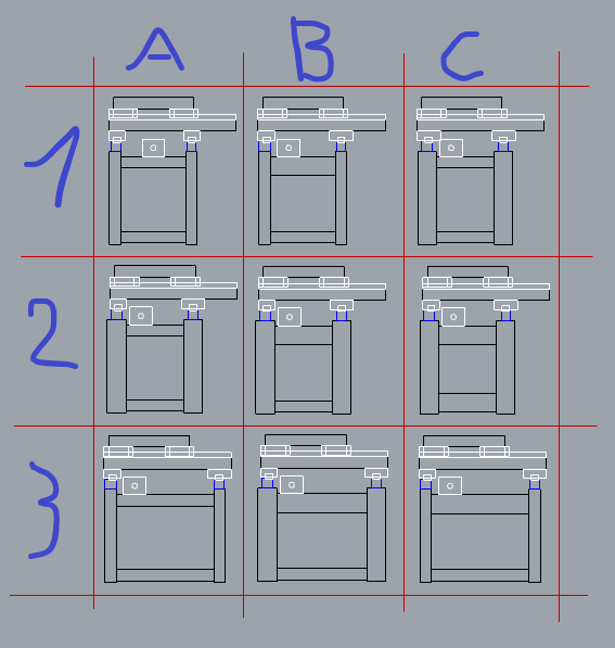

    I'd like to start a discussion about my next diy project, please comment.
    This would be a tool for a single/specific job, with following requirements (based on workpiece size and tools used):
    travel length: 1100x100x50mm
    precision (positioning accuracy,straightness): 0.05mm/300mm C7 ok
    positioning repeatability: at least 0.05mm (minimum backlash)
    working speed: 8mm/min
    acceleration: 3m/s^2 or better
    max cutting forces: 180N (8mm 2fl carbide TiCN DOC=14mm WOC=2mm HSM toolpath S19630 F4466 P=1.38kW CF=17.3kg says FSWizard)
    Since one axis is extremely long compared to the other two, "traveling colum" seems to be best configuration.
    I made an initial sketch to get some idea about size and mases:

    I've checked preloaded brand name ballscrews on ebay, and found few solutions for Y and Z. I have to select ballscrew for the min possible diameter (inertia) and required stiffness.
    Considering 180N load and 0.05mm allowed error, can I assume that total stiffness of the machine at the tool tip should be no less than: 180N/0.05mm=3.6N/um? Would then a 12mm dia ballscew with rigidity(K)=120N/um be enough?
    I've sketched a solution for X axis base. Tubular structure would be made from a 50mm thick granite slabs, glued and fastened together with screws. Steel rail supports would be fastened on top with screws and epoxy, and then shaped and ground to create plane for mounting rails. Would a rail span of ~200mm be enough (I see that span used on gantry machines)?

    Hi mbele,
    This is gonna be an intresting build if your total allowed error is <0.05mm @ 180N
    What servos can run at 180n at operating speed. Did you check the stepper calculator on this site?
    Also please check what happens with 180n force in all directions at the tool tip on all (moving) parts combined.
    One does realise quite quickly that everything looks like made of rubber.
    Grtz Bert.
    Bert, thank you for your comment.
    180N/0,05mm may be wishfull thinking. I can probably reduce that requirement to half, with 8mm 1fl carbide endmill doc=20mm woc=0.5mm S24k F7238 P=0.82kW CF=8.5kg, but even if that proves to be unrealistic, it cannot get worse than my current setup which can complete the part.
    I've made my own calculator (gulp) using example calculations I found in THK/NSK catalogues. It calculates inertias, drive and acceleration torque, required pulse frequency, resolution and max feed using following params:

    Can someone comment on base structure and x/y configuration? I have option to make base out of 30mm or 50mm thick granite slabs. I used gantry stiffness calculator I found here to get rough numbers, and it seems that 30mm would work... I don't know how to upload modified excel file, so here are the params I used:
    Length=1500, material 5.00E+04 / 2.7E-06 / 24000
    Z load=500 simply supported
    X load distance=150mm, 200N
    Box section, width=250 height=230 thickness=30
    (Young's mod for granite is 10-70GPa, I used 50)
    It showed 4um deflection due to 50kg load, and 0.25um tool deflection in torsion. Actual base length will be shorter, depending on the x axis block span, so I expect better results for deflection.
    Here are the sketches of granite slabs configuration:
Name:	base conf sketch.png
    I'm wondering if there's a gain in moving X ballscrew from midpoint between the rails towards the tool/load side, and if the overhang of Y axis bed would be a problem.
    Mihael

    Column would be made of aluminium, y bed 30mm thick, sides and Z bed 20mm, Z ballscrew support and supporting triangles 15mm. Rals for X would be Hiwin QHH20 or LGW20, for other two axis I can use SHS15R or LGW20 (that's what I have available).
    Base structure looks flimsy compared to the rest of the machine, so I'm thinking of using 50mm thick granite slabs...
    I've compared this idea with
    https://www.youtube.com/watch?v=ewU8zWnuE3s
    (I think Piotr's machine seems rigid enough to perform the job I had in mind)
    The bigest revelation I got was that torison in the granite base should not be an issue in this build. In the moving gantry configuration, whole length of the gantry is subject to torsional forces since gantry is anchored to the base at it's ends with blocks on rails. In traveling column configuration, torsional forces act on shorter length - depending on how the bed (which stock is mounted to) is mounted to the base structure. So instead of building a ractangular closed section, ribbed construction would work better. Distance between ribs should correspond to X axis block span.
    Deflection due to the weight of the base and the column can be somewhat controled by the distance between the mount points of the whole structure (eg. lengthwise 1/4 free-supported, 1/2 supported-supported, 1/4 supported-free, actually 310mm+780mm+310mm seems like the most balanced ratio)

    Thanks AndyGuid. I think I figured a solution with granite ribs. Currently I'm trying to figure out the best way for implementing chip guards...
    Hah, back to the drawing board...
    1. Z axis travel is too short, I use following calculation:
    (max tool stickout - min tool stickout) + max stock height + clamping height + safety
    minimum: (35-10) + 25 + 10 + 5 = 65mm
    2. To implement apron type chip guard, I need to extend Z axis overhang, and since arrangement was optimised to make tooltip as close as possible to the linear components, arrangement does not make sense any more - Y overhang needs to be extended for 60mm and axis travel is only 100mm
    3. rigidity of X axis ballscrew shaft is 7x less than Z axis ballscrew, so there's no point in beefing up Y and Z if the percentage of their impact on the whole system rigidity is small. X axis rigidity can be improved by increasing shaft dia, but that raises inertia, so 2.7Nm/840gcm^2 stepper would work better than 400W/360gcm^2 AC servo, but that puts me in the no-feedback scenario, so there's no point in using servos on other axes...
