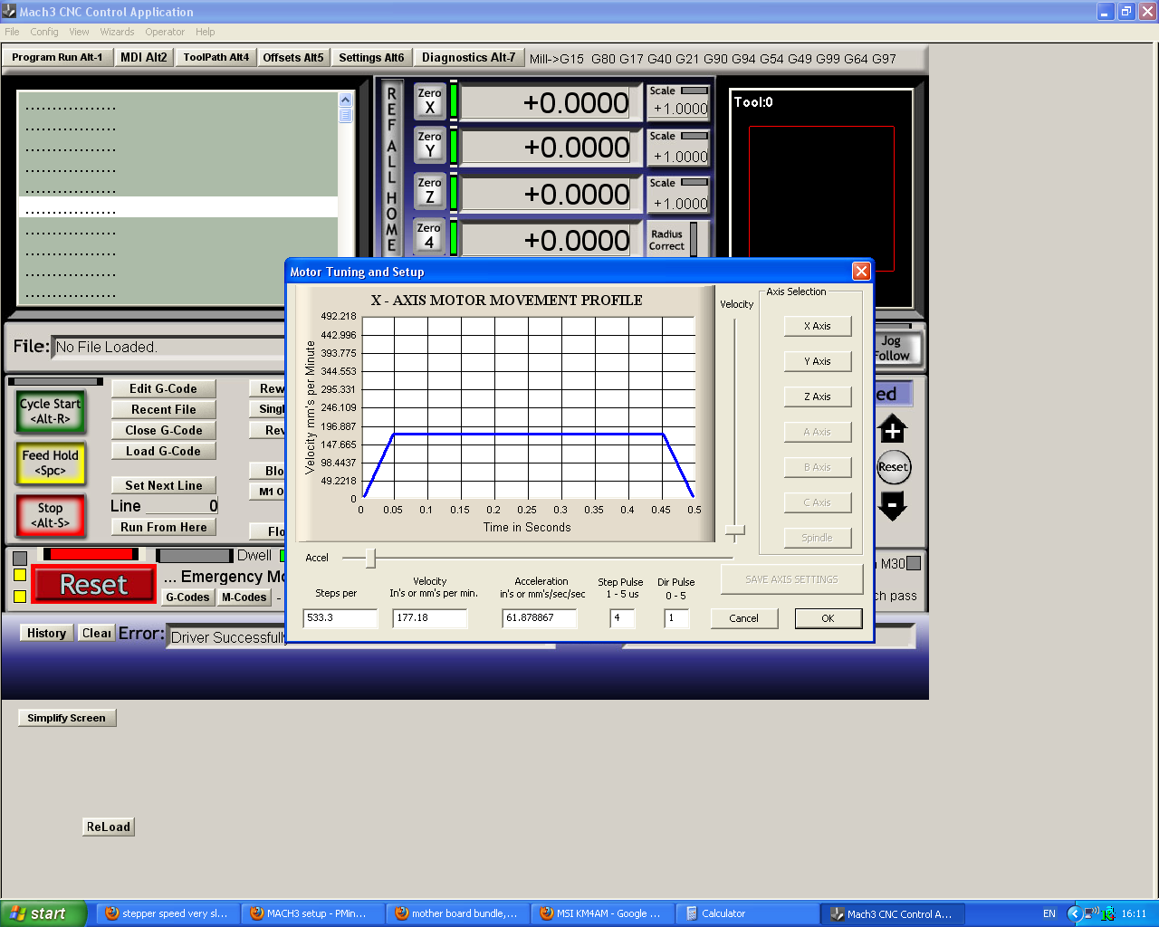

    yes john everything seems free without the screws attached light finger pressure will move them
    It is the velocity and acceleration figures that adjust the speed, what are they set to?
  4. #14
    i have tried various settings in here

    Right the maximum you can do with this is 177.18mm / min if it can get up to speed in time hence your 88mm/min or suchlike.
    Leave the steps alone and increase the velocity to 2,000 to start and acceleration to about 150 as a start point.

    thanks john
    so my steps are set right , will try the settings you suggest, i knew i should be able to get a bit more speed somehow, if i can even get to 1000mm a min i will be happy

    managed to get my speed up , wired the steppers bipolar single coil
    at 2.5 amps the 3nm motors are down to about 2nm but the speed has increased quite considerably can get about over 1000mm/min
  8. #18
    If you increase speed, then the torque will inevitably go down.
