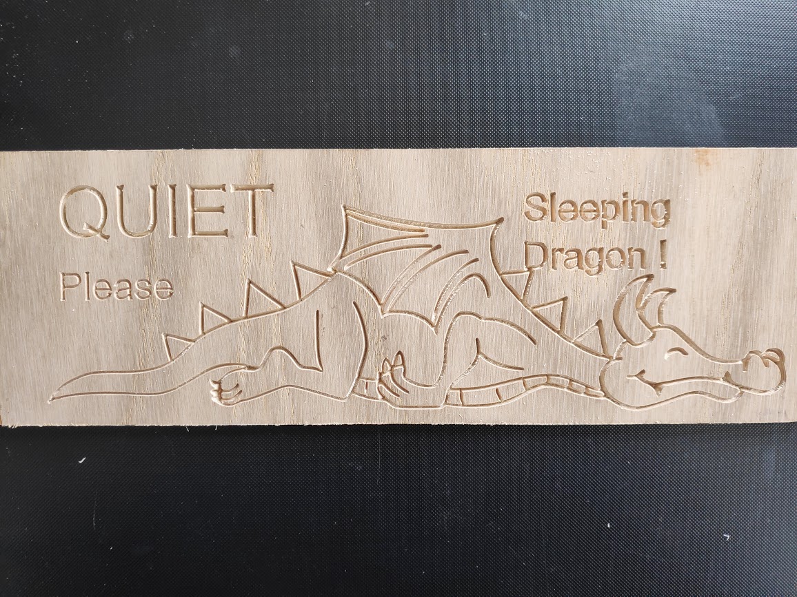

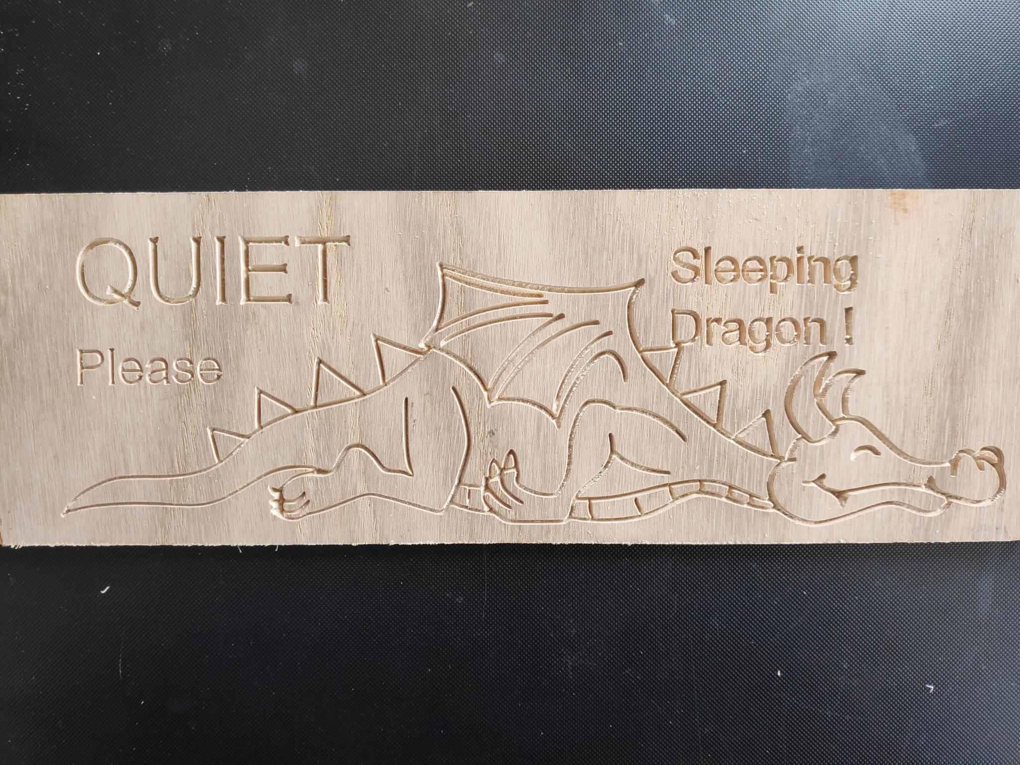

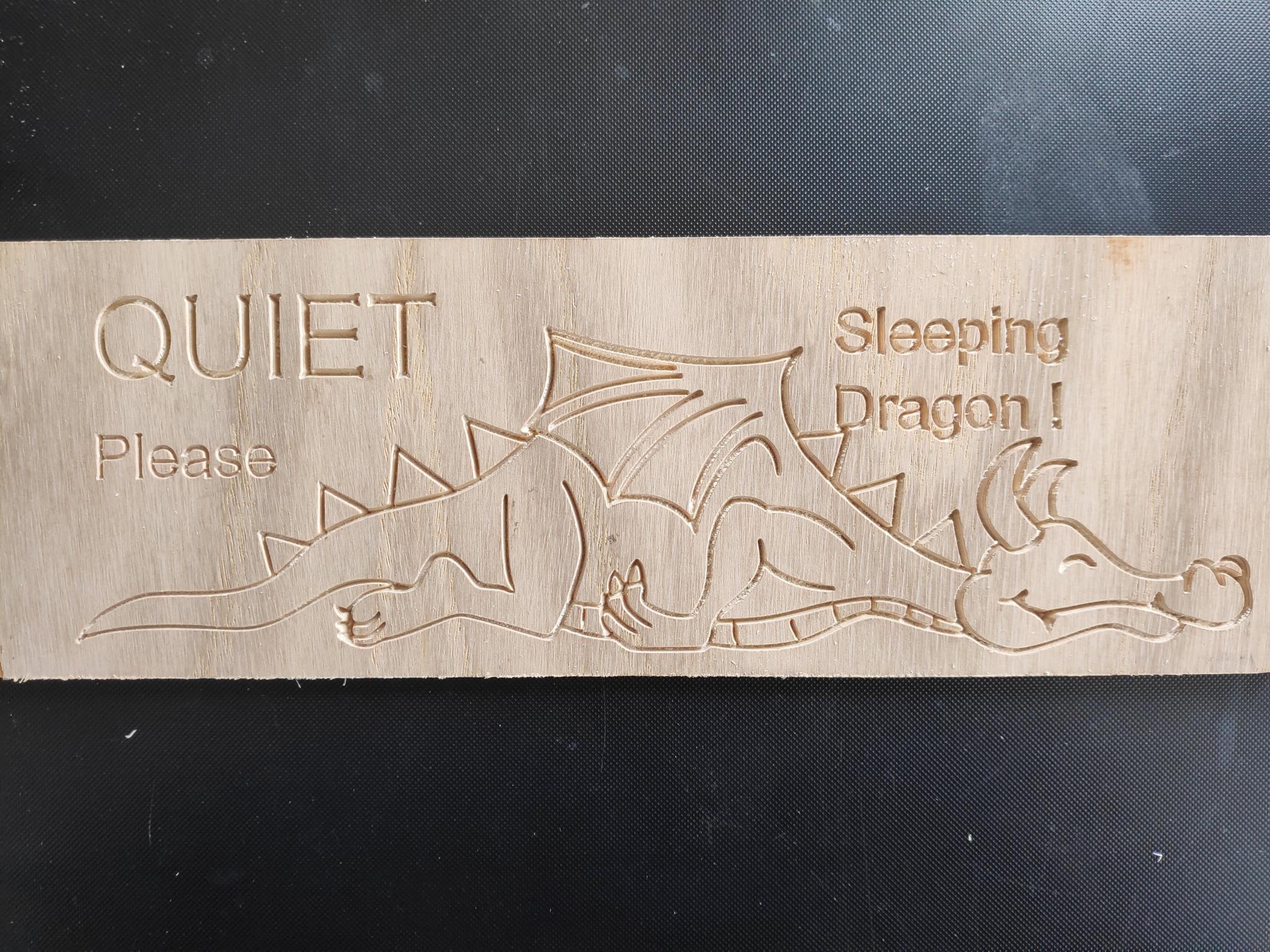

    I've had a go at engraving a plaque and I'm quite happy with the result - EXCEPT - I want to make more contrast between my engraved image and the plain plywood I cut this on.
    I've tried a few experiments
    1/ I first tried cutting with a masking film and then spray painted, but the pain bled along the groove
    2/ Next I tried using a paint line along grooves - messy and unsatisfactory
    3/ I did try spraying the whole surface black an cutting through - but this gave me a light line against dark and I'm looking for the reverse really
    What treatments do you use to get a pleasing finish on your CNC work - I'm planning on working on light oak at the moment . any tips on how to get multiple colours into the finished product ?

    How about lightly spraying everything black, then skimming/sanding the surface to return the uncarved bits to the original colour? Alternatively laminate some thin light oak onto some dyed wood or dark coloured Valchromat and carve through.
    I usually first surface the material, then I engrave 0.5-1mm too deep. After that I paint every thing, byt I try to focus on the engraved part. When the paint has dried I surface the material again, removing the 0.5-1mm. This will give you a nice contour to the engraved part.
    Skickat från min SM-A530F via Tapatalk

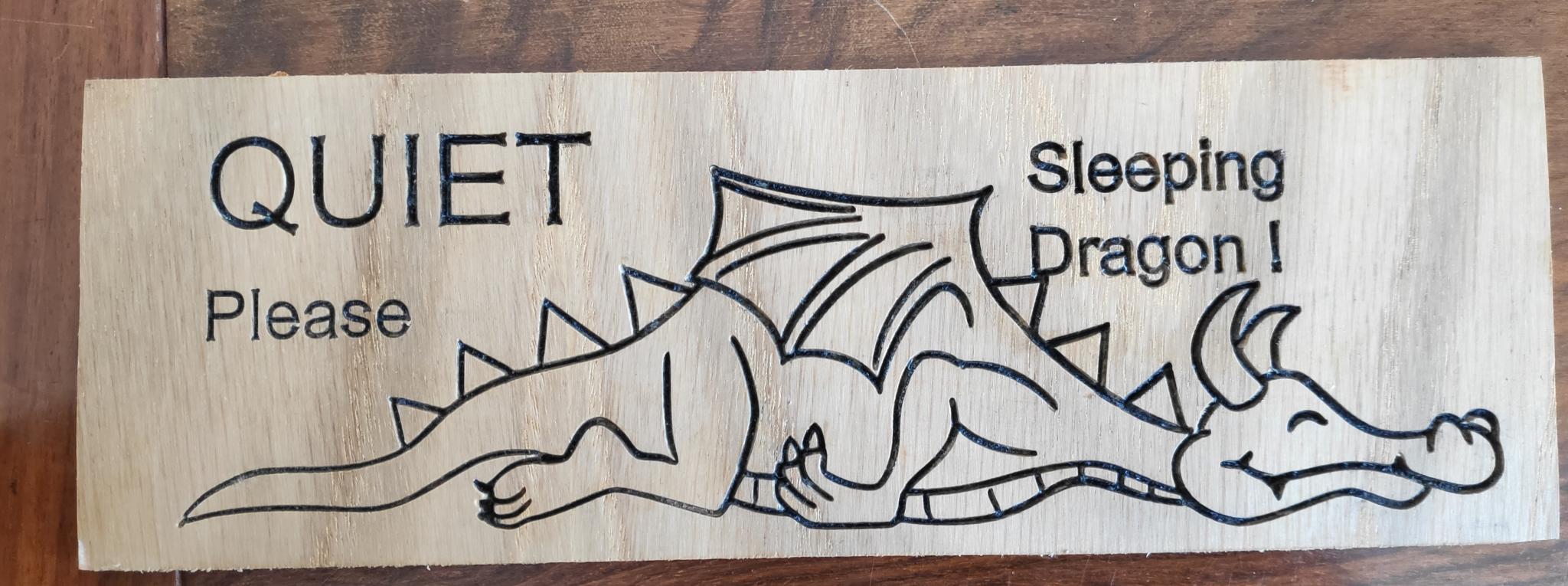

    if you engrave the part using a mask, seal the engraved area with a shellac sealer first before painting it and it wont bleed
    cheers sounds like good advice
    Quote Originally Posted by johngoodrich View Post
    Excellent advice - thanks a lot - made a world of difference - a little surface blurring, but a light sand and a coat of varnish will soon fax that
    Before
    After
