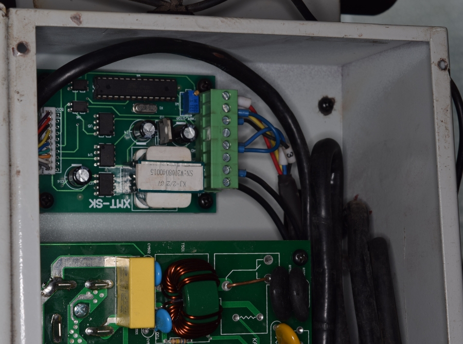

    Still chasing the problem of having no spindle. I've been working with Aturo at cnc4pc but have had little sucess. The only board that hasn't been replaced is the small AP2 board which lies between the BOB and the main motor board. All the necessary voltages are now coming out of the new BOB to the connections at the board. Does anyone know what this sall board does and if outputs can be tested? Getting new AP2 board being hampered by present world situation.

    Okay, I've spent 20 minutes too long trying to find out what the AP2 is, and failed. There's various talks of step/dir controls on the KX3 but I'm minded not to read too much into that at this time. Can you get a photo of the board to perhaps help us understand it better?

    Thanks for your prompt reply. Here is a photo ofthe suspect AP2.Click image for larger version.

    Hope this works.

    I think it is the speed control board, does it have a potentiometer on it.? I think the AP stands for Analog Potentiometer Board.

    Ugh. I wish I'd never asked, now. I'm throwing an awful, awful lot of guesswork into this that might be completely misleading.
    Have you seen this link and does it look sensible and appropriate?
    https://littlemachineshop.com/images...UpgradeKit.pdf
    If only for the association with the board. I'm reading more, and this is hitting the territory I'm in with spindle speed control on a SX2.7. But, my interest lies if this is OEM or a modification to the KX3
    EDIT: Though read somewhere that Sieg used these boards themselves for the CNC machines.
    I'm out of ideas here - there's clearly two opto-couplers that are connected to the spindle-control board - these could be step/dir but that's guesswork. I would expect that these would be involved with the speed control given the nature of this board - if you had access to a scope it would fall into the "interesting" category of investigation, but you're looking at a fairly proprietary interface now between this and the BLDC controller in the Seig.
    But you've convinced yourself that your analogue wiring to the board is correct?
    EDIT 2: I'd check through that link and verify your wiring as a first port of call.
    My experience of the BLDC board is that can be fragile (mine popped two IGBT and a fair bit of collateral circuitry early in its life - replaced under warranty), and you've suggested that you may have had similar problems and replaced the board yourself in the past. So there's a question that you have no spindle control (no rotation)... is it the BoB - you suggest not / this is replaced. Is it this board or the spindle board (BLDC controller) - and that can be a challenge to understand (sorry, that's not very helpful I know)
    The blue thing, top right hand corner of the photo is a trimmer potentiometer, possibly a multi-turn type. The label under it looks like "START/STOP". If you adjust it keep track of how many turns and in which direction so you can put it back where it was.
    Edit: Just made time to read Doddy's link. START/STOP is a label on one of the connectors. The potentiometer is for the speed at max control voltage. Pots can become faulty and go high resistance but it's possible to clean the track inside by simply adjusting it up and down a few times. Certainly worth a try for the time it takes.

    That board looks exactly like little machine shops upgrade board.
    Was the machine bought new by you are did you buy it used? Might be the LMS board in there already. Straight swap.
