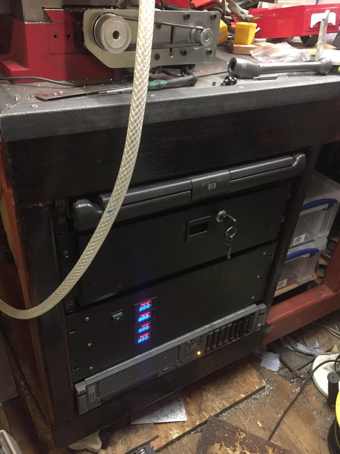

    Bench was the original frame for a router I'd intended to build, but chickened out (it was going to be too large for the shed... so became a pretty handy bench). As part of that original design I'd planned around supporting 2 19" racks - using one of these to fit a HP server, the control box (PSU steppers, motion controller) and a server keyboard/monitor - for which the backlight on the monitor finally failed today...

    The other 19" bay (out of shot) now simply holds my compressor (a silent 25l ex-dentist job). The central bay just holds stock material.

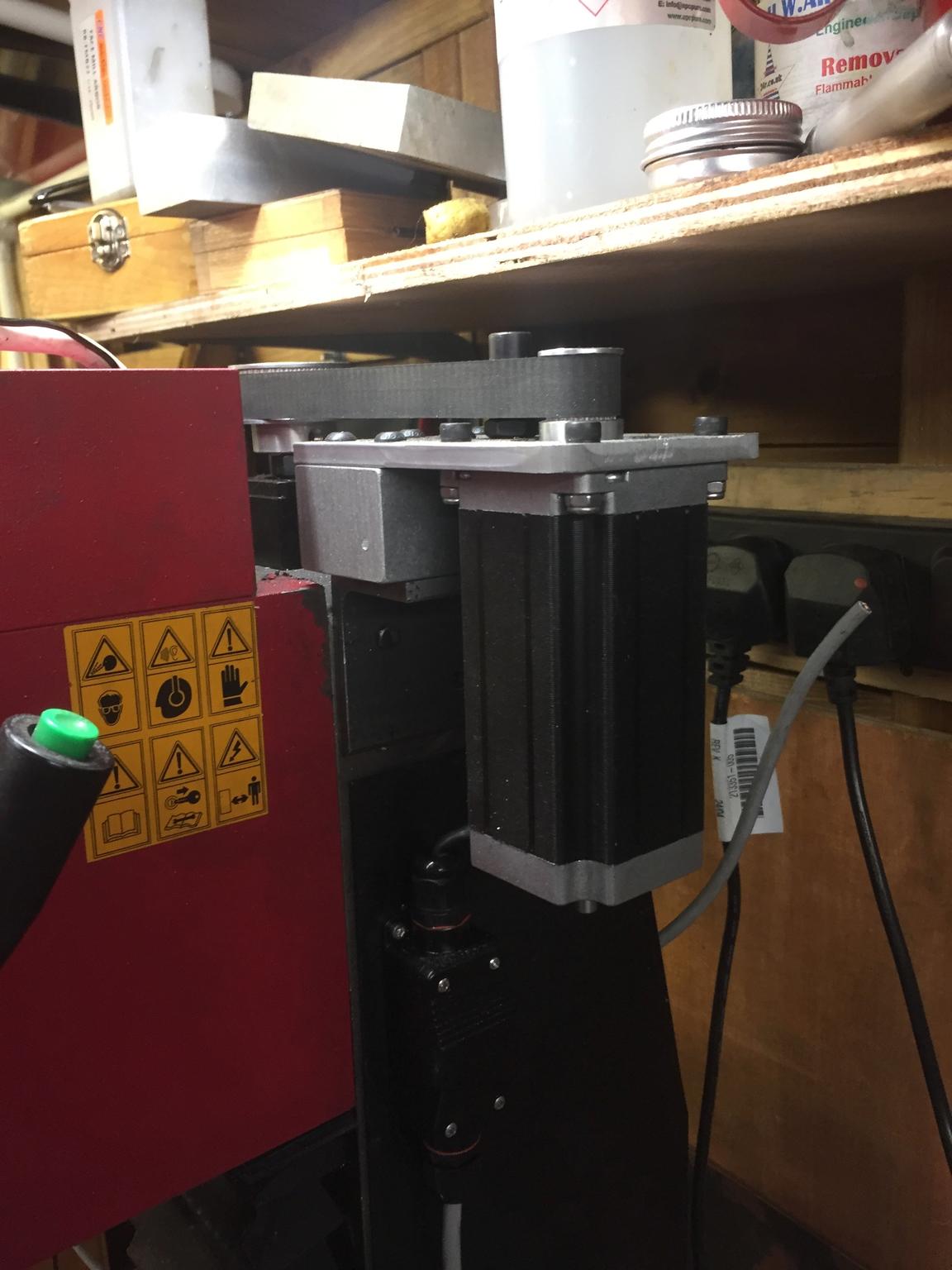

    Z Axis - it's all been done before, I'm just copying others who've converted their 2.7s. Z is by far the easiest axis and the original ball nut holder takes a standard 1605 ball nut. 2:1 belt drive as a general approach to all axis.

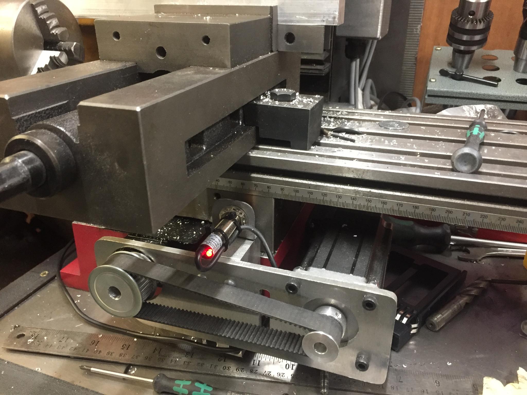

    Some detail on X - ignore the hack job on the ball nut - I was trying to expose the nut holder's bolt hole in situ to unbind the screw that was slightly misaligned after I'd tightened all bolts. That was a difficult few minutes with a Dremel and none too pretty.

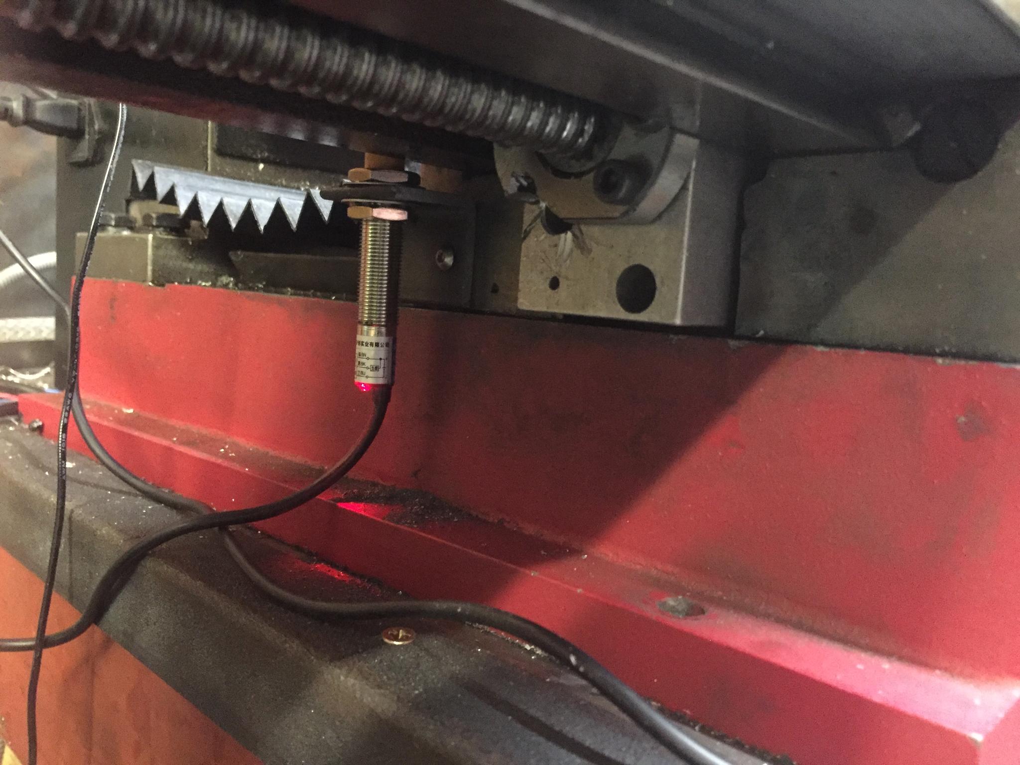

    Y Axis - very much like the others. I'm not sure that I like the limit switch so exposed, so might re-do this once I regain my enthusiasm.
    Control box is a 800VA 50V dual secondary toroidal transformer; rectifiers and 10,000uF/160VDC caps. With bleed resistors - despite arguments on here to the contrary. Stepper drivers are 2DM860H (4 of to support a 4th axis), Steppers are 3.1Nm 4-wire - just cheap eBay jobs. Motion controller is an UC300ETH with a standard parallel BOB. I finally found a use for the 5/24V PSU that I'd stripped out of a laser printer.
    Both Y and Z axis the screws are unsupported, X has a phosphor-bronze bush to support the end of the screw (butchered with a band saw) mounted in the end plate. General approach was limited to hand tools or what I could fit on a Denford Starmill (150x80 table area - somewhat limits options). Oh, and everything with an option to recover the machine back to the original manual control if necessary.
