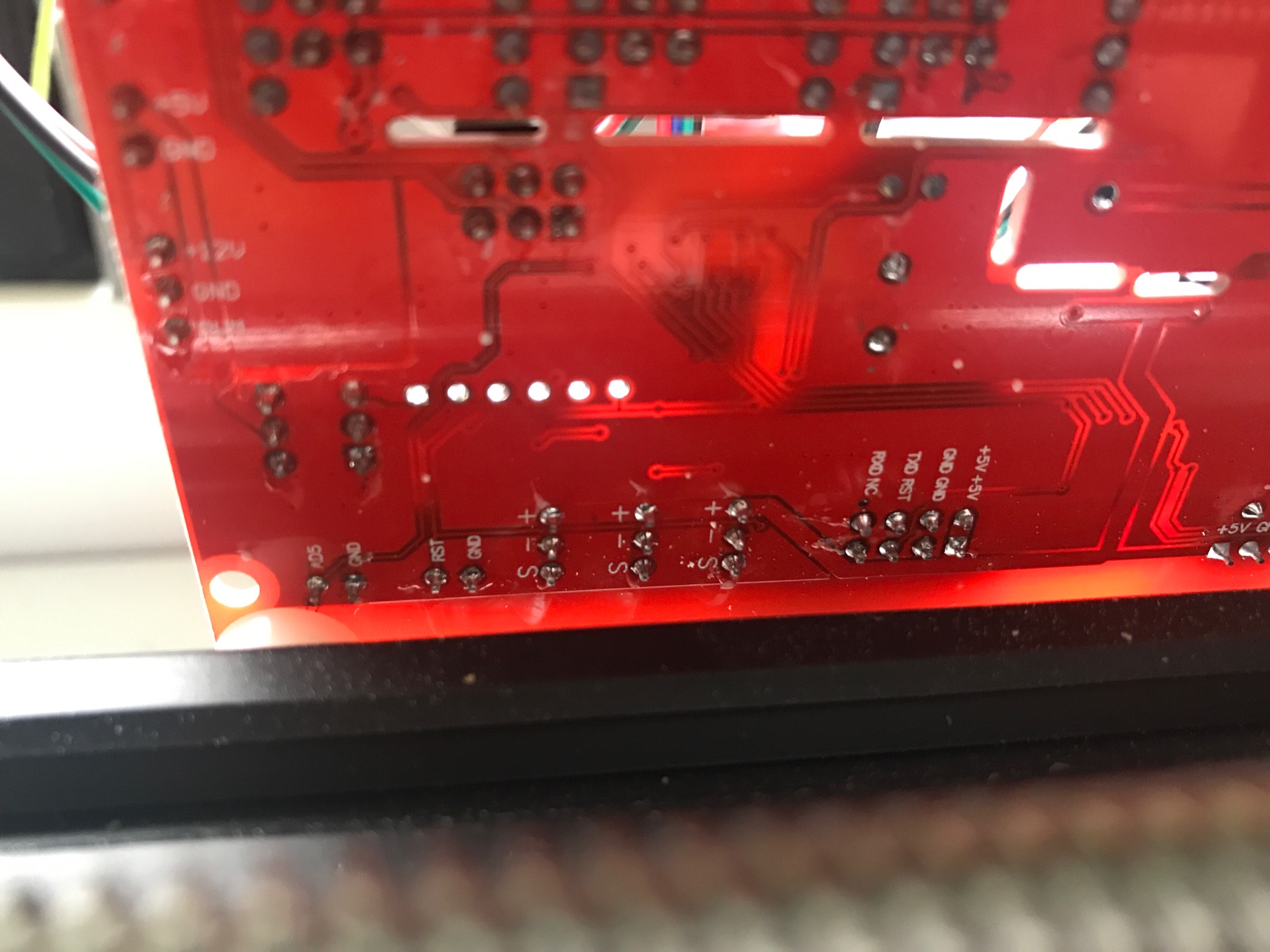

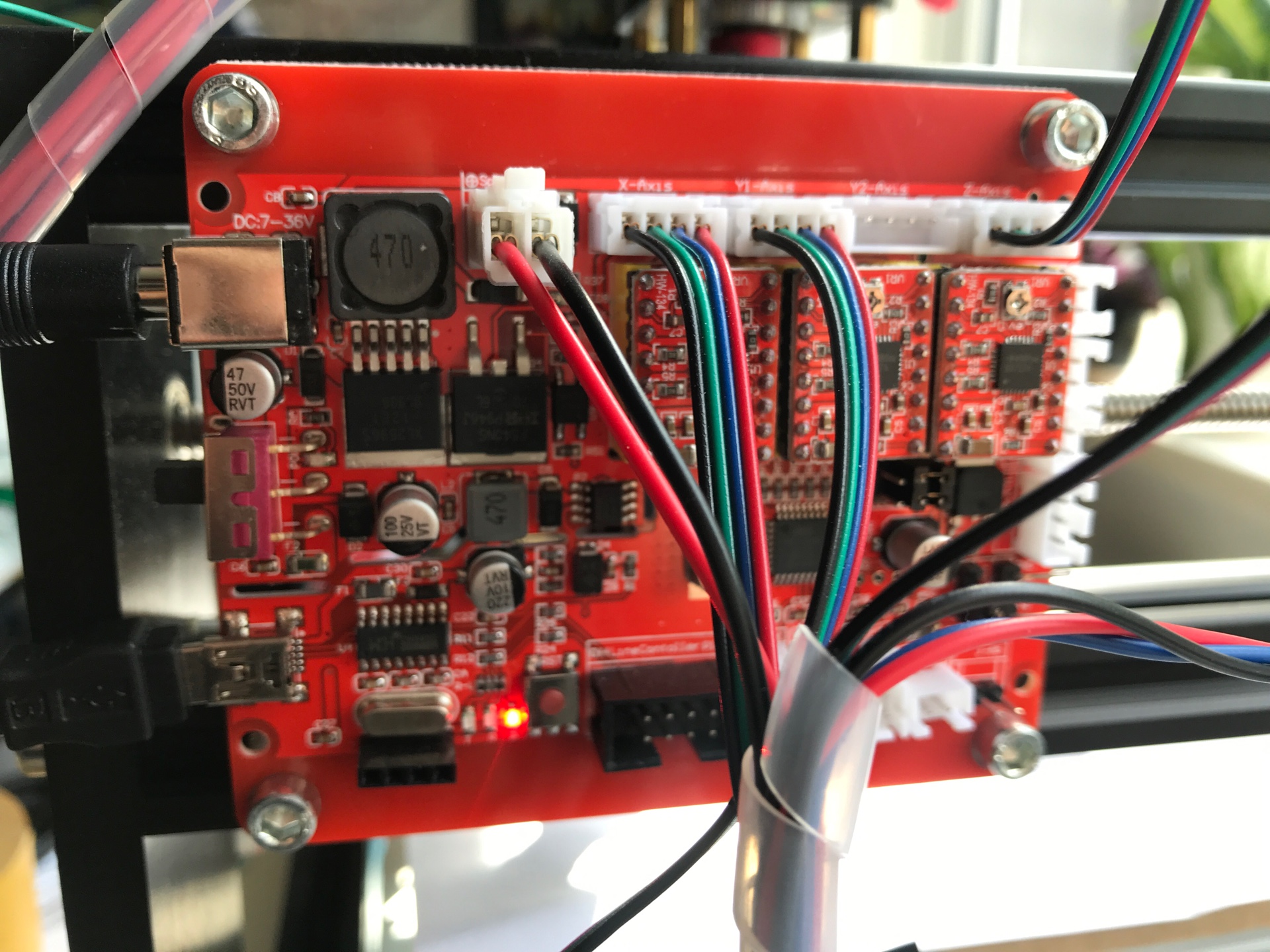

    Here's a couple of photos of the controller board, not sure what else would be helpful to provide.
    * Question 2: What behaviour should I expect when the switches are triggered? Is there a setting within GRBL so that instead of acting like an emergency stop, the spindle will retract back to a previous position? My assumption is yes, as that would seem likely to me for how a homing setup would work. So far I've just been moving the spindle manually from my G-code sender (UGS) - maybe it behaves differently during a proper cut?

    I can't open the link to Banggood - site down at this time (at least for me) at this time. However, I've found other RAMPS 1.4 limit switches with green/black/red wiring.
    STOP!, recheck your wiring.
    Green to +, black to -?, no, you provide the correct instruction - red to +, black to -, and green to 'S' (guess, "Switch" or "Sense"). What you have described with Green to + is that when you actuate the switch you're shorting the PSU to the RAMPS drivers. Chances are that's crowbarring the supply to the microcontroller and that's why the machine is losing comms with your PC.
    The limit switches on the control card should have 3 pins - get us a photo of that, or just review what you've done with the above in mind. I wouldn't power the machine until you've done that.

    I've attached photos showing the relevant part of the controller board.
    "Green to +, black to -" - yes, this is how I had it previously (and red to S). So it perhaps seems like a simple case of having put the plug on upside down onto the controller board?

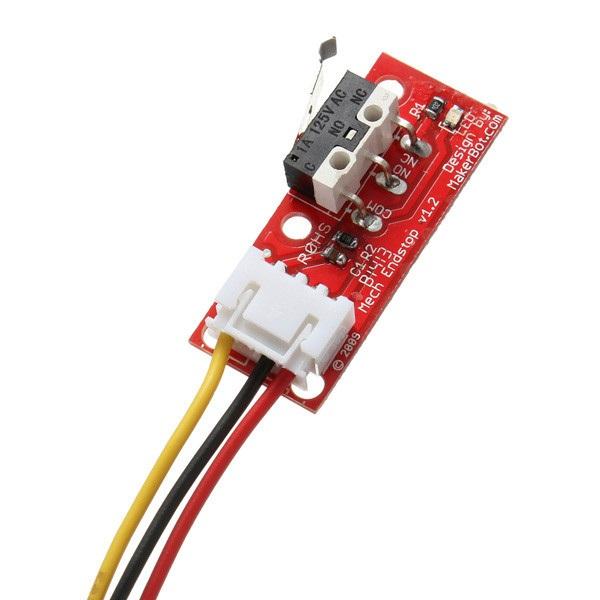

    This is the actual switch I have (though just to add to the confusion, it's shown there with yellow in place of green, black and red are shown correctly).

    Yeah, those connectors provided with the switches aren't polarised - Orientate them with red=+, black=-, green=S. Ironically the connectors on the controller are polarised (different connector) so blame the accountants for penny pinching.
    You shouldn't have damaged anything... much (perhaps lifed a microswitch or two), provided the PCB has survived.
