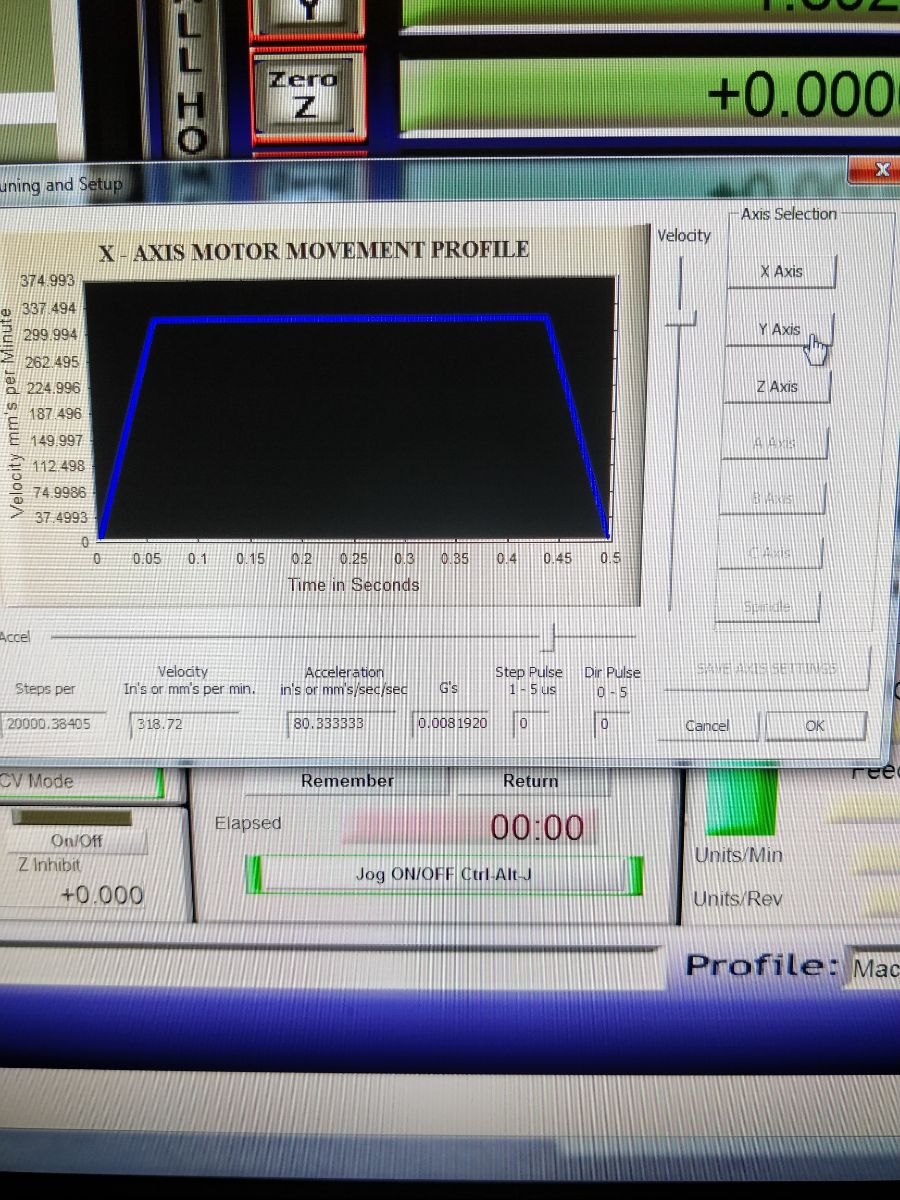

    I altered home and limits to the new settings that should be showing on the XML file and it now works. Problem is that if I alter the home speed above 3% the machine makes an awful noise and the gantry doesn't move. The noise is high pitched and changes depending on the home speed. It doesn't sound like when a stepper motor stalls.

    It also makes that noise when I press shift and jog but not when incremental jogging

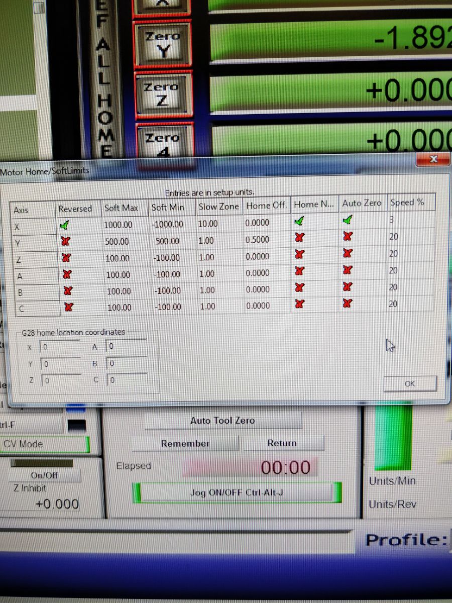

    Jazz and folks, here's a couple of pictures - home limit screen and motor tuning screen - if that's got anything to do with it.

    What units are you using Metric or imperial.?
    Email: [email protected]
    Web site: www.jazzcnc.co.uk
  12. The Following User Says Thank You to JAZZCNC For This Useful Post:
  13. #9
    metric
