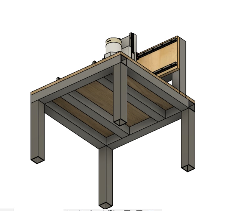

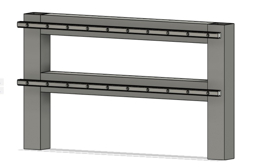

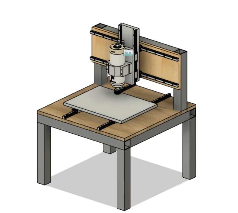

    Hi all,
    Just began purchasing my parts for my DIY router. I've currently got a K40 laser, 3D printer that I built and a Chinese 3040 CNC that I want to replace with my own build. I've got a 2.2kw watercooled spindle and here's some very early design drawings (the frame is 50x50x3mm mild steel), my work area is 400mmx300mmx150mm. I've lurked here for a few weeks and this place seems like a really friendly and knowledgeable place :)

    Hi eci22
    Welcome to the forum.
    First piece of advice is not to purchase any motors or power supplies, get your design finished and offer it up for critique from the forum members, need to know what you intend on machining and size of workpieces you will be working on.

    Hi Mike,
    Thank you. I have not purchased any of the motors or electronics and will only be getting them once the design is finalised and the frame has been built. I did go ahead and purchase the steel since amazon is selling 3m of 50x50x3 box for £23 delivered which seems like a bargain, the spindle I also pulled the trigger on since I've been watching them for a while and it fell to a good price before import tax and customs got me :/
    Welcome to the forum. You will indeed find plenty of wisdom collected here.
    I like the simplicity of your design. Others will comment on the face mounted rails but it does make for a simple Z-axis if you have limited tools available. I assume the brown stuff is not meant to look like plywood.
    Thanks Kitwn, I have started a separate thread regarding the rails here http://www.mycncuk.com/threads/13497...arings-designs
    The brown stuff is actually wood, specifically melamine MDF. I am thinking, at this early stage, as a way of leveling out the steel to mount the rails on MDF as it's 5x cheaper than Epoxy and in theory should be really flat though how flat remains to be seen- and I already have it around. If it does not work I will switch back to epoxy or something but I feel it may be an interesting experiment, will likely start a new thread for this at some point
    I'd suggest you brace the gantry because it will flex and resonate like a bell when cutting if you use a single piece of box section that tall.
    Thanks for the suggestion JAZZCNC, I didn't show the X axis well enough, it's two pieces of box steel that should help with resonance? Also definitely planning on adding some bracing

    Quote Originally Posted by eci22 View Post

    The design as you show it isn't strong enough for a gantry and it will flex/resonate. 50mm box section with 3mm wall is like spaghetti so you will really need to brace it good with nice high up triangulation.
