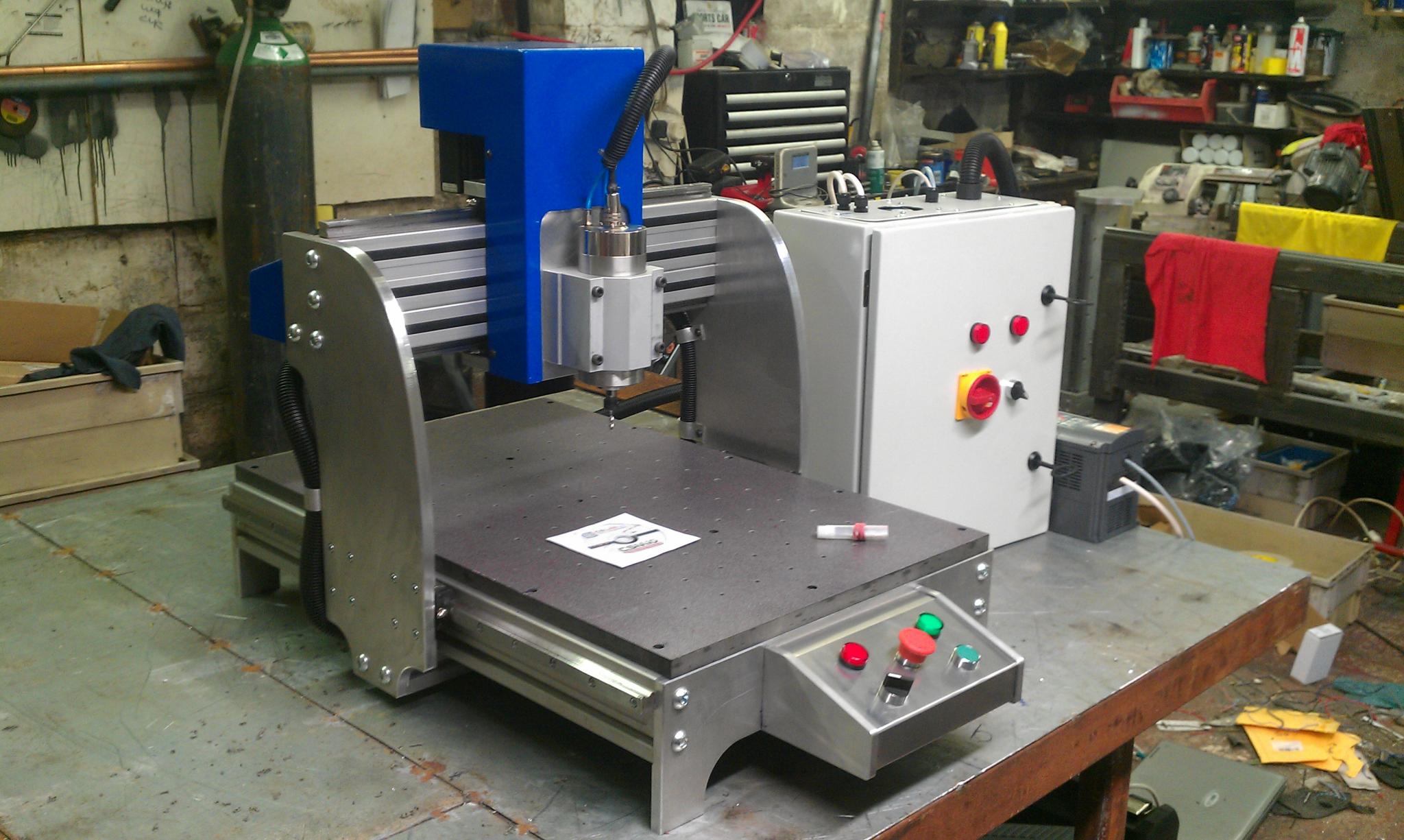

    Here's a 6040 sized machine and it easily cuts everything up to Aluminium. I've built several machines this size which cut everything from MDF to Carbon fibre parts for RC cars and Clocks which require fine tolerences so don't worry about it being upto the job.
    The best profile to use is 45 x 90 because it makes things easier with mounting ball-screws. However, 40 x 80 will work on smaller machine but you'll just need to make plates to mount BK/BF bearings on for ball-screws.

    That appears to be one short cut I won't be able to use as the supplier to have tenatively chosen does not supply 45 sized extrusion., only 40 and even that has to come from the other side of the country.....
    Some googling has found 1 or 2 suppliers that use 45 but the quality is unknown.
    I'll either have made adapter plates for each bearing block or mount the bearing in another way.
    Quote Originally Posted by Sterob View Post
    Look for Bosch Rexroth or equivalent BR style profile. 10mm slot
