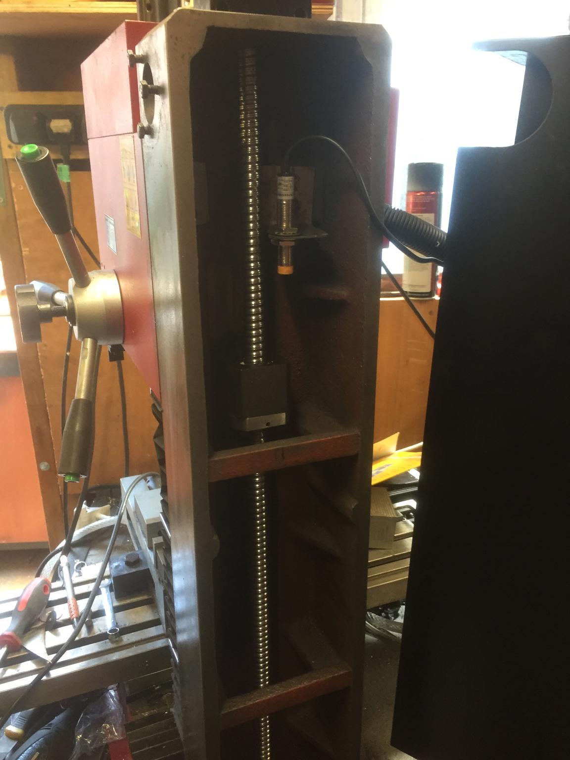

    Re. an earlier question, elsewhere, on the back panel on the Z column - have you checked the exploded diagrams on Arc's site (spare-parts)? It's admittedly not very clear (it doesn't include the two bolts that are there). This is one area I've modded on mine - there's only one bolt there now (had to cut part of the casing to fit the Z-axis motor mount). My machine is bolted to my bench and levelled - if you struggle to get the cover off I can unbolt to investigate but I expect it'd be easier to check yours?, feel free to ask if you do need me to take a proper look (I'll have to unmount some of the control boxes that are bolted to the column through holes I drilled and tapped into the column for this purpose). I can't remember any significant problems working on the Z column.
    This is a (poor) image of the back of mine when I had it in bits (with new ball screw/nut and a limit sensor)
    http://www.mycncuk.com/attachment.ph...9&d=1557694115

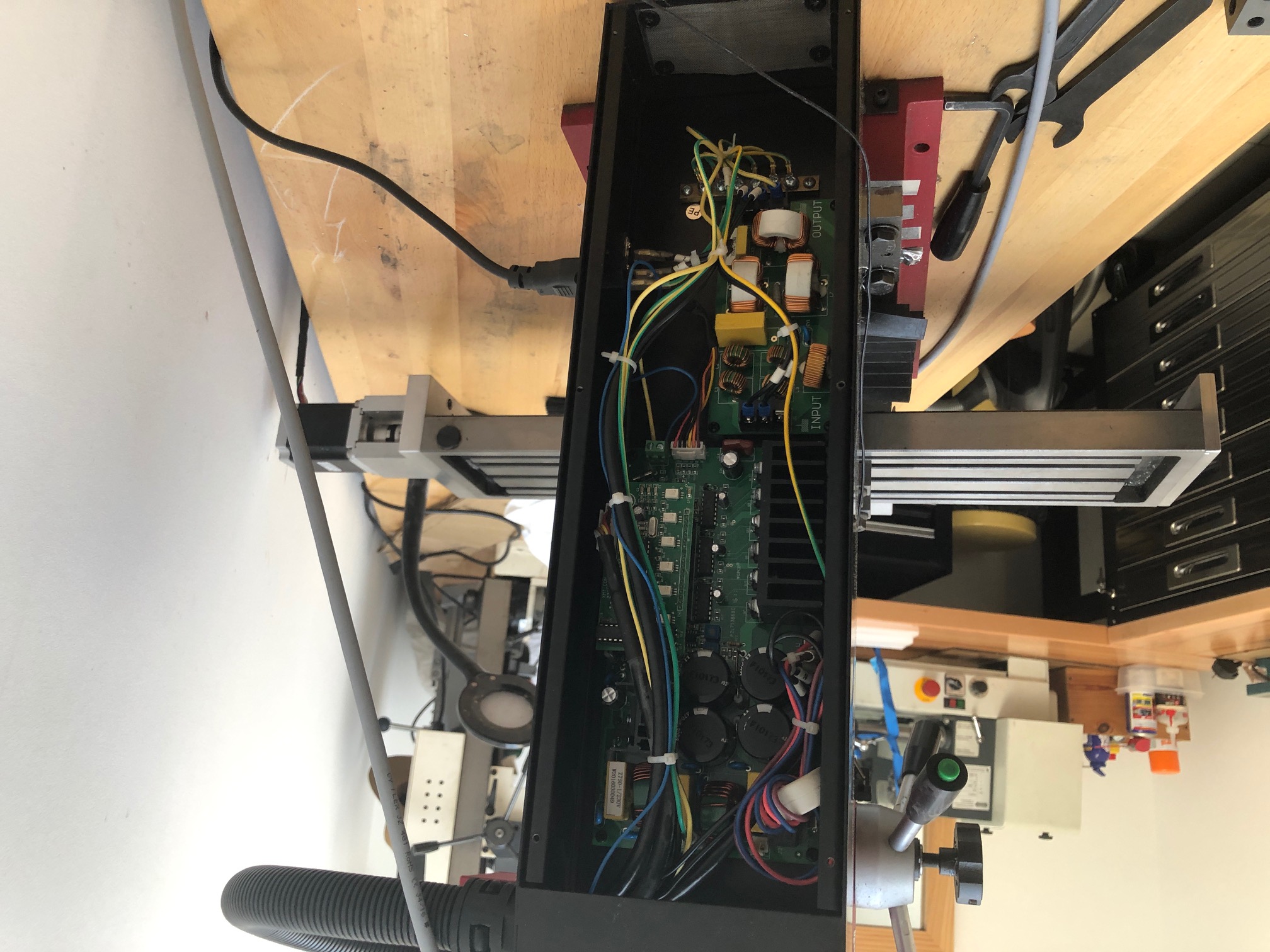

    Electronics with lids removed.

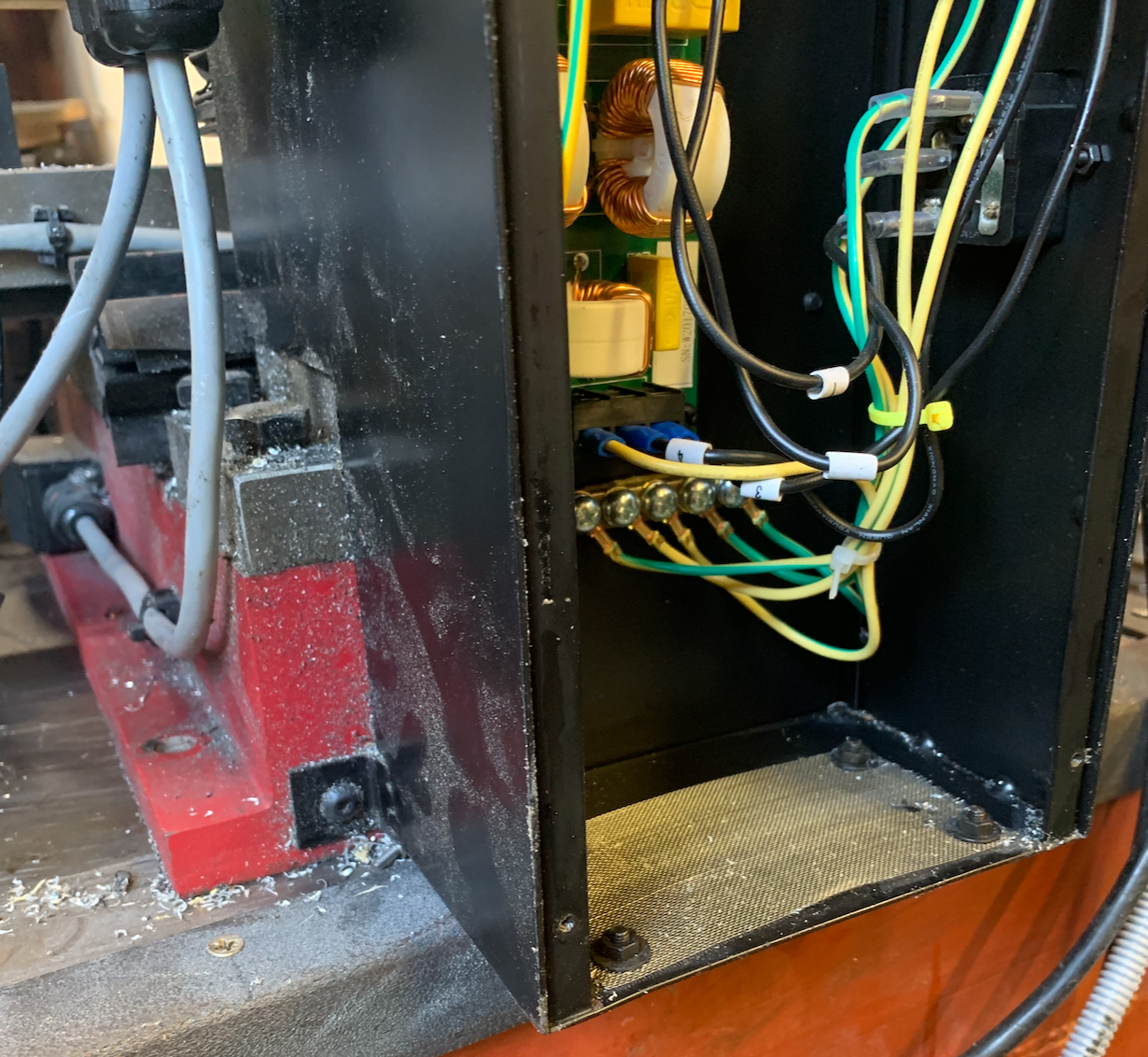

Name:	Screenshot 2020-03-24 at 08.20.33.png
    That's the base of the Z column - bolt on low left and low right. Don't take the bolts off the bottom plate - that's the filter mesh :)
    EDIT: OP - sorry, re-read your earlier post - and you've found the two bolts on the lower part of the column. I really can't recall any problem removing the shroud on the Z-column, but if you're working inside the packing case you're giving yourself problems. As you can see the column shroud contains all the electronics and cabling that will restrict movement/removal of the shroud - you really need to get the machine out of the crate to continue sensibly.
