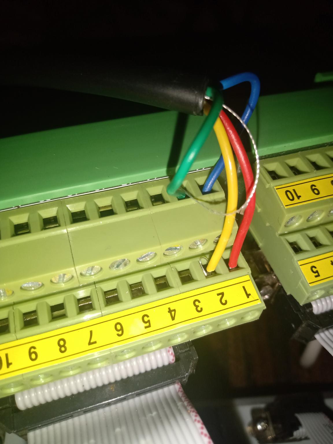

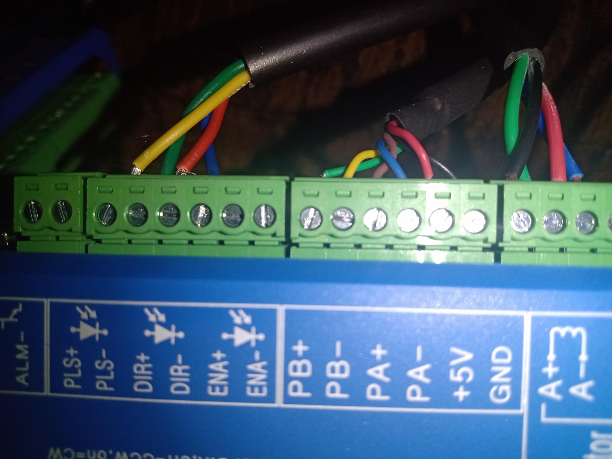

    I have some hybrid steppers not used them before and I'm struggling to get them to do anything,they have power and lock just don't respond to mach3, I presume I don't need the enable line
    I must be doing something wrong with the C's labs control or wired incorrect
    Any help once again would be great

    Have you selected the "Enabled" (green tick) in mach3 ports n pins - motor Outputs.? This is all you need to do in Motor Outputs, forget the Step/Dir and Port pin numbers etc they are not used, (except the active high if need to change the step edge which can get into later if needed )
    That's all you need to do for the motors to work. Then you just set the steps per and tune the velocity etc in motor tuning.
    Also, watch those straggling wires, if they short you'll blow the drives.!

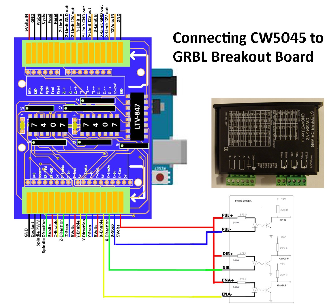

    Hi and first thanks for your help :)
    I have 4 drivers like this too, the enable pins aren't necessary?
    In my last setup with arduino i used this connection:
    And worked fine.

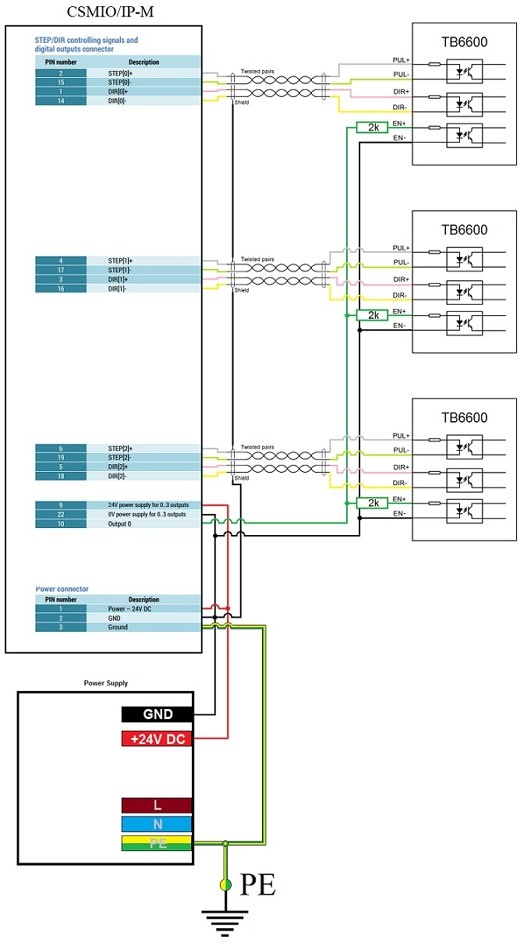

    With CSMIO and this drivers what recommendation are the better, doesn't use enable pins or this one i take from csmio web:
    Thanks for your time :)
