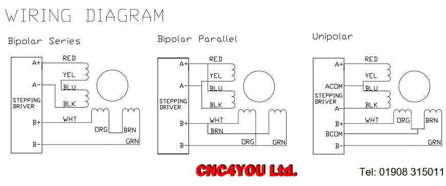

    Hi I have a pair of 4nm Nema 23's I want to swap on my bottom axis of the router, 4 core CY cable to run off a pair of AM882.
    Here's the wiring diagram
Name:	Nema 8 wire.png
    I want to wire for parallel, guessing 2 wires from the Nema connect to 1 wire in the CY cable but which ones lol?
    Could be any wire you want so long as you connect it to the right phase on the drive but here's what I would use.
    Wire # 1 = A+ = Red+Blu
    Wire #2 = A- = Yel + Blk
    Wire #3 = B+ = Wht + Brn
    Wire #4 = B- = Org + Grn

    The middle one. bypolar parallel

    Thanks Jazz, that worked perfectly luckily I twisted the pairs on these motors when I first fitted them so when I swapped the wiring it was super easy to work out the pairs. It worked first time and even both motors went the right way so bonus ;)
    I went from being able to move the dual motor axis at 4m/min to over 15m/min without firing fault protect on the AM882's, 20m/min worked but that screw looked scary lol so I dialed it back.
    25m/min and it fired fault protect had to try, 1610 ballscrews with cheap ass mounts but am going to buy a set of proper angular ones from BST.

    Are those the 4nm NEMA 23s from CNC4YOU with a 4.2 amp current limit? What have you got the AM882 set to?

    Yes they are, and now you ask lol I used the AM882 autotune function on the last motors I just replaced not actually "Autotuned" the new motors so they aren't even close to set up correctly.
    Last motors were only 1.8nm so must be out and I did a cut for 30 mins and the motors were cool to touch, need to tune them in to get best performance but motors are stronger than machine lol.
    I only built the machine out of 4590 heavy duty extrusion it's not steel.

    Your asking for trouble running at the drives Max voltage. You will damage them at some point if your running at high feeds and happen to catch the mains at a peak the back EMF will fry them.!
    DDCSV 2.1 I have microsteps set to only 2 at the moment the minimum the AM882's will let you set them from the jumpers.
    They will run like a grumpy bear at 2 x turn them up to 8x and they will run much smoother, you'll lose a little torque but will run much nicer.

    Andy, just want to clear something up just in case you or others think the drives current rating is a must not exceed the limit or will break.! . . . They are not limited to 4.2a you can actually run them higher and you won't damage them. It's not recommended because you will over time shorten their life because they will run hotter and the gains will be limited so not worth doing. But you won't kill them running a little higher current.
