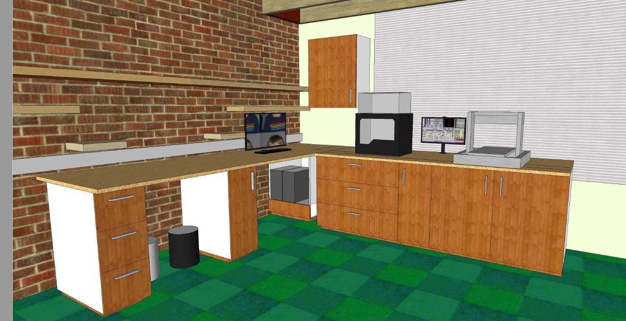

    Does Mach3 disable limits when homing, or is this an option?
    I am not able to look at my machine as it is currently on the floor in my office, which I am refurbing.
    Looking back through threads (to 2016), I sort-of answered this question, but left doubt. I use a NO inductive switch for homing, but a NC microswitch for limits and I just thought that a break in the homing circuit could cause a crash if the limit is deactivated.

    Wow, using CAD to plan your workshop refurb!

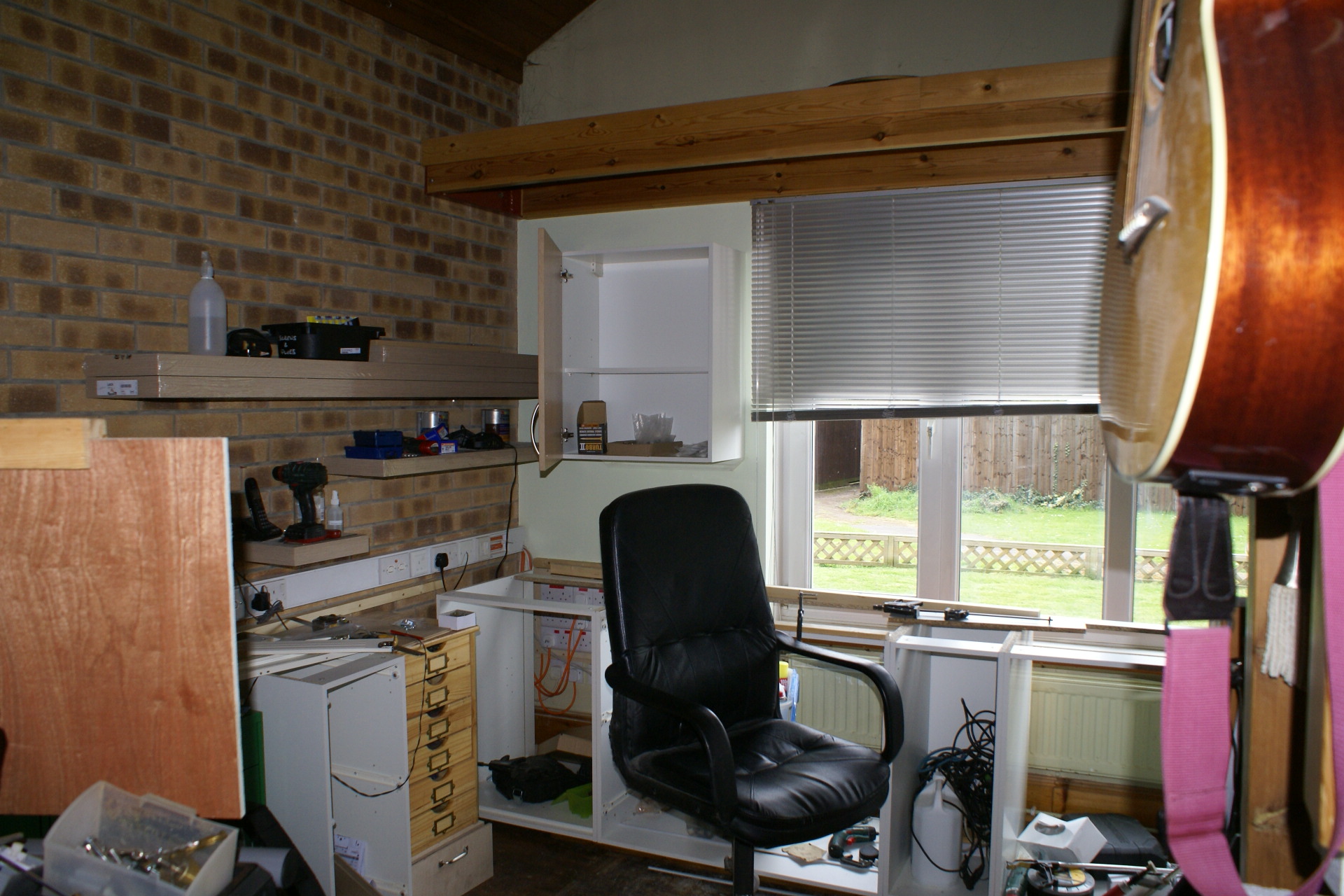

  8. #28
    Notice that Mach3 is already loaded
    Thankfully, I had all the cabinets and worktop (25mm moisture proof MDF, 800mm deep) delivered before lockdown. All the carcases are built and in position. Next job is the worktops, and they are heavy sheets.
    Anyway, My question is about homing and limits and I cannot find any reference to the query in the Mach3 reference manuals.
