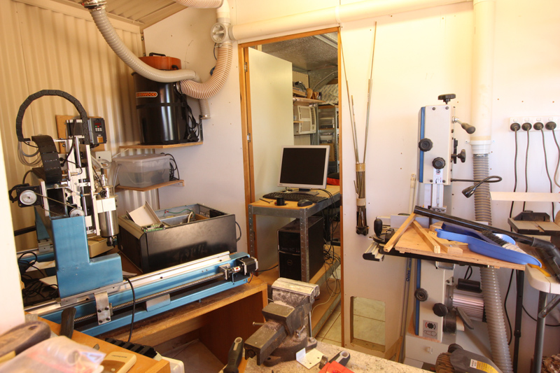

    I've still got some investigation I want to do. The controller is connected to the machine by screened multicore cables which have plugs on the end which fit into sockets on the machine itself. The two X axis sensors and the Z&Y sensors have one 8-way for each pair. I want to disconnect the cables and see if that makes a difference. This will help to decide if the noise is being picked up in the wiring within the machine itself where the Z and Y sensor cables run through the same drag chain as the motor wiring or whether the problem is within the controller itself. Both will be dealt with anyway but knowledge is never wasted. I'm also tempted to use the technique I learned from the video that Cube3 linked to to look at the noise on the motor cables with my laptop oscilloscope. But 6MHz???
    While I wait for RS to deliver the bits required I'm doing some necessary tidying up. There isn't much room in my workshop with the machine itself pulled off the wall to get at all the wiring (note for new builders: If you have to put your machine up against a wall, do NOT put the drag chains and all the gantry wiring on the 'wall' side of the machine in order to keep it conveniently out of the way). The only place to put the trolley with the PC on is in the doorway to the rest of the shed (sorry, that should be 'studio' if my wife is listening) if I want to leave it all connected so the picture below had to be taken through the window!
