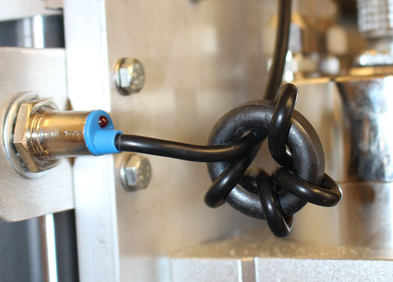

    I get noise when my stepper motors enable. It affects my FM radio.
    Now.. I have no switches and all circuits etc in a metal control box. The noise is from my estop (un-screened cable in use).

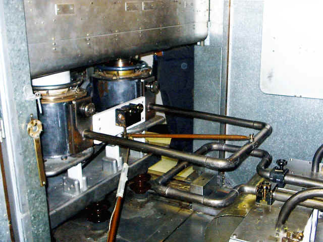

    The weirdest things can happen with EMC issues, at 6Mz a couple of bits of wire running parallel for a few m probably makes a half decent transformer
    This picture shows the output coupling transformer of a Marconi BD272 AM short wave radio transmitter rated at 250KW (that's a whole Megawatt peak output). I cut my teeth on these things in the 80's. All that power is being coupled through this single turn, air spaced transformer. These are the coils for 15MHz I think, but the 6MHz ones are not much bigger. The peak voltage across the primary turn is about 40KV even though it looks remarkably like a short circuit to the uninitiated.

    Thanks for posting that - awesome bit of kit even if it looks completely illogical to the uninitiated!

    This machine is 1960's technology. Some of the later, higher power designs, have water cooled the coils. A key difficulty with those was how to clamp the plastic water pipes onto the copper coils. Metal jubilee clips glowed white hot as soon as we switched the bloody thing on and plastic clips went brittle in about a week. We ended up using waxed cotton whipping cord, similar to to an old fashioned cricket bat handle. It's surprising the skills I had to learn as a BBC Transmitter Engineer back in the days when it was still fun.
    Have a look at that video Cube3 posted on page 1. Ferrite rings should help you there. You can wind the cable through the ring to increase it's effect.
