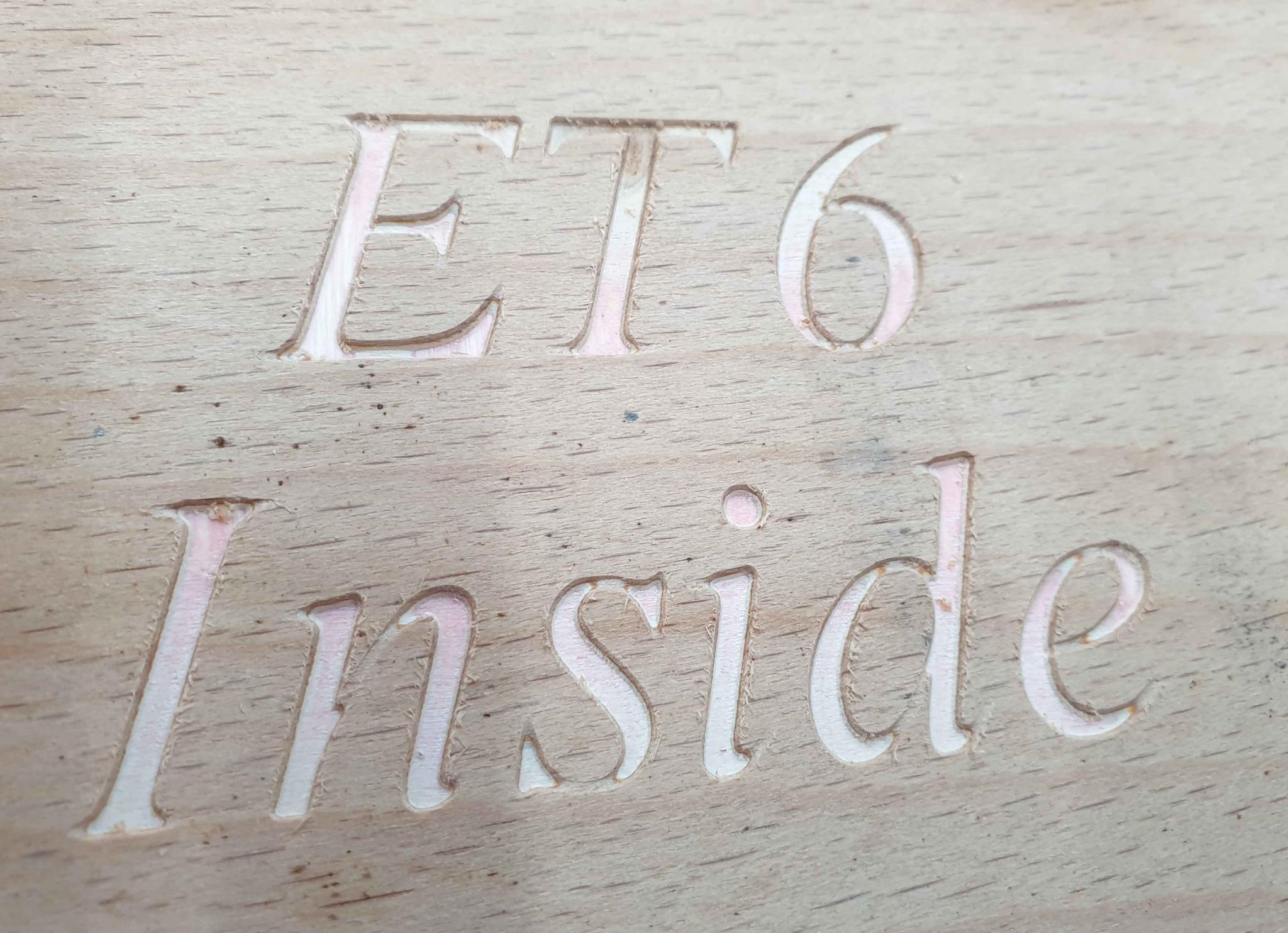

    At that point, I couldn't think of any more good reasons not to cut something, so I downloaded the myCNC postprocessor for Vectric (there's one for Fusion 360 plus a couple of other CAM packages that I don't use) and created a quick bit of Vcarve engraving. I just used a bit of scrap ply that was lying around but here's evidence that it's working! Well, I could be faking it but trust me, I'm a doctor!
Name:	et6 inside.jpg
    Image is slightly distorted but that's just camera angle.
    Might take a little rest now before starting out on the tool height macros.
