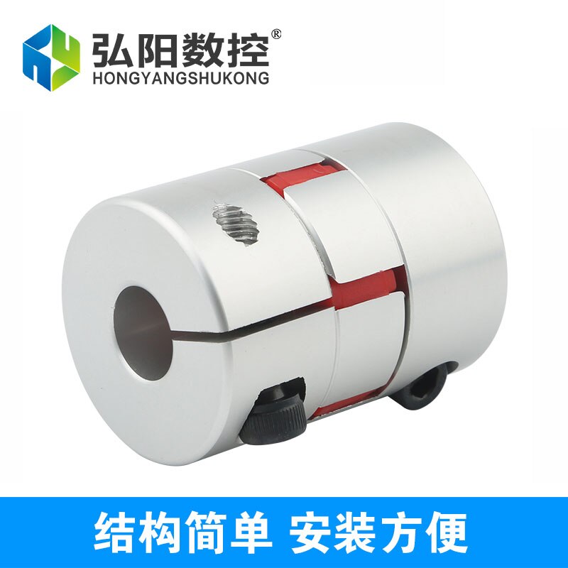

    AM882 has fault protection it should detect missing steps and estop and I swapped all the couplings for these style, I bought the chunkier ones.

    so they're rated twice the nm of the motors.
    2 4nm in the bottom and 3nm on the gantry, PSU is 70v and 1kva.

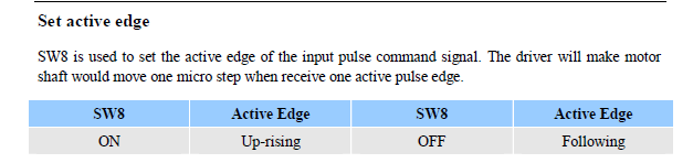

    What should the rising edge be set to?
    I have it set to uprising at moment
    It depends on the controller and whether it looks at the rising or falling edge.
    However it's easy to test. Just write some G-code that moves back n forth few hundred short moves, say 10mm, then back to zero. If you have the wrong edge set it will lose a step for every direction change and it won't return to zero. Do this for each axis separately.
