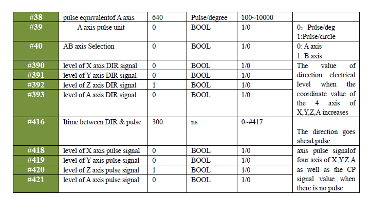

    In the manual there's "Level of Axis pulse signal" what does this mean? Is that the rising/falling edge?

    This will be the pulse timing and I wouldn't mess with it if your not missing steps or losing position.
    The fact your parts are the wrong size will be down to either a mechanical issue or simply because the pitch doesn't correspond to the steps per setting. The best way is to command a move and accurately measure the distance it moved. And when I say accurately then a tape measure or even a steel rule isn't accurate enough. For instance, I use linear scales with a DRO to compare actual distanced moved to the commanded. I then adjust the steps per until they match.

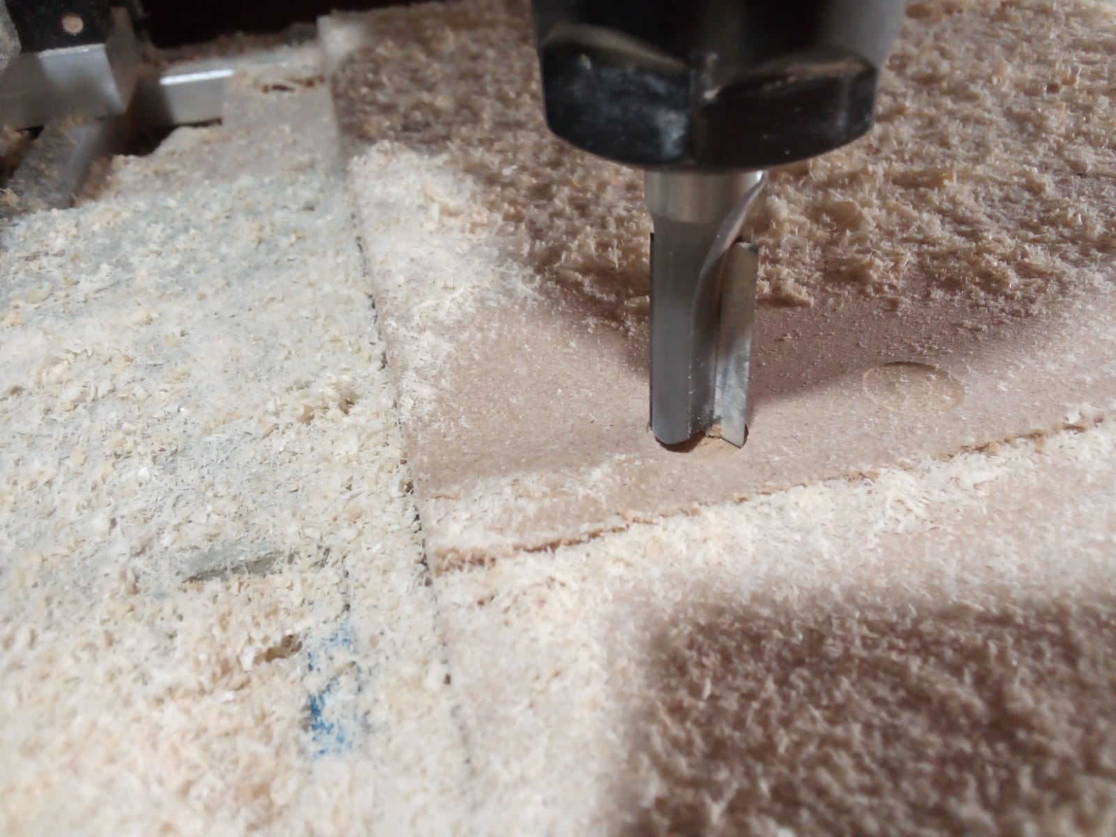

    This was after 1000 moves left then 1000 moves right and the same on the other axis.
    so 4000 moves in total.
    The indent was put at G54 0,0 before I ran the code.
    Guessing it would be visibly out if I had the rising edge set wrong.Click image for larger version.

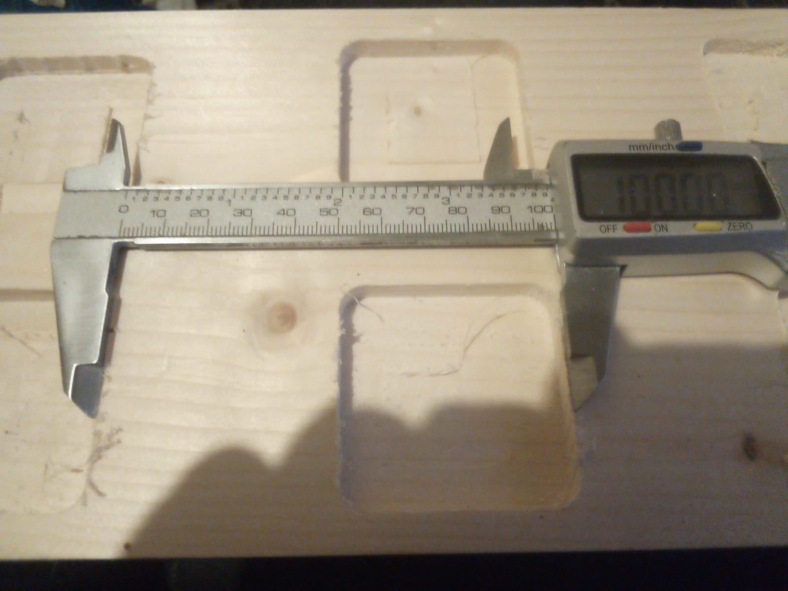

    I cut 11 indents they are all out by the same amount ~1mm but the distance between the indents is correct.
    So the indent is 49mm and the distance between indents is 51mm. They should be 50mm each.
    Over the 11 indents the distance is correct.
    Set up 1/2" end mill (Brand new trend bit), pocket no stock to leave.
    The top row the clamps weren't tight enough and slipped so cut the bottom row but properly clamped.
    I looked through the DDCSV's settings and every tool offset was set to 0.0

    ...so the errors are not incremental - so I interpret that as the motor steps, scaling etc are all correct
    "Indent is 49mm and the distance between indents is 51mm. They should be 50mm each" - I interpret that that the pockets are undersized?
    Post your Gcode output from Fusion. At least for the first two pockets.

    Pockets are undersized, here's the code for 1 pocket 50mm in Fusion 360 I had to rename it to .nc to upload from .tap.
    my controller is steps per mm
    Microsteps are 8, 1610 ballscrew
    8*200/10== 160
    I have 1605 on Z so 320
    1:1 direct coupling.
    Attached Files Attached Files
  15. #10
    Well a quick look shows that it should cut a 50mm pocket. The last move is at 43.65 and the tool 12.7mm so should hit 50mm provided the tool really is 12.7mm
