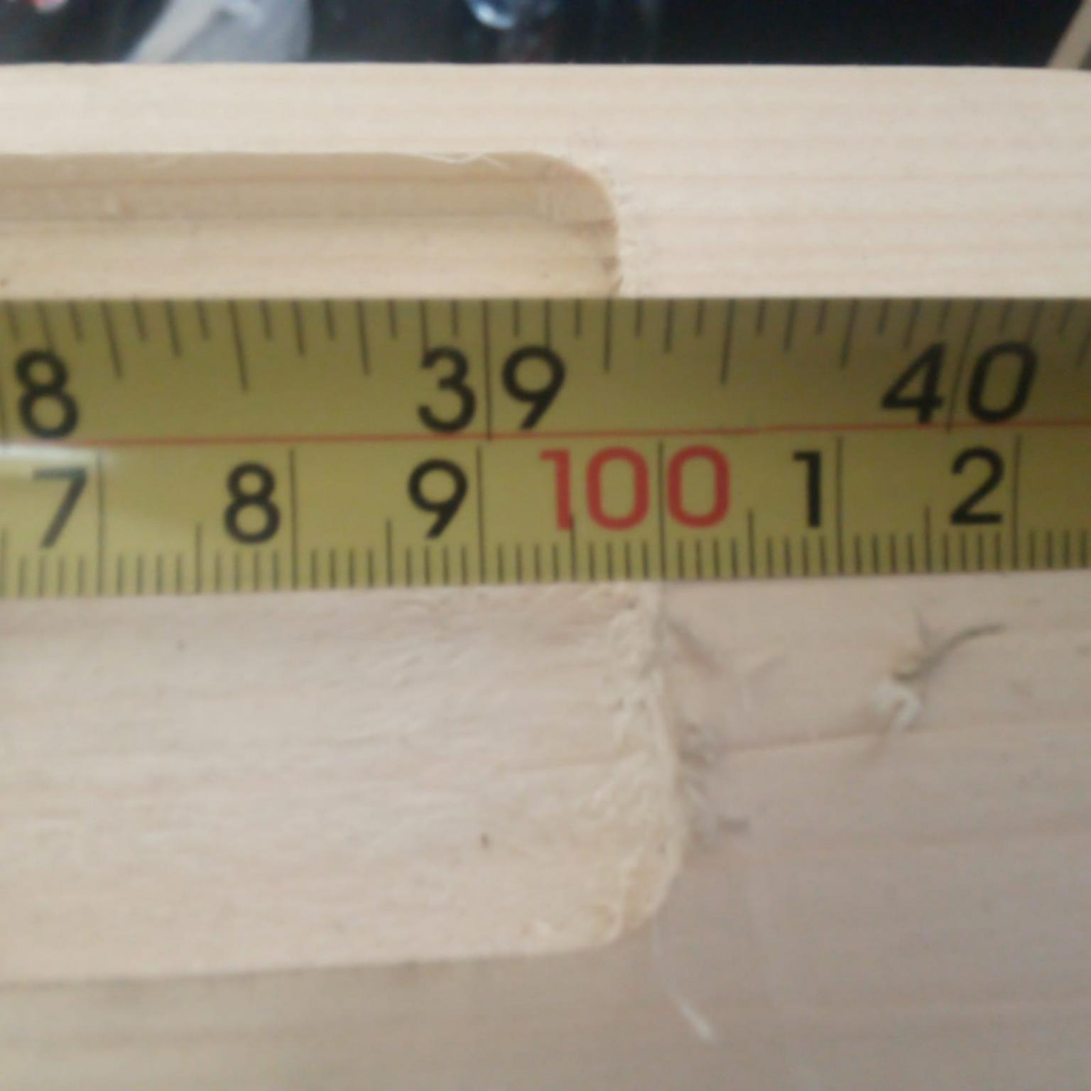

    Have you tried with a different vernier caliper or always the same one?
  7. The Following User Says Thank You to phill05 For This Useful Post:
  8. #35
    Quote Originally Posted by phill05 View Post
    Always the same one but you can see a mm on a ruler which I also tried, the bit is a 1/2" trend router bit, and it's in a 1/2" collet so I think my calipers aren't the issue here.
    The pocket even using measuring tape I can see are 1mm undersized.
    BUT this gap is meant to be 100cm so the only thing I can think off is the controller is offsetting the tool.

  9. #36
    This is a wild shot but suppose must be asked.! . . .You have trammed the spindle haven't you.? Does the bottom of the pocket measure same as the top.?

    Have you measured your backlash? You need to check backlash.

    A couple of experiments for you to try.
    *** CAUTION: Hand coded G-Code and un-tested. Sit next to your E-Stop!!! ***
    test2.nc
    This should slowly rock the X-axis by 0.5mm (or 18 degrees on a 1610 screw) - wrap a bit of tape around the x-axis screw with a visible tail and run this g-code through the controller and observe the tape. The G-code has got a feed rate of 10mm/min so my poor maths suggests around 3 seconds to go 0.5mm (18 degrees) and 3 seconds to go back to 0 (0 degrees). It repeats... a few times. No spindle and no z-movement.
    This is just to verify that there's no backlash compensation active erroneously or not in the controller. You'll have to eyeball the 18 degrees rotation on the screw/tape.
    Remove tape.
    test.nc
    This one cuts two pocket outlines - with your 12.7mm milling bit, starts at (0,0) and cuts a 3-tooth comb with a positive displacement on X, 50mm between teeth. After the 3rd tooth it reverses and cuts another 2 teeth offset in Y 30mm back the other way also 50mm apart. This to verify again that there's no backlash effects or compensation in operation.
    Sorry, that's all I can think of at the moment.
