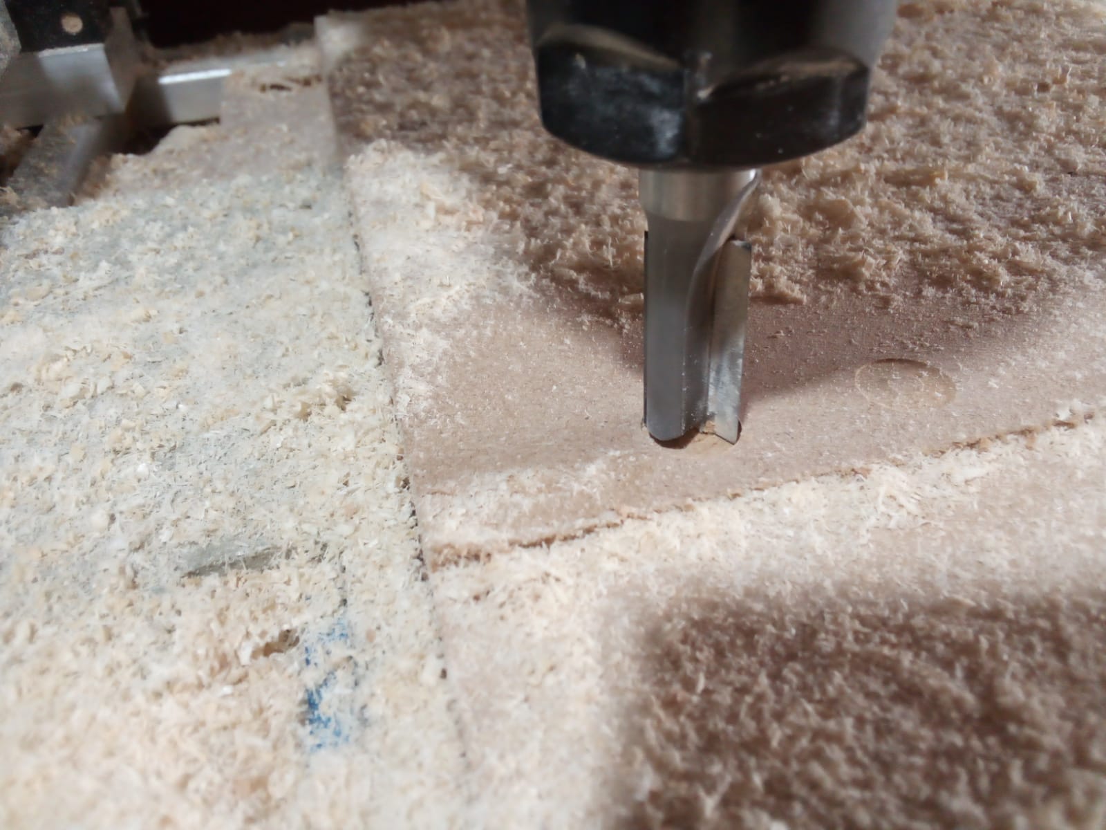

    This was after 1000 moves left then 1000 moves right and the same on the other axis.
    so 4000 moves in total.
    The indent was put at G54 0,0 before I ran the code.
    Guessing it would be visibly out if I had the rising edge set wrong.Click image for larger version.

    Well, that is pretty much what you are doing so you can say you are not losing steps. However, if you search the forum Jonathan posted an Excel file that will produce G-code to run the machine around then return to Zero.

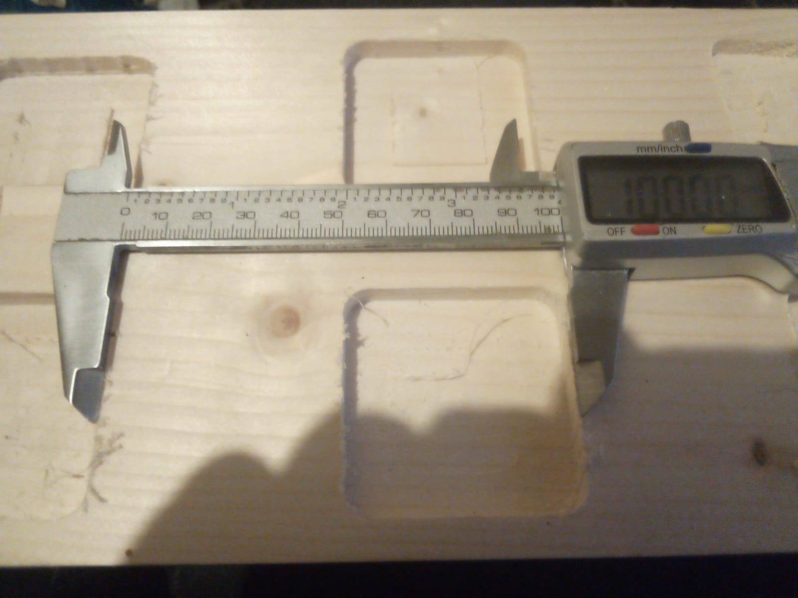

    I cut 11 indents they are all out by the same amount ~1mm but the distance between the indents is correct.

    So the indent is 49mm and the distance between indents is 51mm. They should be 50mm each.
    Over the 11 indents the distance is correct.
    Set up 1/2" end mill (Brand new trend bit), pocket no stock to leave.
    The top row the clamps weren't tight enough and slipped so cut the bottom row but properly clamped.

    ...so the errors are not incremental - so I interpret that as the motor steps, scaling etc are all correct
    "Indent is 49mm and the distance between indents is 51mm. They should be 50mm each" - I interpret that that the pockets are undersized?
    Post your Gcode output from Fusion. At least for the first two pockets.
    Pockets are undersized, here's the code for 1 pocket 50mm in Fusion 360 I had to rename it to .nc to upload from .tap.
    my controller is steps per mm
    Microsteps are 8, 1610 ballscrew
    8*200/10== 160
    I have 1605 on Z so 320
    1:1 direct coupling.
