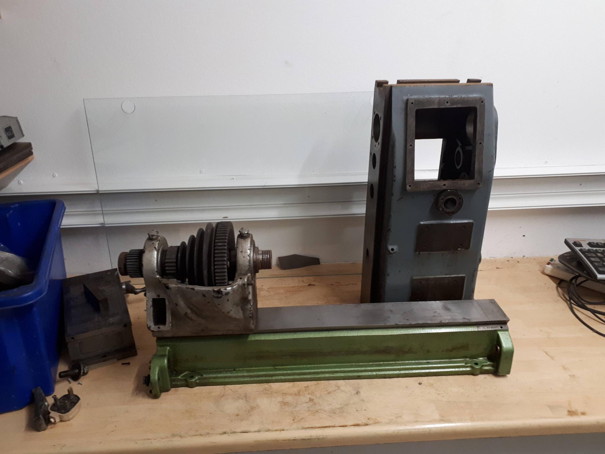

    Jazz, it's a small horizontal mill column, which would normally have a gearbox in the 'window'.
    Thanks, I've since found a pic.
