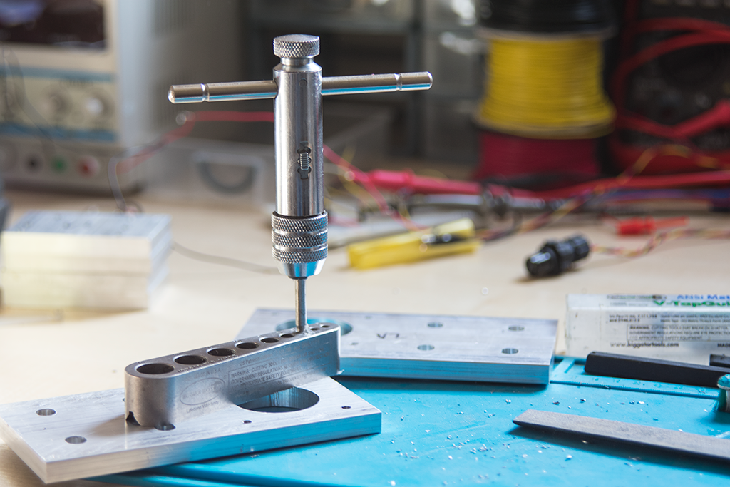

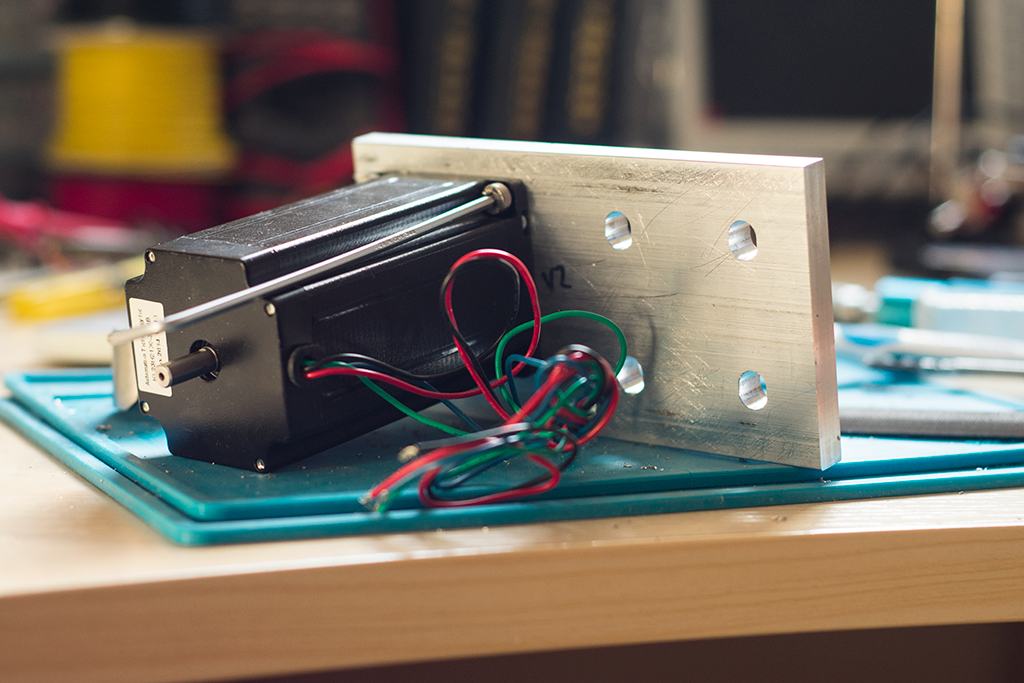

    After getting no response from the laser cutting service on quotes I decided to have a route around in my stock and found some appropriate stock to mill some of the new parts myself.
    Yesterday I went ahead and milled two new motor brackets with spacing to suit the new Y ballscrews. Material is 6082 Aluminium which machines rather nicely with a single flute carbide end mill, I just have to slow things down a lot on my Momus CNC and use small diameter cutters as the Z axis is prone to flex.
    I can still achieve pretty accurate results though, it just takes time. I can't wait to have a stronger machine that can make use of adaptive tool-paths.

    I hand tapped threads with the aid of my tapping guide, I've had some bad luck in the past with using the battery drill for tapping and since it's so difficult to find materials at the moment I was happy to take my time to avoid any broken taps/ruined parts.

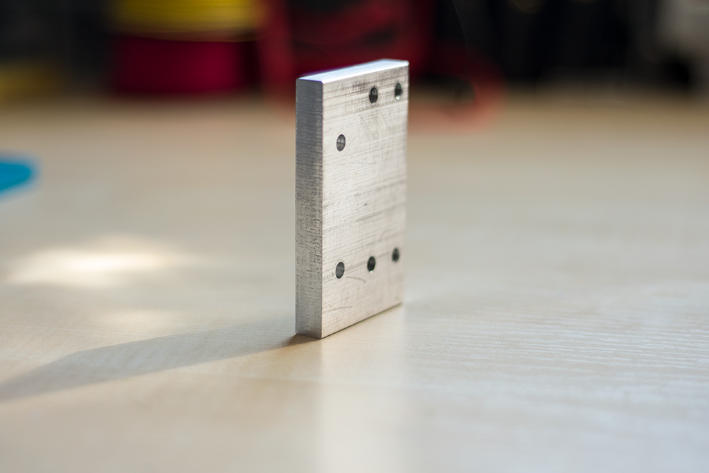

    Whilst I was at it I milled four new feet, which connect the Ball-screws to the profile. Stock is 10mm thick and is set up so I can align the side of the BK15 holder to the top of the profile. These are tapped with M6 thread in four locations for the BK15 to bolt to with 45mm socket head bolts. There are then two 5mm fixing points for fixing to the profile. I may hide some countersink bolts under the BK15's too, for now it's fine.

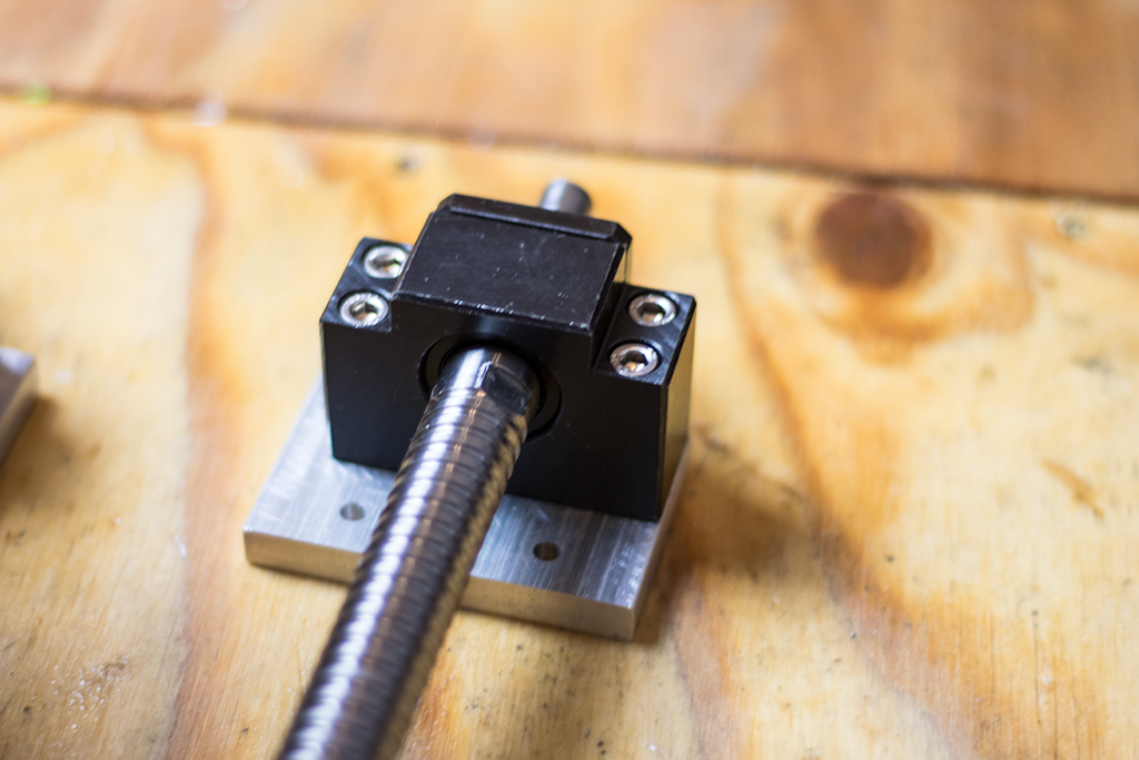

    I went ahead and ordered two ball-nut carriers from a custom CNC bureau service, so I can keep moving on this. They should be here in a week or so I think.

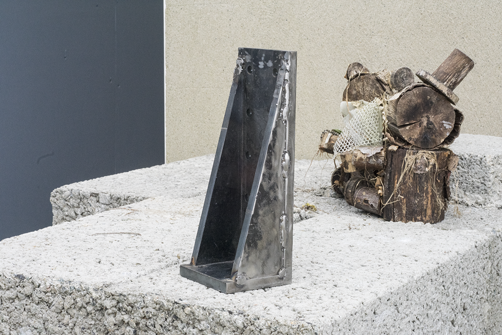

    So, Friday I managed to get some new laser cut steel through the post from a crowd in the UK.
    These parts will replace the current steel brackets which connect gantry on both sides to the ball nut holders. I used this as an opportunity to try welding for the first time. Please don't hammer me on the welding, I know it's shocking but this was my fist go at it and I've learnt a few things. One my 100A mig isn't nearly powerful enough for material this thick and, two; buying cheap gasless flux cored wire is a big mistake. If anyone is interested the Super 6 flux cored mig wire is something to avoid for a beginner at least. It creates plumes of black smoke, spatters like crazy (yep polarity is correct) and doesn't pool up very-well. If were to run the MIG again, I'd probably look to get some lincoln gasless flux cored wire, it seems to be well reviewed. Seems a bit pointless for this project, in future I'll be sticking to trying to learn a bit of ARC welding as I'm mostly interesting in sticking thick pieces metal together.
    Essentially I've built two of these and each is just tacked at this point and I intend to grind this mess back and get up to speed with the arc and come back to it. It does seem to be fairly strong though. Importantly it is square and key surfaces are flat so it a definite improvement on the last version a local company made, which were neither flat nor square (but welded better for sure). I'll be able to move along with the other bits when they arrive.
    Custom ballscrew nut mounts are on the way, then we can mount and test these new ballscrews!
    One I can confirm that everything lines up the way it should, I can use the steel from the old ballscrew mounts to practice some arc welding before coming back to these. At the moment getting steel is tricky. I intentionally didn't weld on the inside so I can tackle that later, after some practice.

  3. #33
    I'd be very happy with that as a first welding attempt - nice one! But yeah MIG isn't going to be best for that material size - I'd be surprised if it has enough penetration.
    What's the phrase? Grinder and paint make me the welder I ain't.
  4. The Following User Says Thank You to AndyUK For This Useful Post:
  5. #34
    Thanks Andy! it seems to be strong enough but I'd guess it's penetrated around 1-2mm into the base metal, or so (looking at the front corners). I can pass over the inside with the ARC once I get the hang of it too so I'm not too worried at the minute, I was more nervous to stuff up the alignment to be honest but it's bang on where it needs to be.
    I've been playing around with the ARC a moment ago on some scrap. I like it much more than MIG as a process so far, at least I can get a good pool going with it. Enjoying that a lot.

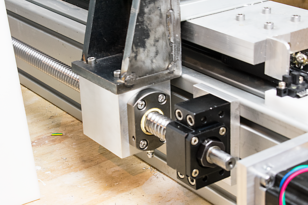

    This morning two custom ballscrew nut mounts arrived from the CNC service, they came out really well so I followed on to test fit these and the newly welded (ahem) brackets. Click image for larger version.
    With a little to and fro to swap parts out I'm glad to say it all fits as well as I can expect, and boy does the thing feel much more solid now.
    I had to massage the brackets a little on the corner to give some wiggle room by adding chamfer the corner of the L to give a millimeter or two clearance.
    I'm now just awaiting the new anti-backlash couplers to mate the motors to the new screws and this part should be done. It's been a bit of extra work, but so far I can feel the improvement and I'm glad that I took it on.
    If everything goes smoothly then I'll be removing these steel brackets and adding some more internal welds just to beef them up a little before painting them black and refitting. I'll need to start designing the table soon, I may be back to get some advise from you all when I get around to that part.
    Mig is more than capable of welding that material, but 100A isn't. It would need 250-300A and thick wire. The trick with Mig is setting the wire feed correctly.
    Also when your butting 2 pieces like you have if you grind a chamfer on each edge where you want the welds it will give you a stronger weld as you have larger weld area, it also gives you a flatter weld with hardly any grinding required.
  11. #38
    Hey, yes sorry I was referring to my MIG in particular, I'm sure with more current it would work absolutely fine. Ten four on the chamfering, I'll keep that in mind for future.
