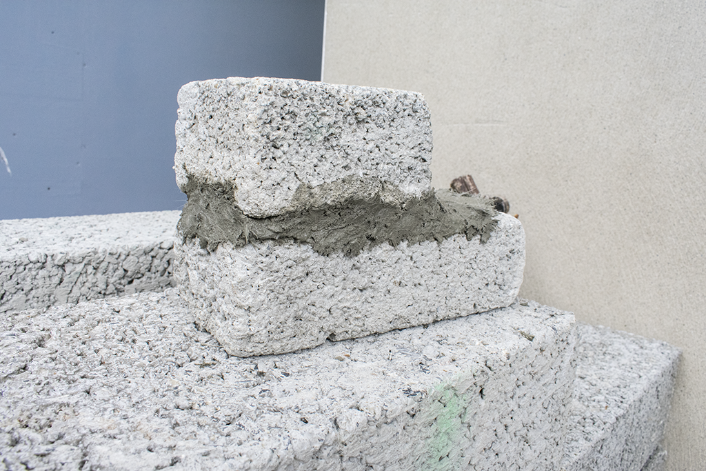

    I used some small 'soap bar' bricks which are almost identical in nature to the larger versions to test it out, at the moment I'm mainly concerned with bonding strength if I use it as a mortar between the blocks. If it fails to bond, I plan to make another custom mortar mix using standard mortar mix with sand, cement lime and mortar plasticiser with some added glass fiber reinforcement to beef it up as I know that will stick well to the blocks.
    One thing I've noted is that the mixture consistency becomes noticeably more 'dry' when adding the Glass Fiber, so I'll have to balance that out. Also the working time is short, around 20 minutes, so I'm going to have to be on the ball when doing this but I have a cement mixer so it should be doable.
    The mixture is curing very fast, so in a day or two I should have an idea how the bonding is.

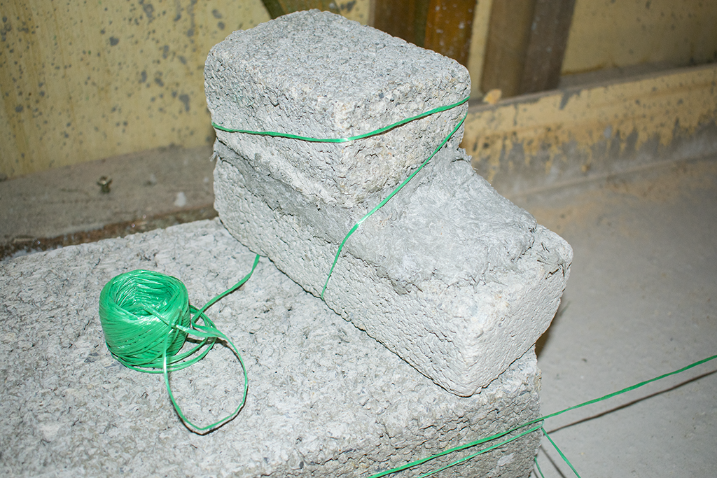

    After letting the GRFC mortar test cure for a week in situ in my workshop I inspected it for bonding, the very scientific method of slapping it with a hammer was employed. I was mostly concerned initially with whether it would bond significantly to each brick but I'm confident now that it will be perfectly fine in that regard. It's clearly much stronger than regular mortar and I'd expect it to shrink less and be stronger in compression. That's good enough for me to move on.
    One thing I realised after purchasing the glass fibre and mixing up this test is that AR glass fibre is recommended as it is suitable for the extreme environment of usage in concrete (general E glass is not as it is attacked by the alkalinity). After reviewing the technical documents from the supplier though it seems that this isn't a major issue for me, luckily. The glass fibre I have purchased, whilst not AR glass, the type I have (E6-CR from Jushi Tech http://en.jushi.com/res/excel88fcd3bf87268a79.pdf) is tested and recommended in both high acid and highly alkaline situations so it should be fine. I note it here for others though, be careful, glass fibre is not all suitable here and go for something that is specified for concrete usage.
    Here's a picture of the GFRC mortared test, being reused as a weight. This mortar is tough stuff. I'd like to do some more scientific tests before casting the main bed, I'll get the walls up firstly.

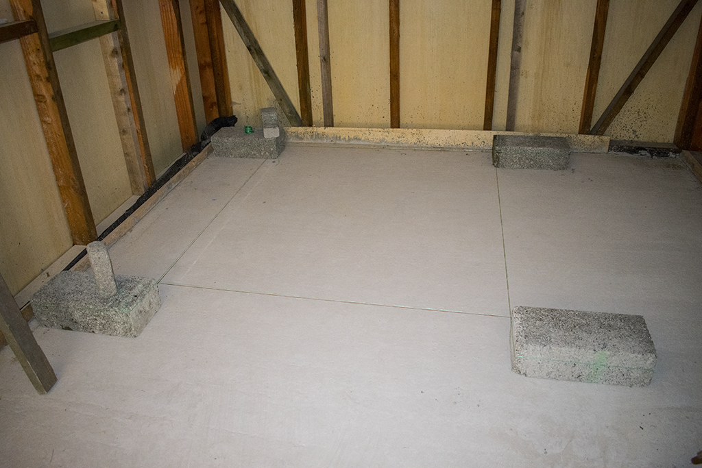

    I'm pretty slammed at work but had some time to layout the basic structural outline on my newly concreted floor. Nothing too complex, four bricks, some string and some careful corner to corner measurements to make sure it was square. One of the issues I was having with the concrete floor was it was endlessly dusty, no matter how much it was swept it kept producing more and more dust. I treated it once with a PVA based sealer and water and this has cut this down. I will aim to treat it once more before moving on with the block work next week. This should also help ease my mind around bonding to the floor, I was more than a little concerned that it wouldn't bond correctly due to the dust but I'm told this is a commonly used solution to aid bonding.
