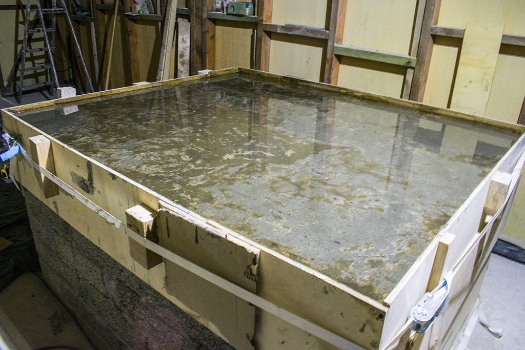

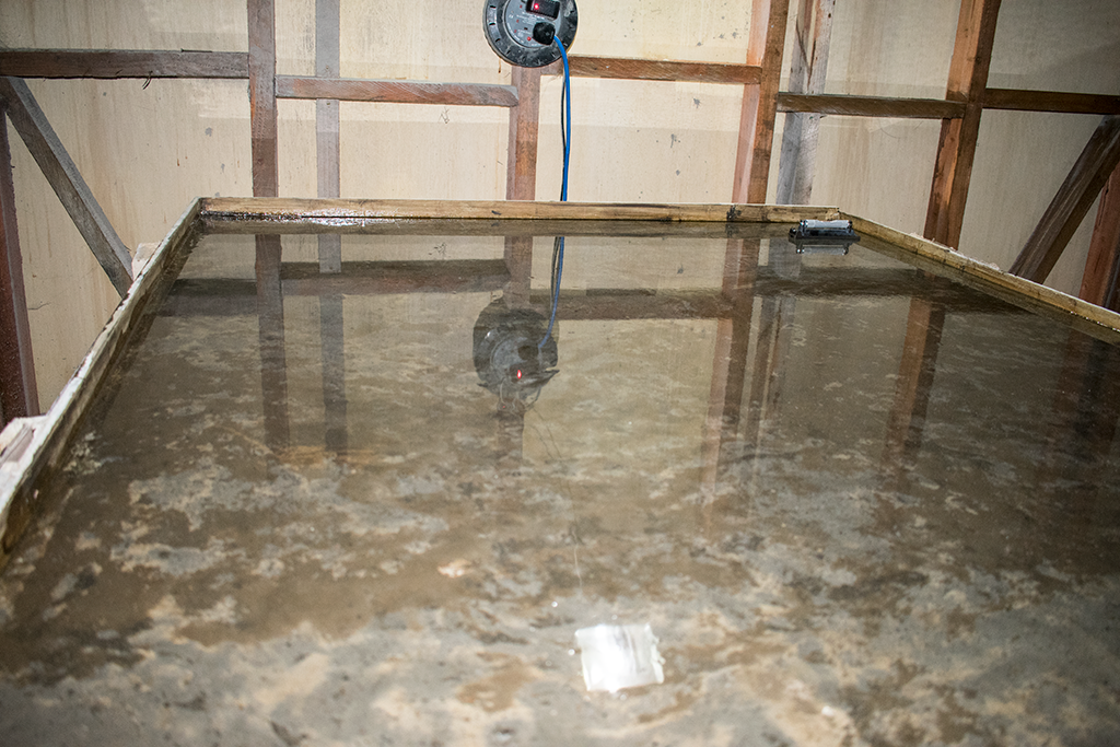

    Today is epoxy pour day (number one)
    I decided to pour the top in two stages. Reason being I wanted to ensure the first layer goes on without a hitch and apparently it's good practice to do it this way.

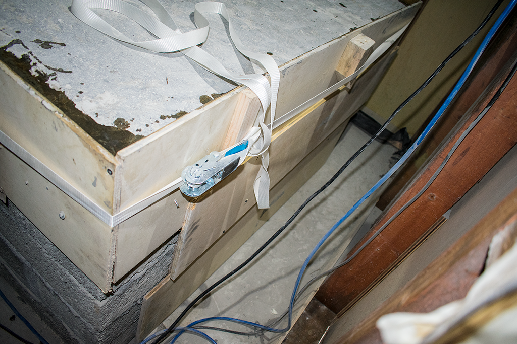

    Step one: I went through the form and sealed all the edges with a small amount of epoxy, allowing it to fully cure before keying it in with some sandpaper. Reasoning here was to be 100% sure that my expensive resin wasn't going to leak down the side of the form. I'm glad I did this first as I was able to spot a few problem areas that needed a couple of coats to seal.

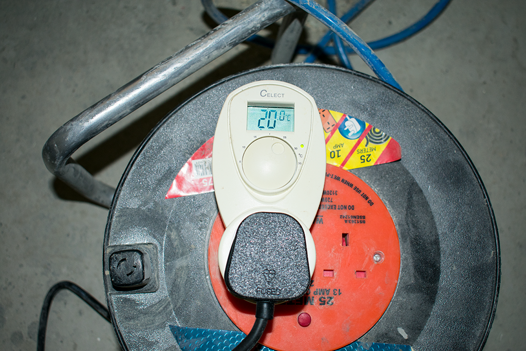

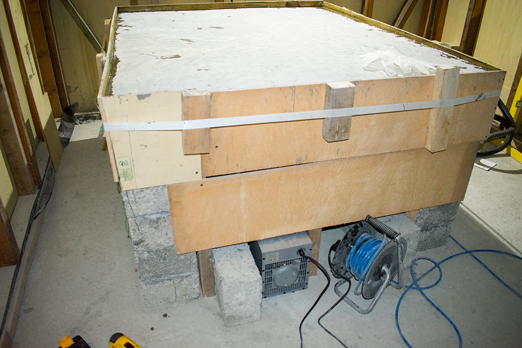

    Step two: I was really concerned about the temperature inhibiting curing. The resin I have is documented to work best above 20 degrees C but will cause issues if the temp drops below 15 degrees. Daytime temps at the moment are above 15 so that isn't an issue but nighttime temps are dropping to 11 or so.
    What I ended up doing is buying a garage fan heater and a 13A plug thermostat. By sealing the underneath section of the form with some ply and blowing the hot air in, the idea is to heat the mass of the concrete base and prevent any issues. I'm told the air temperature doesn't matter so much so long as the surface temp is above the threshold. This seemed like the most efficient way of getting the heat where it's needed without breaking the bank on electricity. We'll see if it works.

    I'm currently in and out of the workshop to pop any troublesome bubbles with a hot air gun, so far so good anyway.

    After 48 hours to cure the first layer of resin is on and cured.

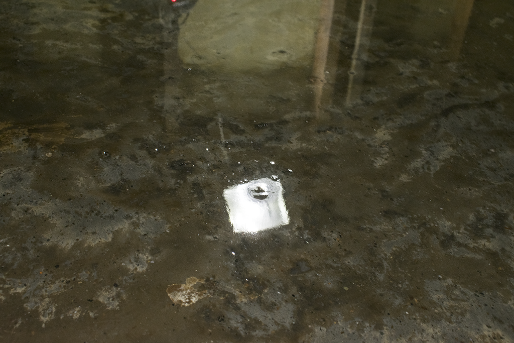

    I'm pretty happy with the result so far. One thing to note is that the concrete, being porous, caused many bubbles during the set up. The resin I have has a very long pot life: >8 hours @ 25C so I was in and out of the workshop every 30 minutes during that period to pop any bubbles as resin sank into the pores. It wasn't much hassle to be honest, the heat gun takes the bubbles out in a flash with a quick pass. Incidentally I should mention I have an adjustable heat gun (designed for reworking PCB's) so that was set to the lowest heat setting in order to avoid overheating the resin.

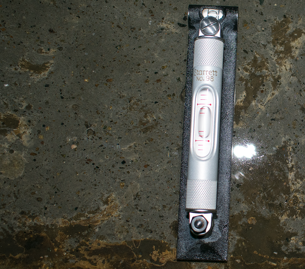

    After cure I'm quite happy with the results, it's self levelled very well indeed. I have a sensitive Starett No 98 machinists level and it's no more that fractions of a mm off in the worst spots. I'm also glad I chose to do it in two stages, the porous nature of the concrete left some areas with creators as the resin sank into pores during the end of the pot life leaving small craters. At this stage it will be completely watertight so the next layer should even that out nicely.
    I plan to leave it to cure for another day or so as I get on with other things following this I'll key it in lightly with some sandpaper, hoover up the dust and pour the second layer in the same way.
