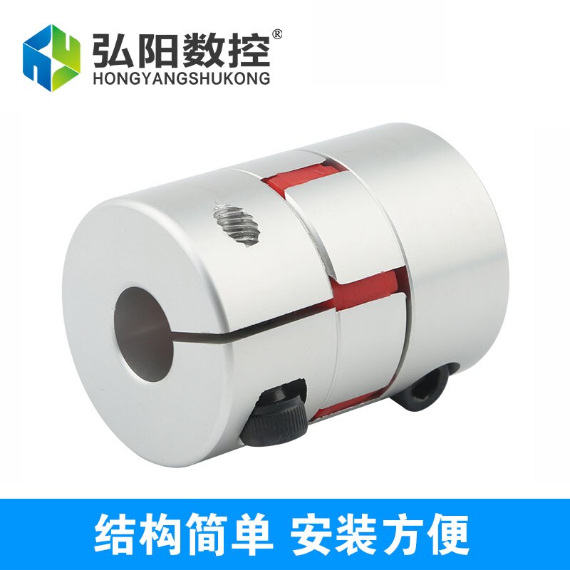

    AM882 has fault protection it should detect missing steps and estop and I swapped all the couplings for these style, I bought the chunkier ones.
    so they're rated twice the nm of the motors.

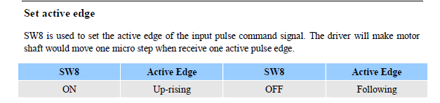

    What should the rising edge be set to?
    I have it set to uprising at moment

    It depends on the controller and whether it looks at the rising or falling edge.
    However it's easy to test. Just write some G-code that moves back n forth few hundred short moves, say 10mm, then back to zero. If you have the wrong edge set it will lose a step for every direction change and it won't return to zero. Do this for each axis separately.

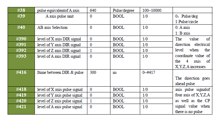

    OK I drilled a small hole just outside my normal machining area set that as X&Y 0
    then created code to
    G01 X10
    G01 X0
    1000 times doesn't seem to have shifted
    just running the Y code now
    Will try Z after that.
    Can I do something similar to see if I'm losing steps?
    Or is there some test code for that?
    In the manual there's "Level of Axis pulse signal" what does this mean? Is that the rising/falling edge?
Name:	level pulse signal.png
