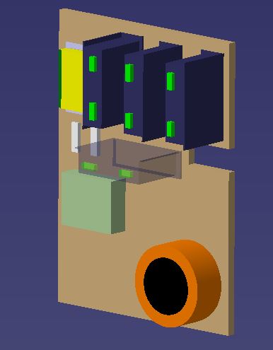

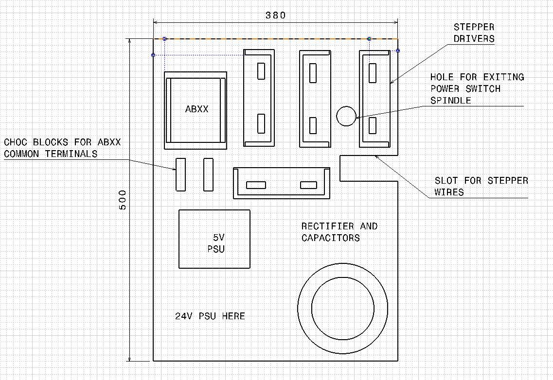

  8. #98
    Apparently I havn't got as much room in the cabinet as I thought.
  9. #99
    Quote Originally Posted by ngwagwa View Post
    QFT: That single statement is what we've all felt like at some time. Today I've been stacking BoBs on top of BoBs, and Relay boards on top of PSUs... and the cabinet always looked too big on paper.
    It's not big or clever, but there's always the third dimension.
  10. #100
    That's why I modelled it solids.
Name:	3d layout.JPG
