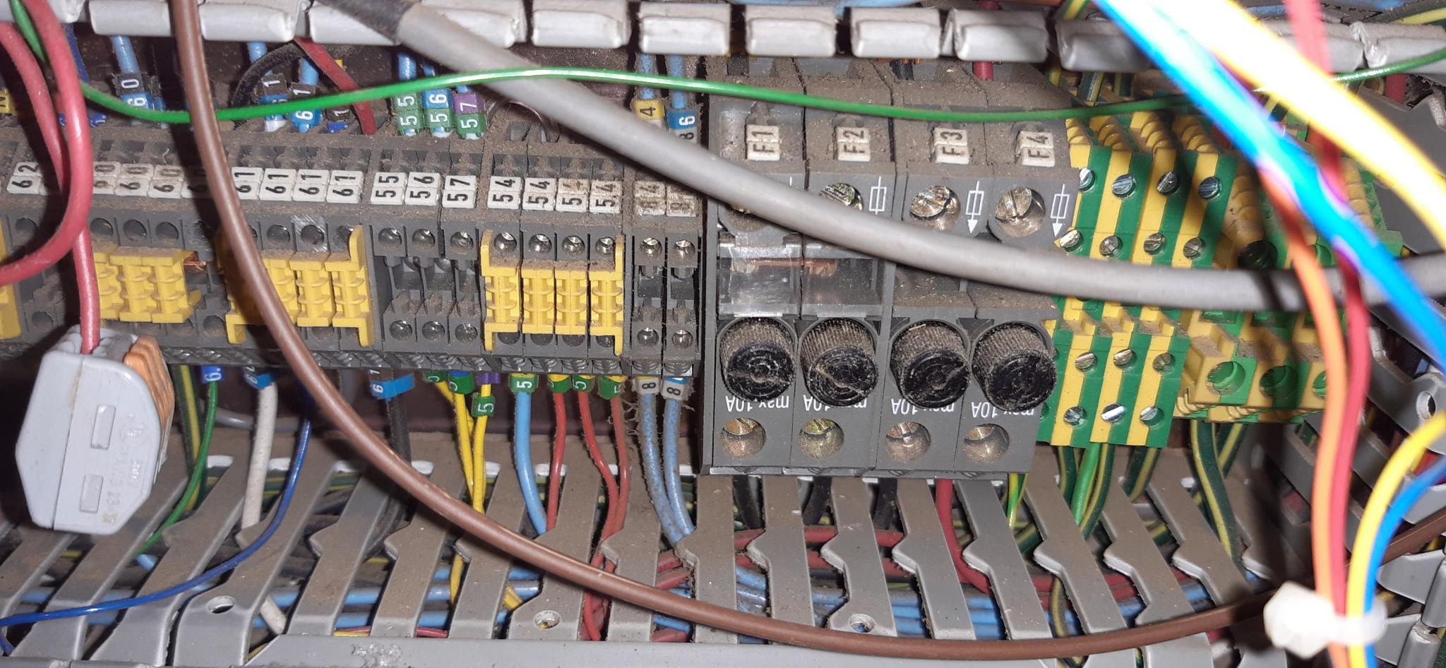

    Regadng my rewire here is the bottom rail that wouldn't have been too clear on the previous pictures. I suppose I can use some of these for splitting the rectified output from the toroidal transformer?

    I'll bow out of the conversation on re-using DIN rail terminals - I'm not familiar with them enough to advise (Only recently realised there's such things as shorting links). If you have the rail installed (which you have) it feels like a good opportunity, but others here with more experience will offer a more accurate view.

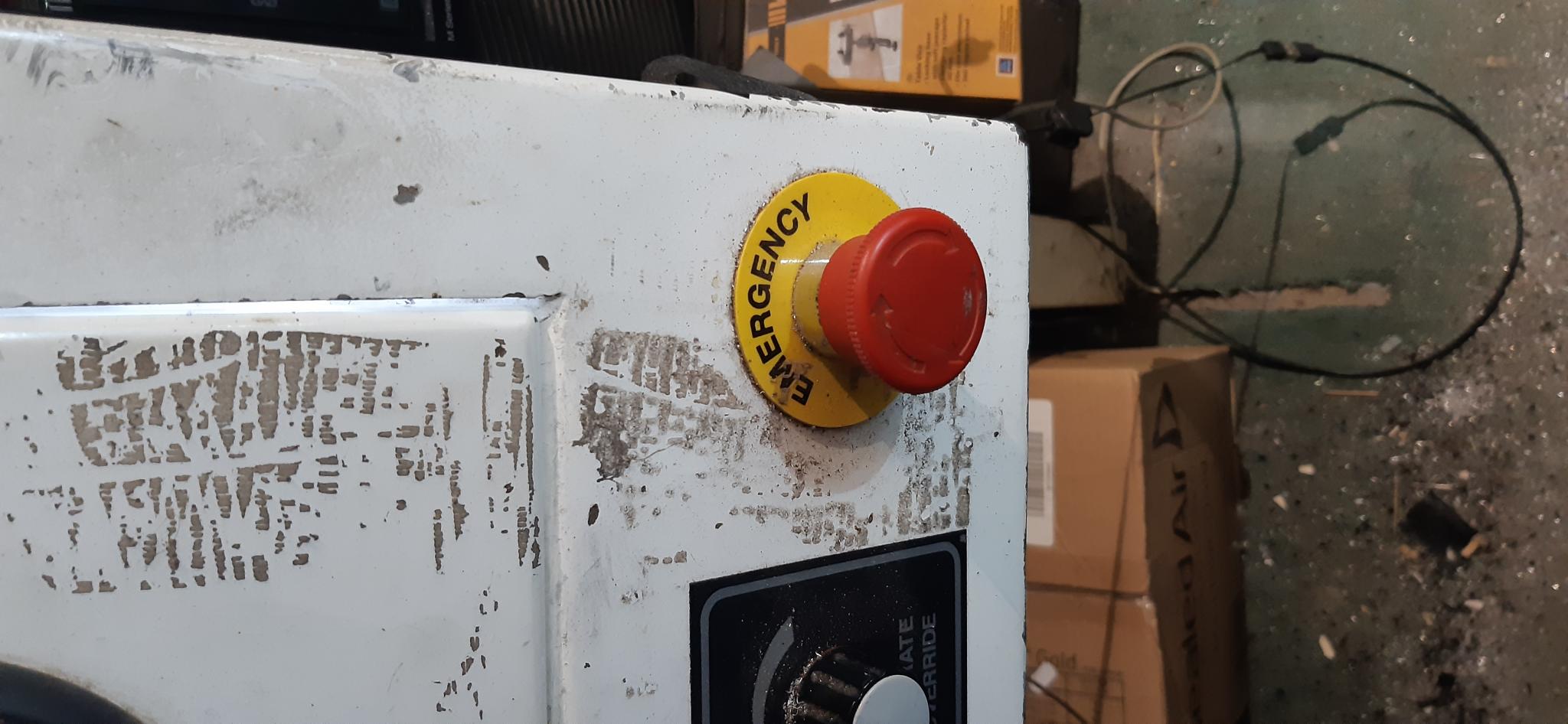

    JAZZ I have just remembered the E-Stop switch stays in when pressed, I have to turn it (I think) to get it back out.

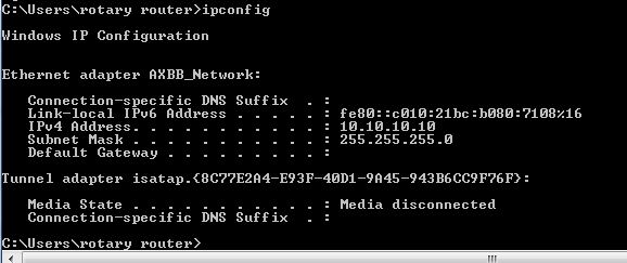

    Have installed a Startech PCI Ethernet Network Card and crossover cable direct to the AXBB.
    It sometimes connects but often wont.
    Utility V1.8 also sometimes does not see the AXBB and when it does it all is OK when I test the connection.
    UCCNC V1.2111 sometimes connects to the machine and sometimes doesn't and sometimes it wants to start in demo mode.
    No anti virus installed and Firewall turned off.
    Have tried with onboard network card enabled and disabled and have tried with both my Windows 7 PC (crossover cable only) and with my windows 10 laptop (straight and crossover cable)
    Turning off the AXBB for 5 minutes and/or rebooting either PC does not help.
    During all the attempts pinging the AXBB does not lose any packets
    Two PCs, starting to sound more like a AXBB issue - but that's a very very premature conclusion.
    Can you post the results of "ipconfig" from a dos prompt? And are you familiar with Wireshark? - it would be useful to know if the comms to the board is bring routed onto the correct interface... but it's not something that you can pick up in 2 minutes.

    I disabled the onboard ethernet.
