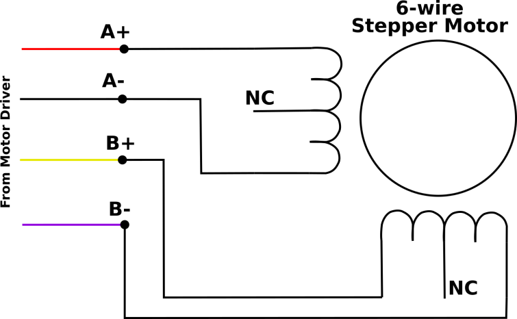

    So out of stepper I have 6 wires 2 pairs each with a resistance of 2.4 and two purple wires with a resistance 0.4. The 2 pairs are connected to the drivers and i have (so far) been unable to trace the purple inside the cabinet but they are not connected together and there is no connection between the 2 puple and the other 2 pairs.
  5. #135
    Quote Originally Posted by ngwagwa View Post
    I've tried reading around while I'm bored and didn't get very far. All I've got is:
    6 wire steppers can be wired Unipolar or Bipolar(series).
    My guess is it's in series and NC means not connected?
  6. #136
    That's the configuration on my X Axis (I found out thanks to JAZZNC and Doddy) it was originally wired A+ to COM and B+ to COM so we changed it as per your diagram.
    Thinking the Y and Z axis would be the same I was examining the wires on the Z axis (typo earlier) but all I could find were two pairs with a resistance of 2.4 and the 2 purple with a resistance of 0.4,
  7. #137
