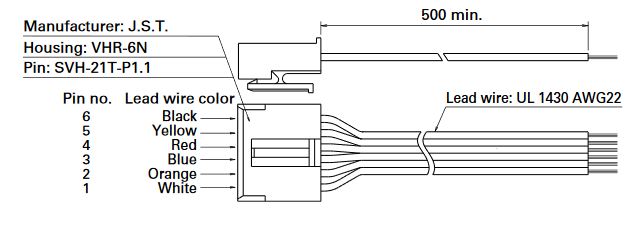

    If these are wired in a unipolar manner - which is sounds as though they are... you will need to isolate the centre taps. I appreciate the buggeration that comes with this - and recognise that at this time you're probably trying to keep the machine in a recoverable format (normally I'd just cut/isolate the cable at the stepper), but I understand you may want to be a bit more circumspect. the centre tap will be either to ground or to +V and it'll be causing problems for the driver - certainly your described behaviour I can imagine with the centre taps connected.

    Out of the stepper motor I have Black - White - Orange - Red - Blue and Yellow
    Blue and yellow are not connected to the cable
    White is connected to the yellow in the cable
    I can't be sure if these are the same in the cabinet but in the cabinet I have the following pairs
    Read and Yelow
    Black and orange
    These are all labelled X
    The Stepper motor is Sanyodenki 103H7124

    So by my reckoning I I am connecting to the taps on the stepper?
  4. #84
    It's simple to test just check the resistance between the three wires of each coil. One pair will be double the resistance of the others. These two are the ones you want for each coil.
    Do the same for the other coil and you have found your 4 wires needed. Just leave the others disconnected but terminated for safety.

    If I understand Carl properly, what he's saying is (I think - please confirm) from the first paragraph: that one the centre-tap to one end of the coil is wired into the cabinet - a half-coil configuration. This presents a reduced torque for the machine (obviously by Denford design) - and those motors aren't particularly torquey to begin with. You can work with this for now at least - it was always a choice on this conversion.
