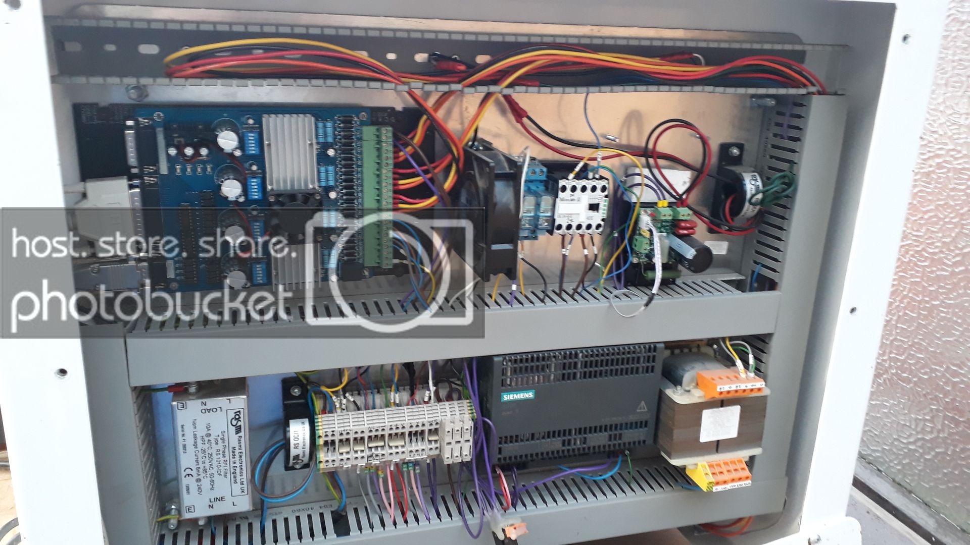

    OK, right, sorry for the delay, you know how life is sometimes.
    I opened the back up and was confronted with this:

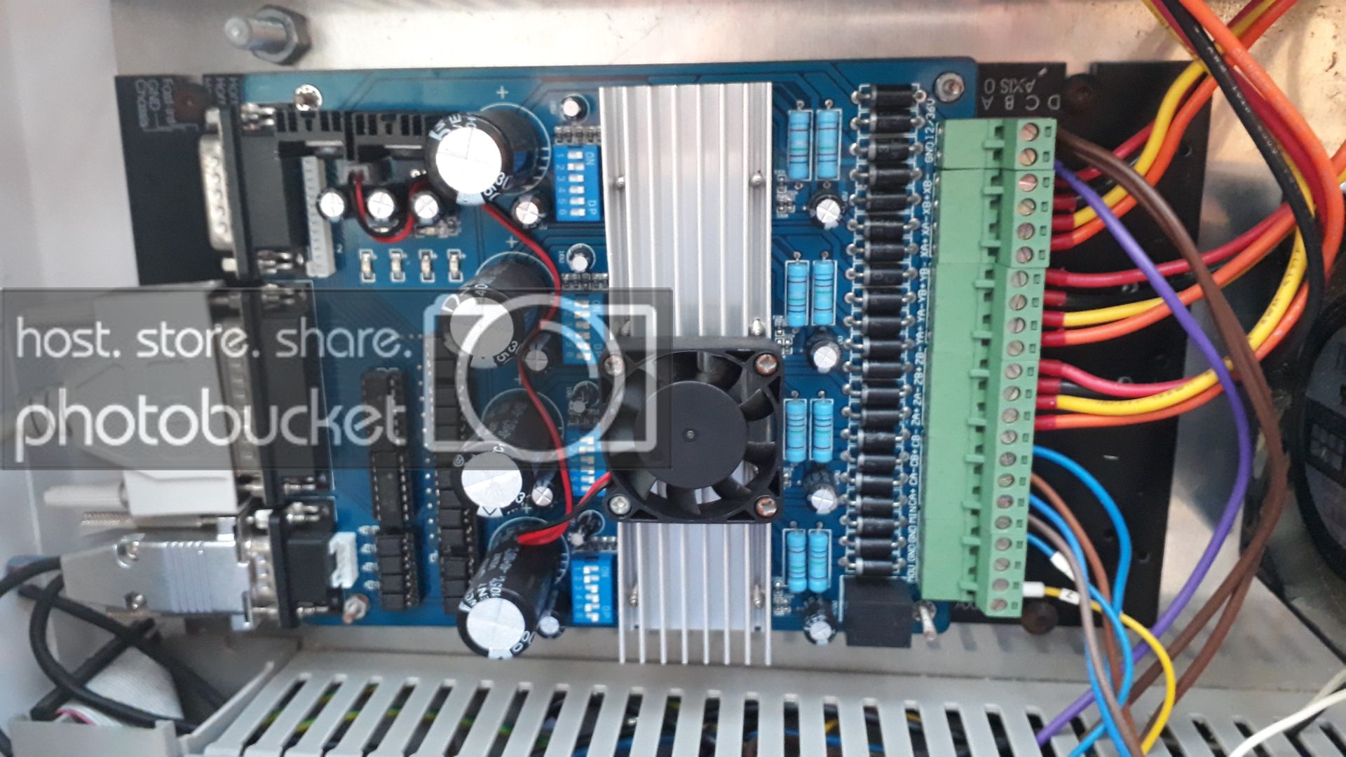

    Question 1, Am I correct in thinking the control board is the one on the top right? This thing here:
    If so, it looks like a non original part and is probably part of the mach 3 conversion. How am I doing? on the right track? lol I don't think the drivers for my pci card were installed correctly. I had to install them manually into the right folder, so I either haven't done that right, or I installed an incorrect driver. Either way, it's doing my head in, which leads me to my next question.

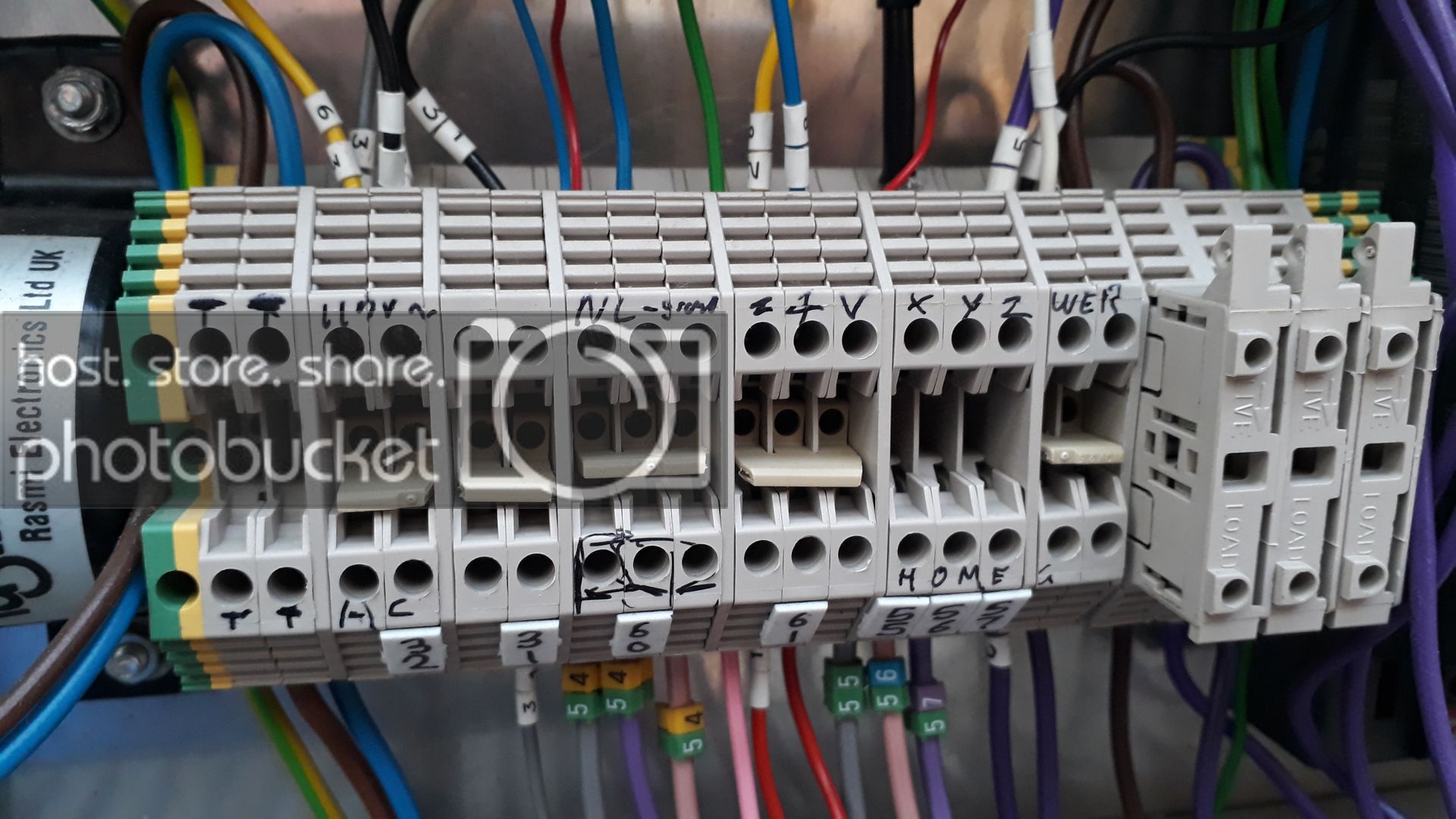

    Question 3, If I wanted to go down the route of using a standalone controller, like a ddcsv2.1 for example, would that simply be a question of extending the wires that go into here:

    # 1 Yes but unfortunately it's not good news because that board is a All-in-one board so the drives for the motors are built into it. So to replace you'll also need new drives for the motors.
    #2 If starting over then I'd advise you to go with an Ethernet-based Controller. Most modern PC's have ethernet so you won't need any PCI cards etc Regards software then you'll only need the control software ie: Mach3 and any Plug-in for the controller (Nearly all external controllers require plug-in)
    #3 If you had drives then yes, in theory, it would just be a case of re-wiring to the stand-alone controller.
    But warn you if you can't get your head around this setup then you have no chance dealing with the DDcsv2.1 or any of the cheap chinese controllers. So unless you speak Chinese and like puzzles then stay away from is my advice.!
