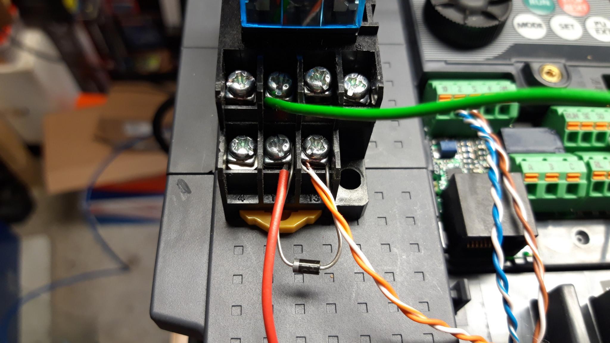

    So does the relay and the diode look correct...
    the 24v live to the relay is constant direct from the power supply if i test from 0v on the power supply.
    i have 0v across pin 13 and 14 and then 24v across pin 13 and 14 when the spindle is turned on but only when the relay is pulled out.... it i put the relay in and test i only get 2 or 3v
    just to confirm...on the relay is pin 13 to be 24v or 0v

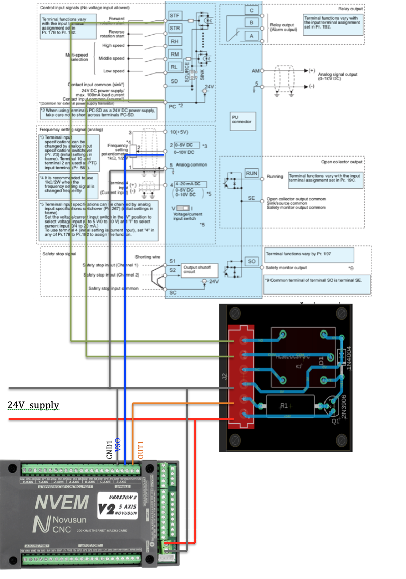

    Thanks. The diode is correct.
    I've not been clear enough in how to measure the voltage, but the bit that you've said that you get 2-3 volts across the relay when the spindle should be on... that means you're dropping 3 volts across the relay coil which at 650R (roughly what it should be, given Jazz's quote of 36mA draw current) gives a switching current of around 4.5mA - bottom end of the performance of the opto-isolator of the NVEM and certainly not enough to actuate the relay.
    If you are prepared to PM me your address I'll pop a gadget in the post (it's just the PNP transistor set-up... but I'll test it works before posting). Or, if you're happy to source/wire one up yourself then go for it.

    Can't share images via PM so posting here...
