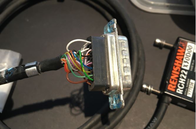

    For example I just bought a used RGH22 – it was too cheap not to buy it and just having a closer look at that.
    To start with a silly question: can a Renishaw encoder work with a different linear scale as specified?
