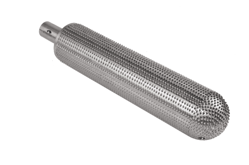

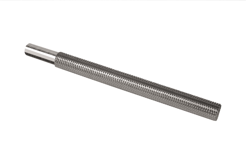

    I've been milling insulation board for ages with ground drill bits and ball mill ends but a someone requires styrofoam to be milled and it looks like it requires a different mill. There are specialist companies like Styrotec who make solid and hollow bits for polysterene but they are super expensive.
    Where can I buy a cheaper alternative rotary rasps in 6-8 or 10mm diameter that will cut 120mm of cutting depth? see pics

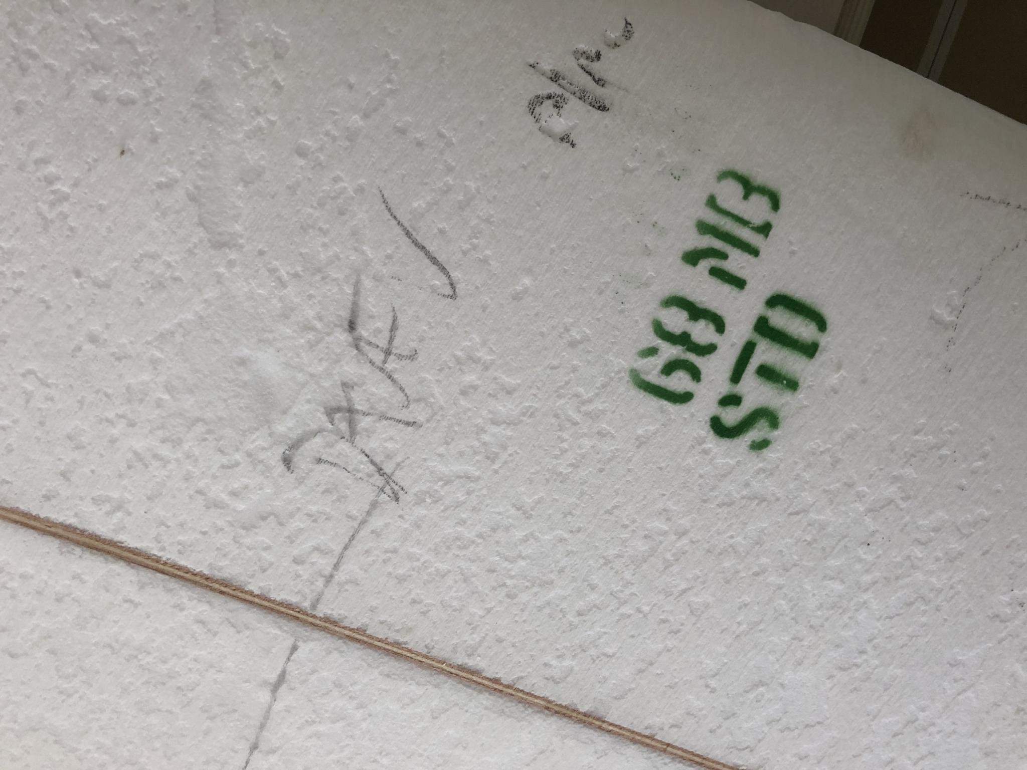

    ok.. have you seen the plywood in the centre of a surfboard.. that's what it would cut..
    Can you post an image or diagram

    Ok so its a bit of 4mm or something. Horizontally or vertically down the centre? TBH need a bit more information to discuss solutions.
    If its just a single thickness sheet of ply and you know the depth can you not set up a cut path with a 2 flute just to cut the ply then have another toolpath and cutter for the foam? I have 12mm 2 flute endmills up to about 100-120mm which will take down that ply in just a few layers. it all depends how deep you need to mill.
