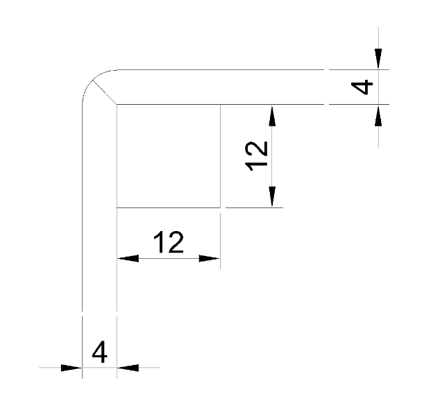

    I'm not sure Ali will be your friend in this game because it is so soft. Also, it doesn't "work" well - forming 90 degree bends can crack the material unless you have a silly large bend-radius. Maybe steel sheet with something like a scroll-saw with a metal-cutting blade would offer a cheap entry level capability?, next your challenge would be to finish the product - powder coating or similar, can be outsourced.
    If you're doing one-ers, then as Jazz says ask for someone with suitable machine to do the cutting for you; if you're planning to do more then you need to be a bit more realistic with your machining requirements and costs.

    First of all, to respond to @JAZZCNC with some more information. I can't give you a picture at the moment, but I shall try to give a better description. At this stage, it's really just a concept I have in my head. The idea is to create a cube-shaped case, firstly because I don't like the look of tower cases and I find a cube to be a geometrically pleasing shape, and secondly because I'm looking for something which will offer lots of space for parts, particularly for hard drives. The cube shape also ensures that all 6 sides will be the exact same size, which I think may be beneficial for manufacturing. To make it more aesthetically pleasing, I'm picturing rounded edges instead of straight sharp edges, like a die. (as in dice) So imagine a die but then a lot bigger. I'm not sure what the exact size will be just yet, but let's say maybe about 15 inches in all directions, could end up bigger or smaller. In the eight corners, I had imagined small cubes to fasten the 6 sides of the case to. But other options are still on the table, such as a cube-shaped frame from aluminium bars to attach the sheets to. On the inside of the cube, I'm picturing a horizontal sheet about halfway up, splitting the case in an upper and a lower portion. This sheet will extend forwards from the back, but not all the way, leaving room at the front for airflow between the upper and lower compartments as well as fitting space for hard drives. This sheet will be the mounting place for the motherboard of the computer. In the lower compartment, I would mount a power supply unit at the back (which will require a cutout in the back plate) and a bunch of hard drives at the front. There would even be room for a second power supply at the back, if that turns out to be necessary for the amount of hard drives. The back plate would also require cutouts in the upper compartment for the motherboard I/O block and the expansion slots, which will at least have a graphics card. Around the sides (left, right, front and back) there will also be an as of yet undetermined number of circular cutouts for the ventilation fans, but I have not yet determined exactly where they would go. I've been toying with the idea of placing them just like the dots on an actual die, but I'm not sure if this is feasible or if I'll actually want that in the end. All six panels should be attached in a way which would make them easily detachable, so I figured on using a certain type of thumb screws. I would also like to use hot swap bays for the hard drives just to make it easier to add new ones or replace existing ones. I want them to be easily accessible, but have not decided whether I want them to be directly accessible at the front of the case (which would again require cutouts) or just accessible after removing a plate. Somewhere I'll also have to account for a power button, just to be able to turn the system on. The front would seem like a logical place for that, but perhaps I'll decide to place it at the back, since the system will generally be running 24/7 anyway.
    Here's a side view I quickly put together in AutoCAD (I can only do 2D drawings and would have to learn how to do 3D first) to illustrate how I had imagined the plates to come together. The 12 by 12 cube would have threaded holes on three sides (or all the way through) in order to fasten the three plates to it. It may be slightly harder to put together originally, but once it has been put together it would be a breeze to take of one of the plates, or more, as long as you're careful about which ones you take off at the same time. I had first thought of using 4 mm thick aluminium, to allow for the rounded edges and possibly other types of machines, such as maybe countersinking screw holes. Now I'm thinking maybe 2 mm thick aluminium would be enough. But this is just to illustrate the idea anyway. You could probably see how the 45 degree angle and the partially rounded edges on all sides of the six plates might be a bit problematic for someone who doesn't have the proper tools or experience to pull something like this off, which is why I first thought of having it machined for me. I may decide to forego on those rounded edges altogether, if I'm gonna do things myself.
    Nah it's easy to bend if you get the right stuff. I bend it all the time, all my Z-axis covers are bent and folded 90Deg, I fold up water tanks and header, petrol tanks etc upto 3mm with out any issues.
