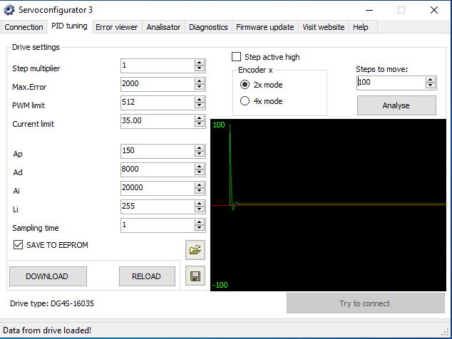

    I finally got another chance to play with the mill, with no success at all so far!
    The more I mess with tuning the more I realise I have no idea what I'm doing!
    When you say unstable, I assume you are referring to the visual display on the servoconfig software displaying any line that is not a straight one?
    I am a bit unsure of the actual shape of the plot I should be looking for as well, from what I've researched on the subject it should be a square up and back down kind of thing?
    I have attached a screenshot of the settings I have currently, which I believe are not correct at all but this is the only combination I got to that doesn't result in the motor oscillating back and forward.
Name:	X axis Servo Config.PNG

    The response doesn't look too daft. Ideally you wouldn't get any overshoot or oscillation on this kind of step change. You aren't far off, although the numbers do seem a bit odd. The P value seems very low and the D seems high. The I seems way OTT. You also seem to have a bit of an offset left when the system has settled down. The I would take care of this normally but perhaps your very low P is an issue.
    Did you start with P, then dial in some D, then finally some I? It will start to wobble, oscillate, tremble etc if you overdo it and it can get a bit exciting on occasion. Back off about 20% or so to give yourself some margin before trying to dial in the next term. It's a bit of a black art!

    I started with everything at zero ( Ap, Ad, Ai, Li) then started with the Ap but anything past 200 made it oscillate like mad. Whereas on the other two motors I think they were around 1000-1500 figure.
    I ended up taking the motor off the machine in the end, I got a bit carried away with the settings at one stage and the machine got a bit of a jig on. Hopefully it didn't do any lasting mechanical damage! Having it off the machine shouldn't effect setting it up too much should it?
    I guess I will just have to keep at it, try increasing P and backing off the D and I?
    When you say it has a bit of an offset, I should be aiming to get the green line back down to zero (red line) and have as little oscillation before that as possible? I think I was getting confused by what I should be looking for. Researching PID tuning for the 100th time seems to be making it a little bit clearer now
