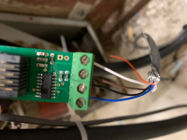

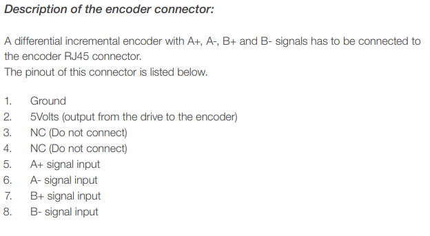

    Just noticed after I posted that, looks like I may have the + and - the wrong way around on the A and B inputs from the line driver to the servo drive!
    EDIT: Would this actually cause any issues though? or just result in opposite rotation?

    As long as you've still got the A/B paired correctly, direction is the only thing that could be affected.
