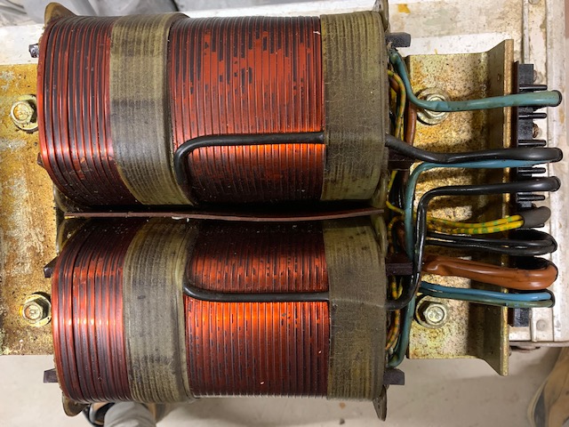

    Started moving on to the electrical side of things and I've come to a bit of a halt already trying to work out the transformer..
    In the attached picture, the right three wires should be the primary coil supply, so according to the diagram on the transformer that's either 415V or 380V supply going in? And on the left are either end of the two secondary coils which are labelled as 2 x 140V...
    So I guess what I'm trying to verify is that I will really only need to connect my 415V AC supply to the primary, and then remove some winding from both secondary coils until I achieve 100V across them?
    I have also attached a photo of how it was wired in the current setup, I got a little confused with what appeared to be a 140V leg attached to ground? everything the same colour wire makes it so confusing!!

    One of the windings is across 1 and 2 - it's the winding at the top of the RH photo. The other winding is between 3 and 4 and is wound on the bottom of the photo. They are connected in series, so that you end up with double the voltage of each winding, from end to end. The centre of the combined winding is grounded. You could remove that unless you want your system voltage hard connected at its midpoint - at least this way the DC is at a known potential.
    Looks as if you have both 380Vac and 415Vac primary taps.
    If you are going to use a 415Vac connection, the primary would be connected across any 2 of the 3 phases of the 415Vac mains. However, if you were to connect it across single phase 240Vac, you'd get proportionally less output voltage. That might actually be handy here.
    If you had 2 x 140Vac connected in series and full wave rectified them, you'd end up with 1.414 x 280Vac, which would be almost 400Vdc. You probably don't want that! If those really are 140Vac each, your original rectifier must have been half wave rectifying the outputs with the 0V at the grounded centre tap, so that each winding only conducted half of the time, giving a final DC voltage of around 200Vdc.
    If you were to connect up the 380Vac primary tap to single phase 240Vac you'd get 88-0-88 Vac, which would get you about 125Vdc if you used half wave rectification. That would be a simple solution if you don't mind a slightly lower max speed. Probably wouldn't be an issue really.
    If you want to get closer to 140Vdc output with 380Vac or 415Vac input, yes you'd want to be seeing 100Vac on each winding and connect it up as it was originally ie half wave rectification. One diode on the end of each winding, each pointing to the electrolytic cap, with the "0V" cap negative taken from the centre tap. To do that, you'd need to cut the big black wires on the outside of the windings and remove equal turns from each until the output is 100Vac. That's about 30% of the wire.

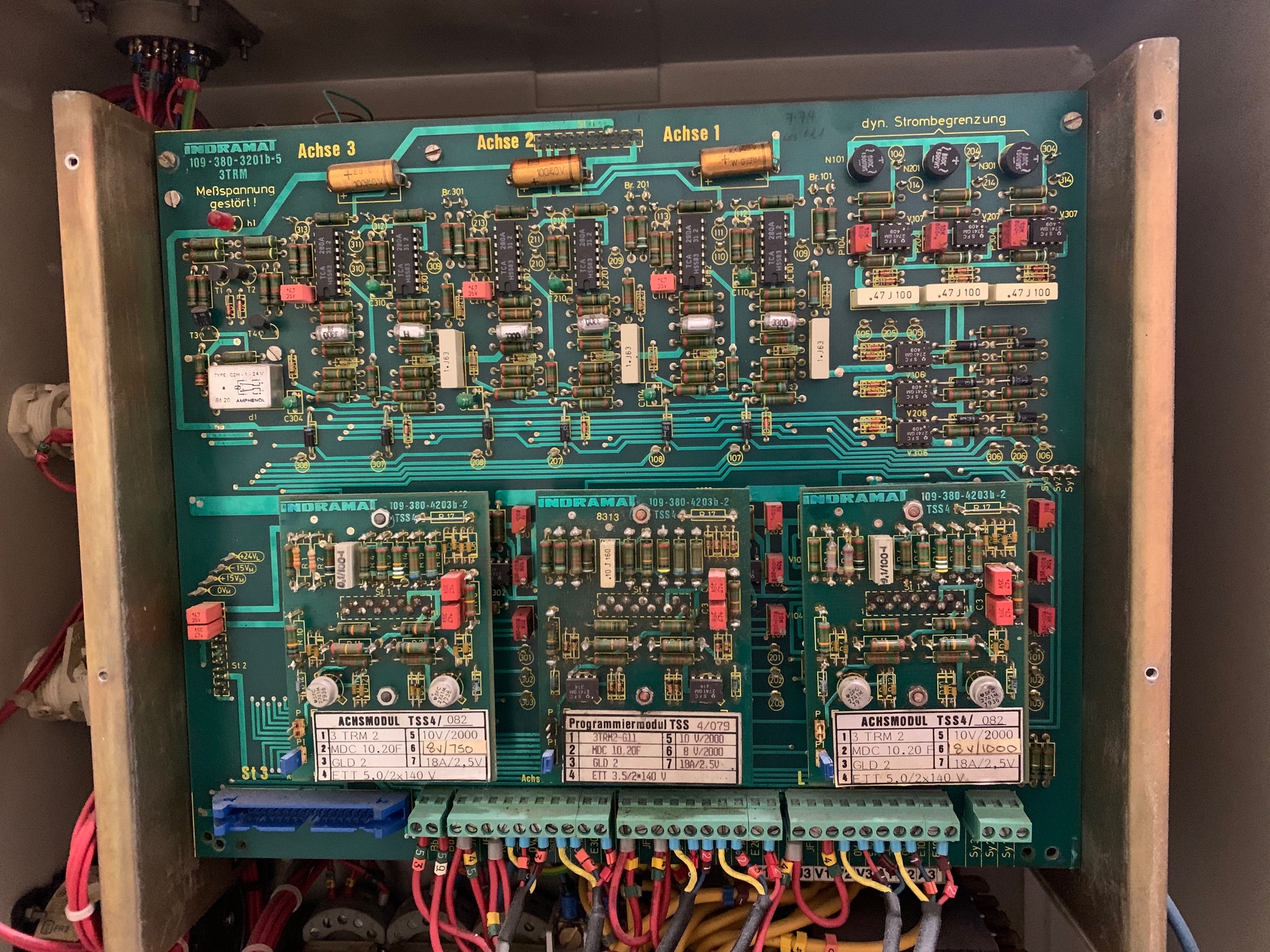

    That was going to be my next plea for help, I can't confidently say I have located the capacitors and rectifiers! I have attached a load of photos of the internals, if you wouldn't mind casting your expert eye over them that would be much appreciated.

    Hmm, that seems to be a set of 3 SCR phase angle controllers rather than "normal" (to us) DC servo drives. These run from ac, so you can look and you can look but you won't find any big electrolytic caps anywhere. The 3 axis drives are those power modules in the 4th photo. You can see there are 6 of them in the 3rd photo. The drivers for the SCRs are in the 2nd photo. The date codes on the compts suggest the boards were built in 1980, so it's an old beast. Technically, they operate at 50Hz, rather than several kHz and vary the duty cycle to modulate the motor current / torque.
    Bottom line is that there is no electrolytic cap(s) and the rectification is actually done by the SCRs (thyristors) and the SCRs are commutated (turned off) by the alternating voltage. The supply voltage is indeed two lots of 140V - but ac not dc. The labels on the axis / SCR controllers mention "2x140V", or 280Vac centre tapped in fact.
    I think you can safely bin all the contents of the cabinet, as there is almost nothing you can reuse. Even the mains transformer is of questionable value to you. If I were you, I'd want to run the whole thing from 240Vac single phase and keep away from 415V, as there's really no benefit. You need 100Vac on the secondary, a simple bridge rectifier (600V) and an electrolytic cap rated at around 200Vdc.
    The servo motors look like good machines and are indeed DC brushed motors. As I said earlier, you can get rid of the tachos and replace them with simple encoders. Indramat is nowadays part of Bosch Rexroth etc, so these drives and motors were probably designed like brick shithouses.
    I'm not certain what those 3 transformer-like things are. They are labelled "Drossel" which means something like "choke", so probably line inductors to filter out the current lumps and improve the mains current waveform / power factor. Again, almost certainly of little or no value to you.
