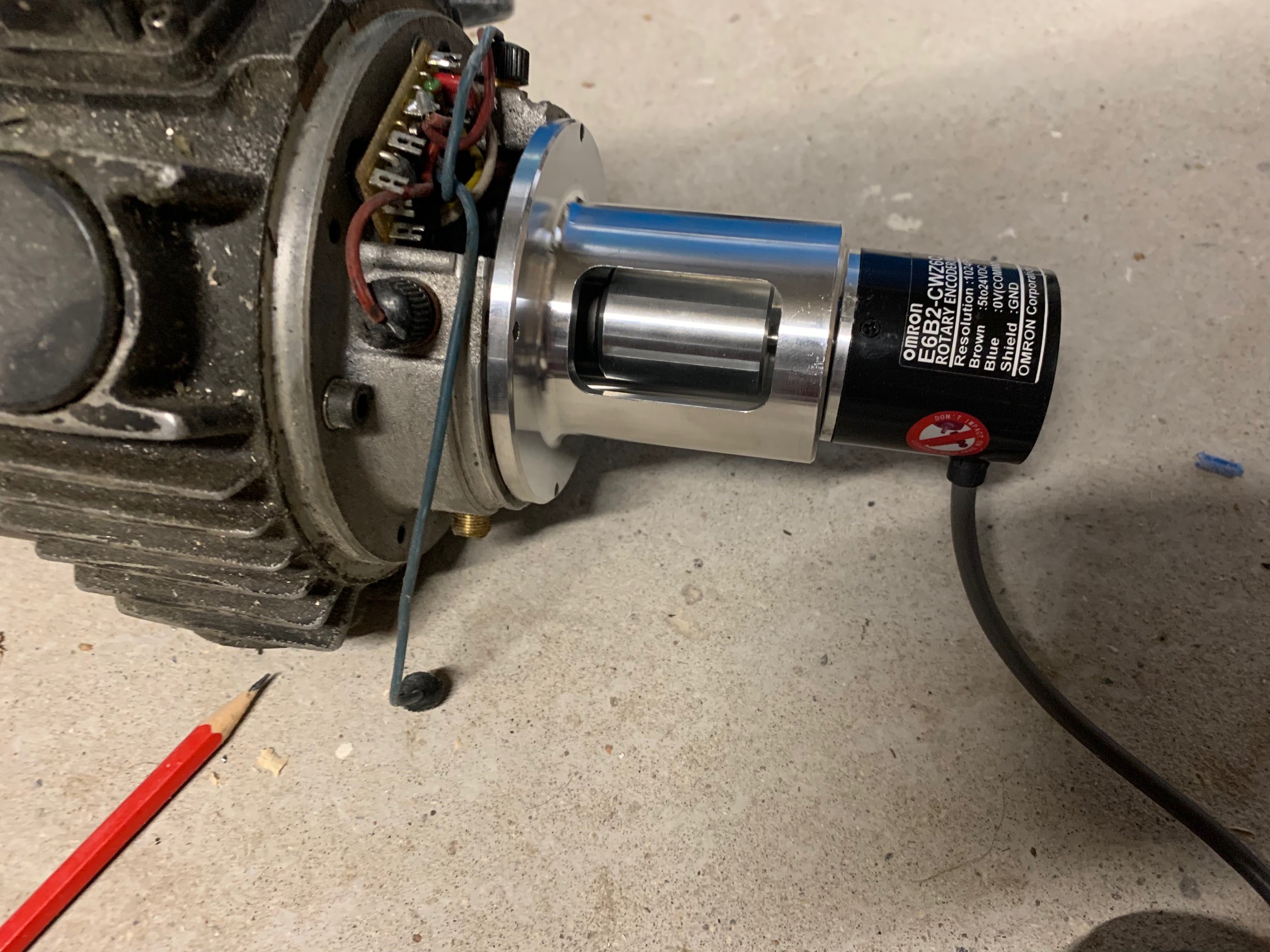

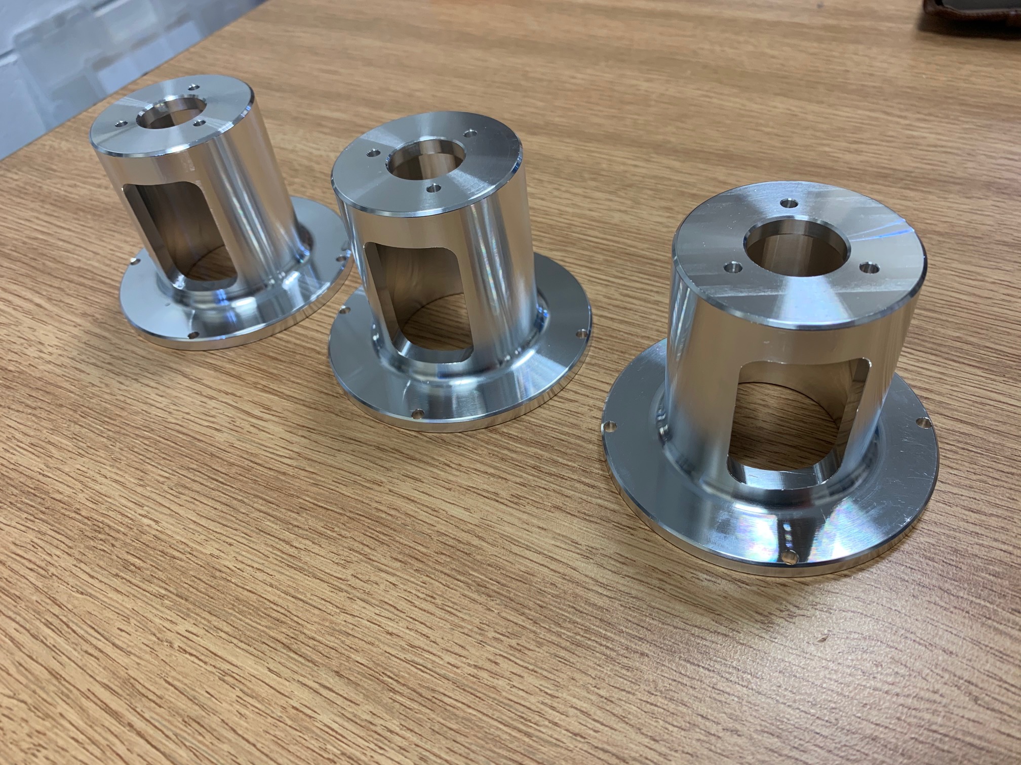

    Started getting everything mounted up in the cabinet now, changed the layout god knows how many times. The base plate's like swiss cheese now!!
    Got the mounts for the encoders machined up to bolt to the motors, they add a bit more length than I would have liked but I didn't want to start modifying and shortening the motor shafts really so I'll just have to live with it. Once (if) it's up and running I'll make a cover to protect them a bit more.

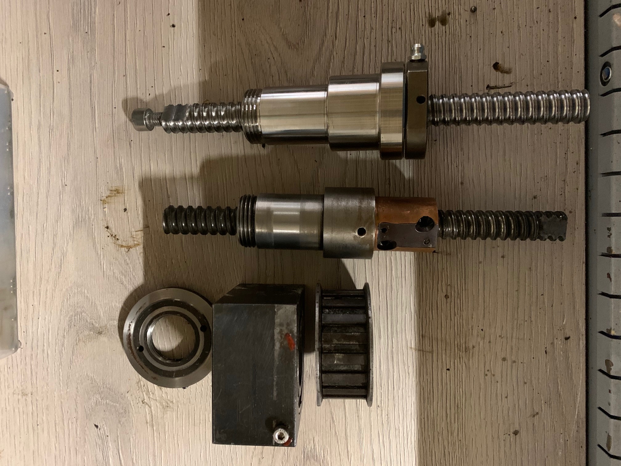

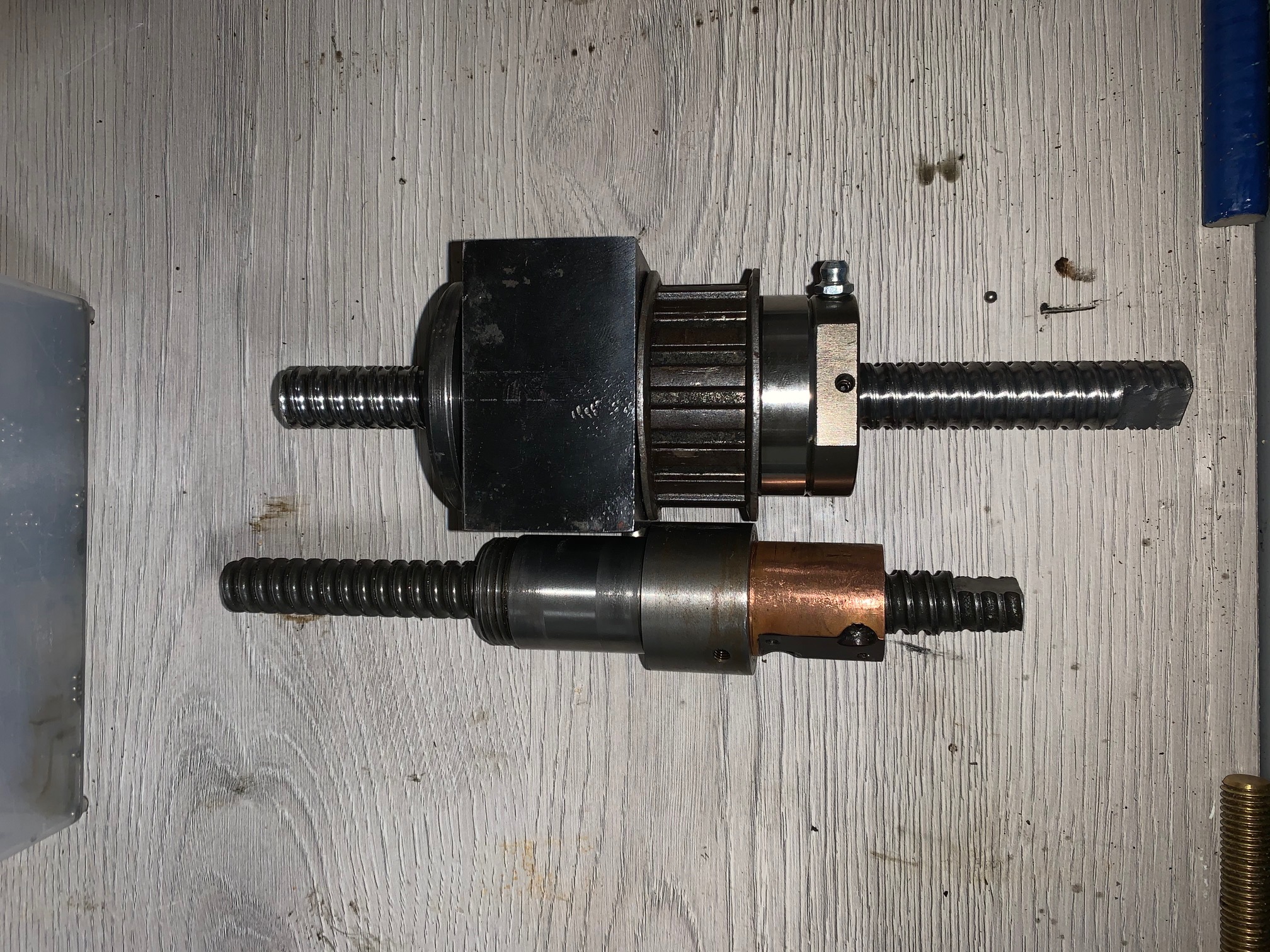

    Also finished the new pulley mount for the Z axis ball screw. (and yes, I did reassemble the ball screw the wrong way after machining it...that was rather annoying to assemble twice!)

    Those housings look the part. Good to have access to decent machines when doing this sort of work.
    Looks as if you actually replaced the Z axis ballscrew / ballnut? Did you enjoy machining the hardened steel? Sparks everywhere?

    Thanks, it certainly makes things easier! Worth taking the extra effort to make them properly, hopefully less head aches with setting them up knowing they are machined properly so the alignment between them should be good.
    I replaced them both in the end, the old screw was cracked and it was an odd size. Also needed new bearings as well so just replaced the lot. Can't beat a bit of hard machining, sparks were disappointing though! It was actually worryingly not that hard if I'm honest... looked to be case hardened around 3mm per side, the rest was really soft...
    I guessed it wasn't going to be amazing quality based on the price, think its was £30 for the screw and nut... we'll see how it does.

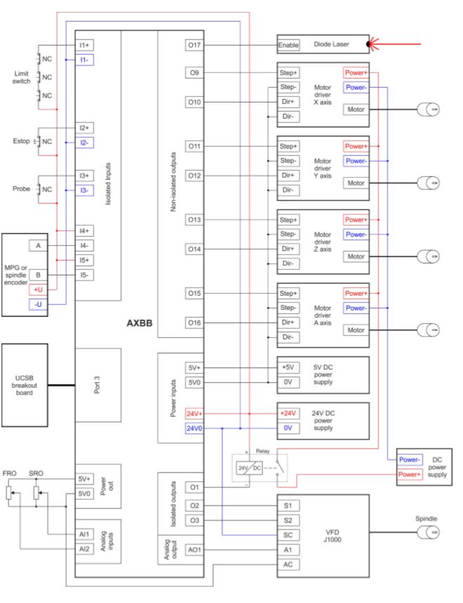

    Starting to get somewhere with wiring it all up now, just a quick query before I do something stupid...
    so the wiring instructions for the main plug from the drive to AXBB board are:
    The pinout of the Main connector is listed below:
    1) Step signal input
    2) Direction signal input
    3) Ground for Step and Direction signals (NOT for power)
    4) 5V power input. (if this input is fed then the 7.pin should not be connected!)
    5) Reset (input) and Stop input)
    6) Error (output) and Stop input
    7) DC power + (12V DC input for digital processor)
    8) DC power – (ground for the 12V DC power supply)
    Step 3 says NOT for power, but the wiring diagram shows it connected to the 0V of the 5VDC power supply...
