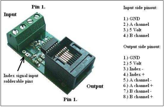

    I've attached a photo of the encoder just so you can verify it's even suitable for this application..
    So the encoder wiring is labelled up as:
    Brown: 5 - 24VDC
    Blue: 0V Common
    Shield: GND
    Black: OUT A
    White: OUT B
    Orange: OUT Z
    This is wired to the line driver module to convert to differential signals. I have attached a photo of the wiring info for this, but all it is is ground, A, 5 Volts, and B. so I have this wired up as:
    Ground: Blue: 0V Common
    A: Black: OUT A
    5 Volt: Brown: 5 - 24VDC
    B: White: OUT B
    From there it is just a standard RJ45 cable that plugs into the drive unit. I have also tested the cables I'm using with the proper tool to verify the wiring is correct.
    I have also attached the pin outs for the RJ45 side of the line driver and the servo drive encoder input.

    Just noticed after I posted that, looks like I may have the + and - the wrong way around on the A and B inputs from the line driver to the servo drive!
    EDIT: Would this actually cause any issues though? or just result in opposite rotation?
  5. #105
    Lives in East Lothian, United Kingdom. Last Activity: 15 Hours Ago Forum Superstar, has done so much to help others, they deserve a medal. Has a total post count of 2,984. Received thanks 369 times, giving thanks to others 9 times.
    Quote Originally Posted by JimJam View Post
    As long as you've still got the A/B paired correctly, direction is the only thing that could be affected.

    Progress! You may remember a while ago I tried extending the encoder cables with some CAT5 cable I bought which turned out to be the cause of an earlier issue. I used the same cable to make up the RJ45 cables that link the encoders to the drives.
    I have no idea why I didn't replace these earlier when I had the other issue, but swapping them out for some bought patch cables has stopped the motor juddering..
    I stripped back the outer insulation of a piece of the cable from the reel and every now and then there is a break in the conductor but the insulation remains in tact! which I can only assume was enough to make a contact when I tested the cables but mounting it on the machine must have given it an intermittent connection.
    Now back to the tuning!
