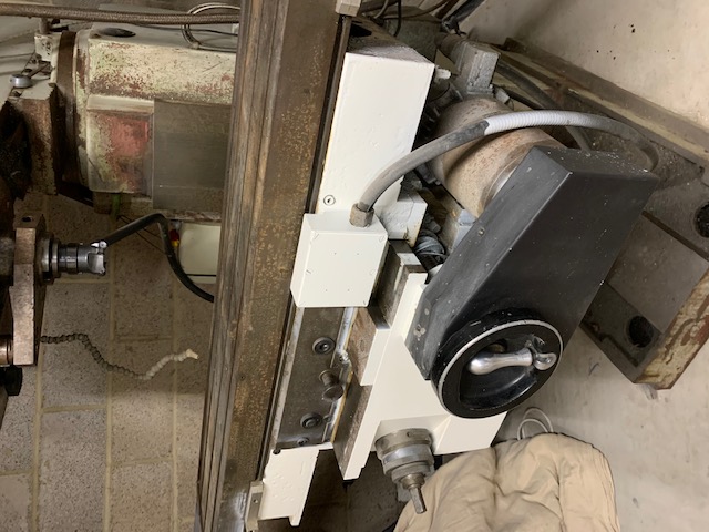

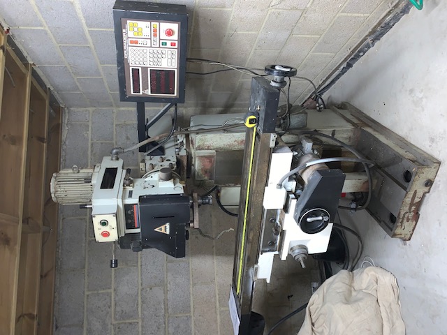

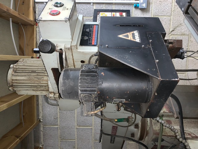

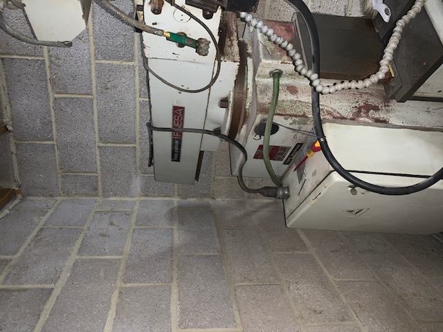

    I currently have an old TOS-KURIM converted knee mill which uses an Anilam Crusader II and analog Indramat drivers for the DC motors. When I bought it everything was working fine but three years in storage while I sorted a home for it seems to have finished it off!
    I've had enough of putting hours into trying to fix it and decided it may just be better to upgrade it to something more modern.
    My plan is to rip everything out and replace all motors, and electronics and use something along the lines of MACH/Centroid to run it.
    That's as far as the plans gone though, I've got plenty of experience running machines but not building them! I'm a bit overwhelmed with all the different motors and the sizes and control boards etc.
    Any help would be awesome on what I need for a low budget install, this is purely a home machine for odd jobs so doesn't need to be amazing. I have access to much better machines at work for anything serious.

    Hi Jamie,
    Some pictures of the machine will help to get a feel for what you have. I've not seen or heard of TOS-KURIM and a quick google showed me a gantry Mill with a boat on it.!!! . .Pretty sure your not milling boats...Lol
    Provided the machines not too massive then you might get away with some large Closed-loop mains driven steppers. They are very powerful and a lot cheaper and simpler than AC servo's. They won't give the speeds servos will but they will do the job if your not chasing high feeds.
    Centroid Acorn would be a good match for the controller.
    haha! definitely not going to be getting any boats in the garage any time soon! I've added some photos to help give you an idea of size but its not really much bigger than a standard Bridgeport to be honest. table length is a little over a metre..

    That should be a simple upgrade you have most of the hard work done in the form of mountings etc, just a few adaptor plates for different size frames with motors will sort it.
    I'm presuming you don't want to CNC the Knee.?
    You just need to decide if want servos or steppers.? Quite a lot more work in setting up along with big learning curve involved with servos but they do give higher feeds, more power along with smoother operation and accuracy.
    The downside is they also cost more money and require a higher level of the controller to get full use out of them. They can be much more temperamental than steppers and very unforgiving on poor wiring quality or practices.
    Steppers, on the other hand, are much simpler to set up with hardly any learning curve involved and quite a bit cheaper. They can be run on a lower level of controller.
    The downside is they are limited to roughly 1200 to 1500Rpm so feeds are lower. Resolution is lower compared to servo's but still more than enough for milling at this level.
    Choosing the correct drives and size is critical with large steppers because you don't have lots of spare power as you do with servos. So if you take this route then look for 220V Mains powered Drives rather than lower AC/DC drives running say 80Vac or 100Vdc.
    I've used these many times and they are a great set up with lots of power and provide reasonable torque even at high feeds. More than enough for your machine.
    https://www.aliexpress.com/item/3279...3cac6f37OxW5VA
    Hope this helps, got any questions just ask.
