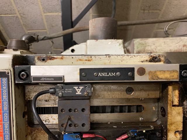

    When you say full blown glass linear scales, that's what most of your Chinesium scales are these days. I have several sets, for my smaller mill and my lathe. They are both single ended TTL output, which is what the CNCdrive servos are looking for - I have those drives on my Shizuoka, so I'm familiar with them. They would certainly connect up OK but whether they'd be happy driving an old machine with backlash would remain to be seen.
    The accuracy is down to what you want to pay. I think mine are the basic 5um ones from HXX in Shenzhen but you can get resolution down to 0.1um from them and others.
    It's possible that high end ones might have differential outputs which are more noise immune, in which case you'd need a line driver to TTL converter.

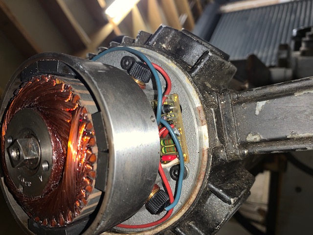

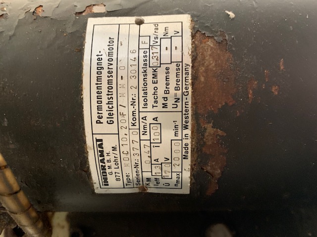

    Ok, so some info I have found about the motors which also seems to match what's on the motor plates (photo attached):
    permanent magnet DC servo motors
    2000RPM
    170V DC

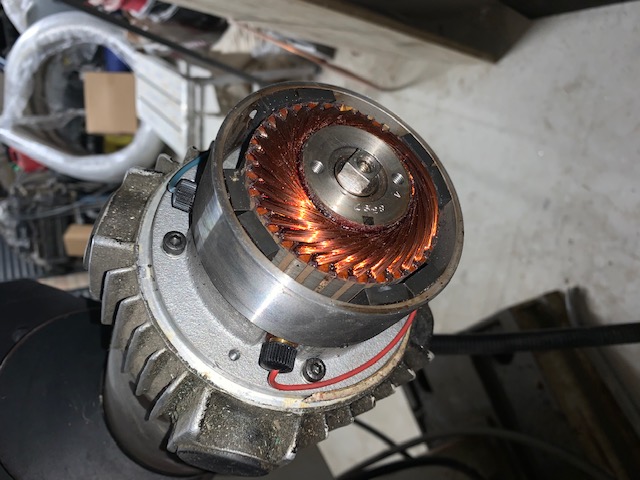

    tachometer mounted on rear (I think.. photo attached), but no idea of what output this gives...

    They are Anilam linear scales with 0.01mm resolution, again no idea of output type but photo attached if anyone might recognise it.

    That is a tacho you are looking at. They have no purpose nowadays, what with digital drives. You should try to remove it to see what the end of the rotor shaft looks like. A rotary encoder typically has a small (6mm or so) shaft and creates negligible torque drag, so mounting one in place of the tacho could be quite simple. Something like this Chinesium clone would be suitable https://www.ebay.com/itm/OMRON-Rotar...g/332386539771
    One of those CNCdrive brushed servo drivers would be fine for a motor like that and the encoder would connect directly to it. https://www.cncdrive.com/DG4S_16035.html The bigger one is rated at 160V / 45A and although your motor is rated at 100A, it's a beast (47Nm!), so you can probably manage very nicely with half of that. The advantage of going this route would be minimal messing with the mechanical parts. You can probably just leave the encoders where they are for now unless you could hook them up with one of the Chinesium DRO displays just to frighten yourself.

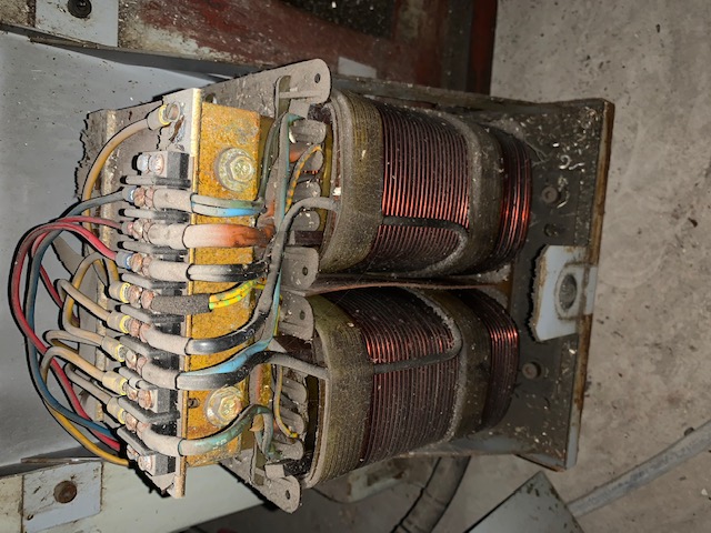

    That looks about right for the kit of parts. I assume you have a main PSU from the original system that can supply the bulk power at around 140Vdc or so? I ended up getting a 120V 3kW isolation transformer from Screwfix and removing some turns from the secondary to get the right output, as the original 3 phase transformer was the size of a house..

    I hadn't thought about the main power supply actually, good point! The current set up has a fairly substantial transformer unit that appears to output various voltages, I know there is a supply at around 140V in the unit supplying the current drives but can't remember if its DC, will have to check!

    If it's like mine, the DC was supplied from a massive three phase transformer. The winding would need to be about 100Vac so that you end up with around 140Vdc off load. Here's how I did mine, way back when https://mightyshiz.blogspot.com/2017...an-handle.html I welded the cores back up afterwards with the MIG.

    My transformer isn't quite the size that came on yours! I think I will repurpose what I have if possible. I found a 'specification sheet' for the transformer that seems to suggest that when used with the motors I have it should be set up to output 150V... but I may be reading it completely wrong! attached photo.
