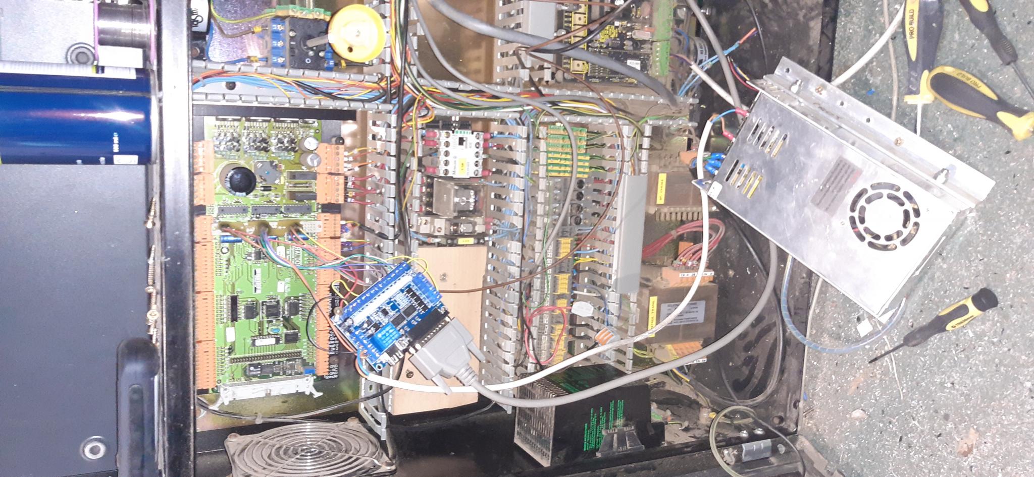

    Here is the control cabinet just after I started:

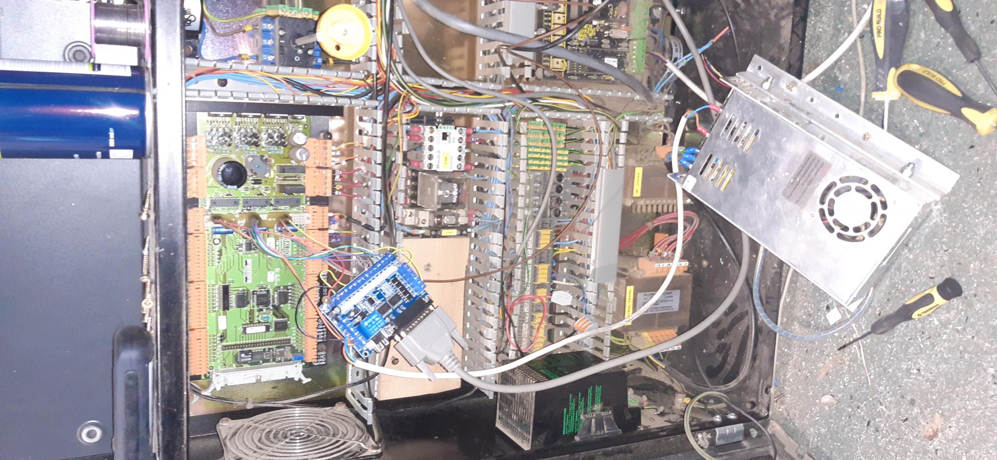

    Progress after day 1. I have identified the X,Y & Z stepper cables and will identify the home switches later. My plan of attack is to disconnect and remove everythng that isn't going to be needed like the old Danford spindle controller. Hopefully I will just be left with the original power/relay/fuses (I did say hopefully)
    Things are going well with the cabinet looking a lot emptier.

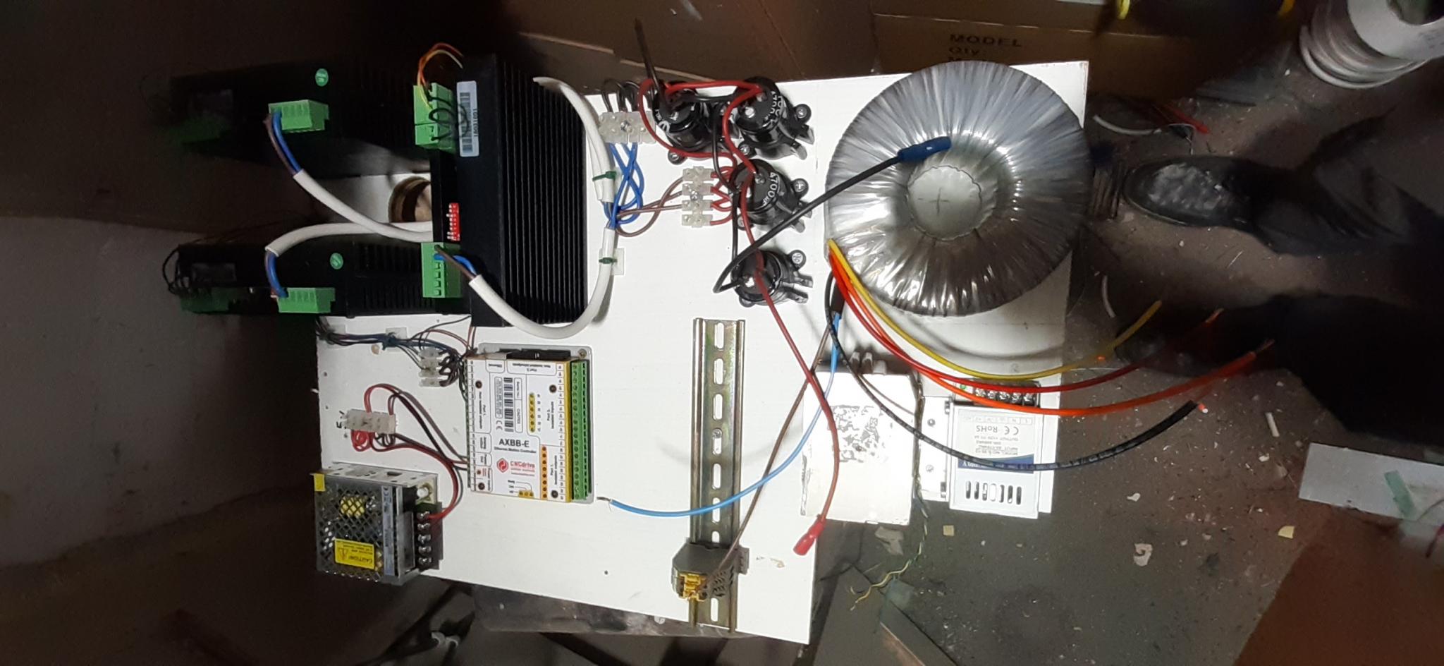

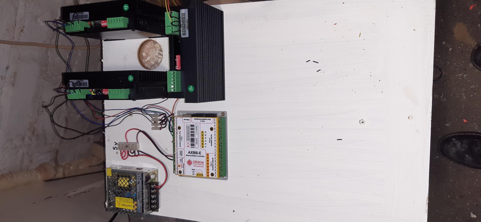

    Bending down inside a cabnet is not as easy as it was (you'll know when you get older) so some work has been done on the new control gear to give my back a rest

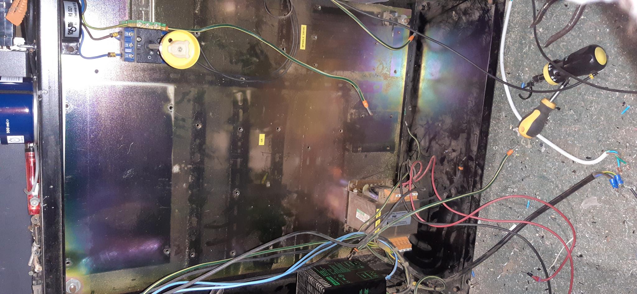

    Not a lot of progress, having to stay home awaiting deliveries doesn't help.
    Cabinet fully stripped of all unwanted items

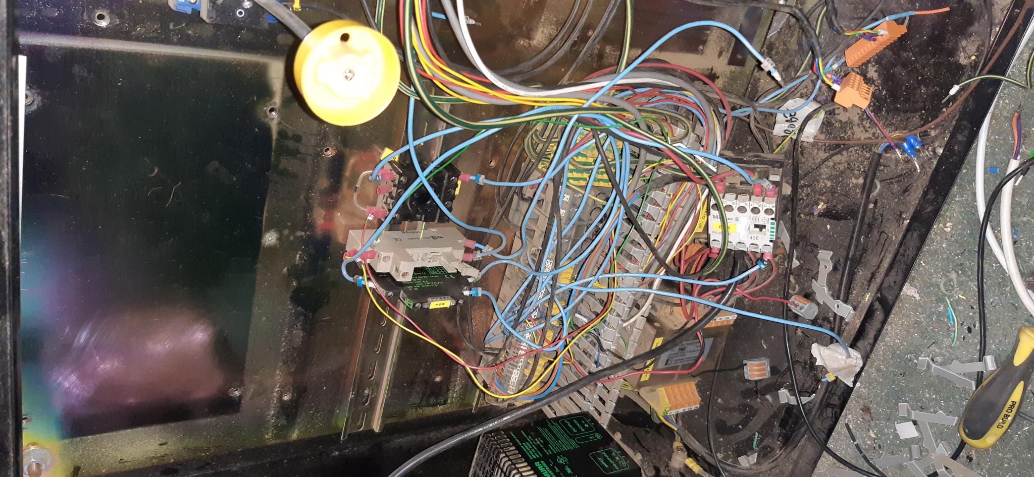

    And a little progress on the new lectrics

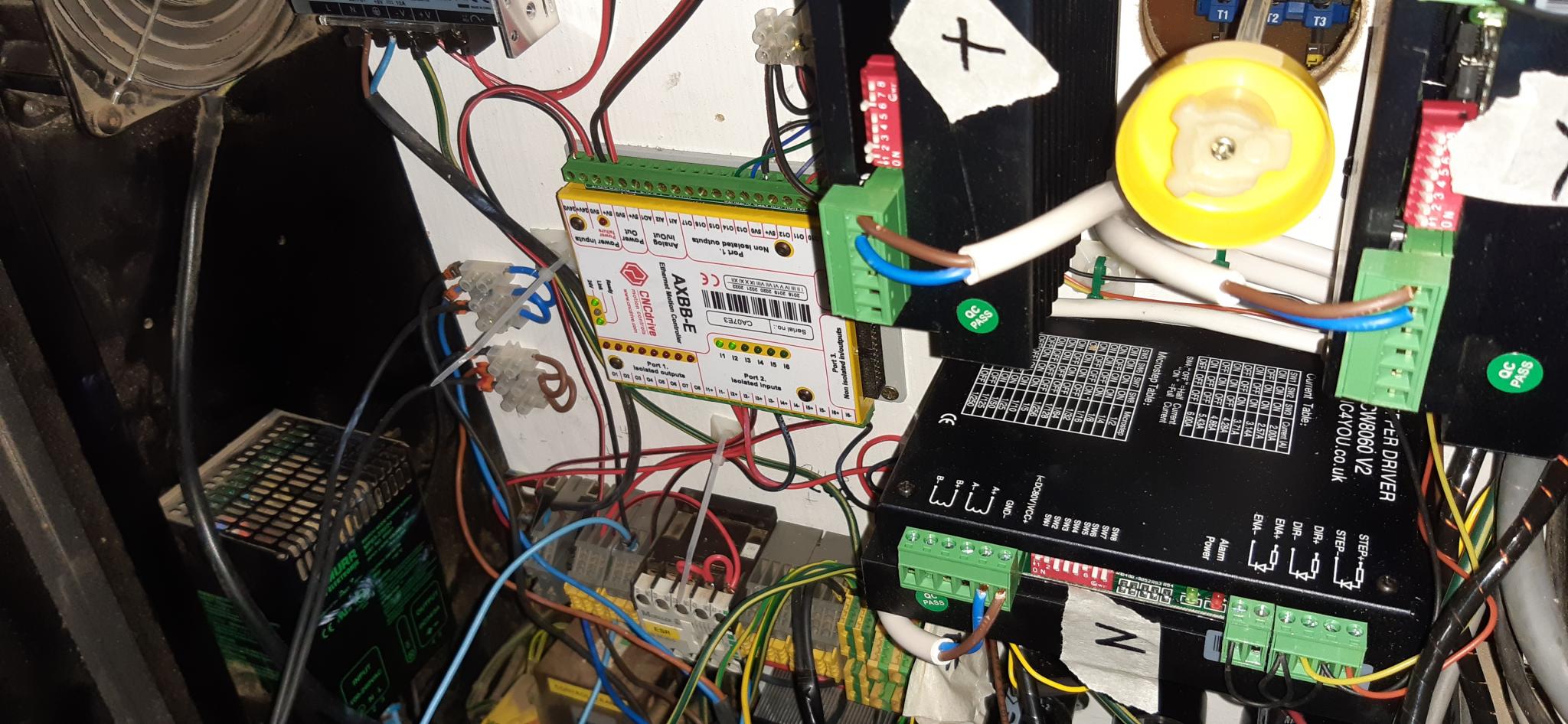

    Next step work out the new wiring.
    Flashing lights and no magic smoke.
    I need to source some bigger terminals for the transformer to rectifier connection and a twisted ethernet cable as going via a hub is having issues connecting.
    The UCCNC software imported the Mach3 setting but although it let me set the E-stop and probe pins and port it doesn't save the home pin or port (looks like I will be googling tonight)
