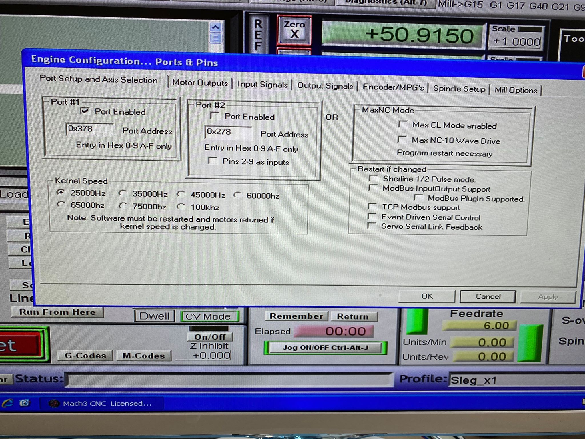

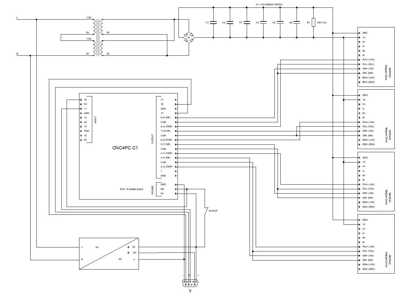

    This is my first forum post so first of all, hello everyone! I am at the stage of building the first cnc plotter, quite large and heavy as for the first machine (about 1.8m x 0.8m) and I would be very grateful if you could help me with electronics. Quite a long time ago I inherited second-hand electronics, theoretically complete set, after amateur coversion of a mini milling machine, although I have problems with it and I hope that this is my lack of knowledge. I would love to use as many components already bought as possible .. but to the point:
    Breakout board - CNC4PC model C1
    1. The motors do not spin despite the fact that Mach software shows movement using the arrows on the keyboard. The motor is locked, it cannot be turned. There are diodes on the breakout board, it seems to me dedicated to outputs, not activated, only the 'outputs status' diode is on, what should I check step by step to verify if the board is ok?
    2. How to check if the drivers are ok? The voltage is fine, 42V on each of them. The voltage between A + and A- and B + and B- in the case of one motor connected is 1.7V, in the other 1.4V. Where there is no motor connected, 42V between A + and A-. Is this correct?
    I would have more questions, but for now, the most important is to verify whether the board and drivers are in full working order and configured with Mach3. The attached photos show Mach3 settings, previously configured with current set up. Thanks in advance for your help, I will post a full 3D project and a schematic after completing the project here. I’ll post more details about my design soon.

    It's been a while since I used one of these but I seem to remember they needed a 5v supply for the charge pump or a jumper setting on the board to disable it. So check the board and there will be 3pins together if I remember correctly with 5V and EN and Gnd. Put a jumper across 5V & EN pins if there isn't one there already and it will disable the charge pump.
    If the board doesn't see 5V across these pins it will disable the outputs which is probably why it's not moving.
    Or you can just put 5v+ on the EN pin and it keeps the charge pump in place then if you lose 5v the outputs get shutdown. Your choice.

    Simplest test first is as Jazz says - check the BOB EN pin and that your e-stop isn't activated. Been there... worn the tee-shirt.
    To test the drivers, disconnect the PUL+ wire from the break-out board to each of the drivers one at a time, and with a bit of wire in the PUL+ input to the driver strike that against the +5V supply. Each connection (and each break/make as you make the connection) should turn the respective motor by one step (or microstep). You might get more joy just listening if the drivers are configured with a large number of micro steps. That will give you a basic level of confidence that the drivers and motors are okay. It's hard to predict the terminal voltage of the drivers - depending upon the motor position you're going to see an instantaneous (static) description somewhere along the waveform of a sine-wave across A-/+ and B-/+ each 90 degrees out of phase (so when A is +Big Volts, B would be tending to Little Volts.... but all depends on where the driver thinks it is along it's rotation.
    You could also strike +5/0V across the EN+/EN- of each driver. That should free the motor on that axis. Not very useful, but again some confidence in the operation of the driver.
    If you get that far then your issues lie either in the break-out board, or your Mach3 installation.

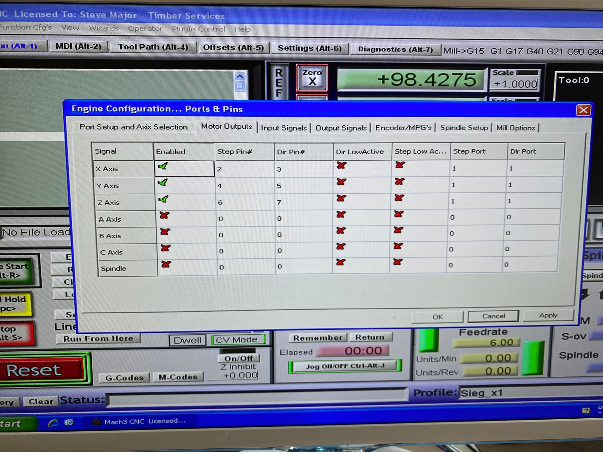

    1) My first question is - has you witnessed the actual computer that you're using with Mach3 successfully drive this board?, I think from your description - no? The problem here is chasing a potential ghost - if the PC is not set-up correctly then you can probe the board all you like and there'll still be no life.
    2) Are you using a full 25w wired parallel cable between the computer and the BoB?, have you tried a quick continuity check to make sure pin-1 goes to pin-1 etc through pin-25? (if you found a random 25w cable it *could* be a serial cable with only a small number of wires connected, and some of those possibly swapped). Check the basics.
    3) Of interest - on the BoB - there's a 3-pin jumper header labelled "JP1" - there should be a shorting pin connecting two of the pins together - which two?

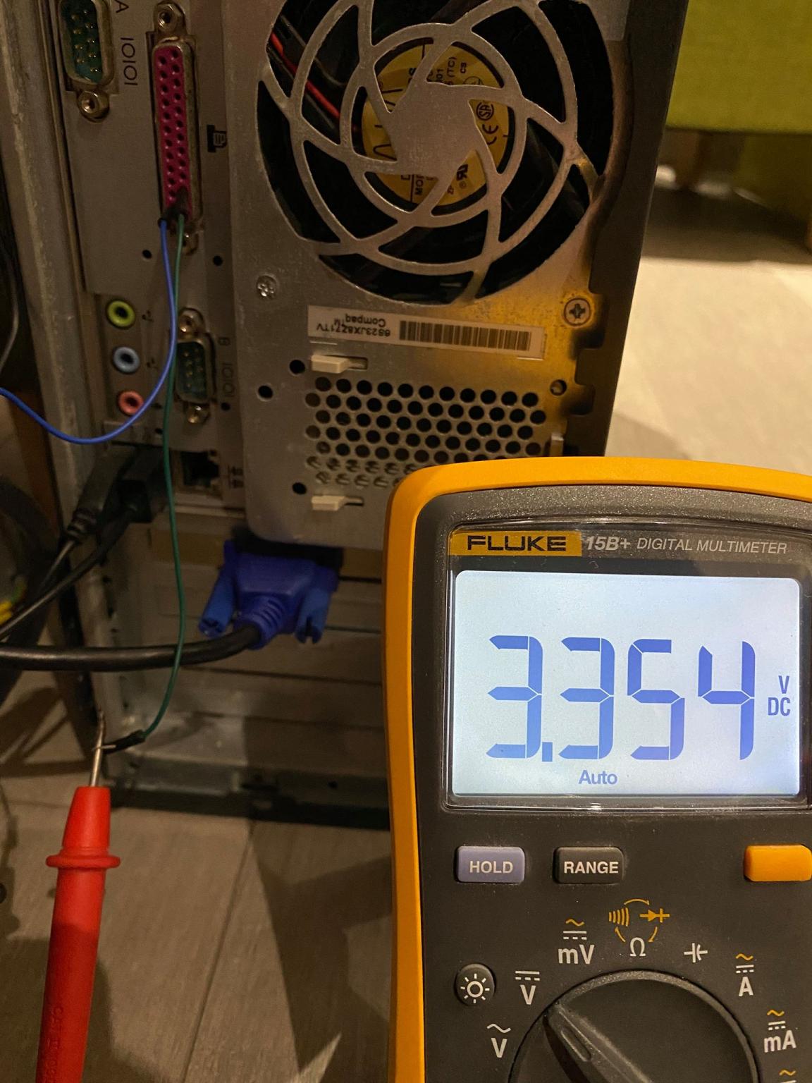

    4) Would you be confident to ***CAREFULLY*** measure the voltage on pin-1 of the 25-W D-type that the computer plugs into, with the system powered. I'm talking about connecting the meter black lead to 0V and carefully probing the PCB where the pin-3 is, and measuring the voltage with the X-Axis moved in one direction, then again with the X-Axis moved in the opposite direction. In one direction you're expecting a voltage less than perhaps 0.8V and in the other direction greater than perhaps 2.5V.
    5) Much easier - could you do this again on the PC. insert a couple of pins or bits of stripped solid strand wire (paperclip?) into pin 3 and pin 25 of the PC parallel port and measure for each direction of X-axis travel. If you can provide a photo of this for our amusement (and validation) - this is getting to the point where we should be able to understand the PC->BoB communication - I think the BoB's basically functional, so this is important to understand why the BoB is not seeing the commands from the PC.

    1) My first question is - has you witnessed the actual computer that you're using with Mach3 successfully drive this board? ..
    No, unfortunately I wasn't able to see everything working. I was given two PC's during system collection with the information that one of them was used with this equipment and should still be ok.
    This shorting pin is connecting pins 2 & 3 (COM=GND)
    I managed to measure a voltage for X, Y and Z axis (just in case) and I was getting just a little bit above 2.5V and 0.07V (not too low?)
    Take a look at the pictures attached, for your amusement :) I’m measuring 3.35V & 0.036V, almost identical on pins 3 to 9.
    From what I understand, there is a communication between PC and BOB, but there is no signal to the outputs .. as you can see at the picture, BOB is a little bit messy so would it be a good idea to give it a good clean with isopropanol for example?

    This board confuses me a little - there are two 5V supplies indicated to this, yet no specific mention in the manual about how to wire these. More interesting is figure 1 in the pdf (https://www.cnc4pc.com/pub/media/pro...SER_MANUAL.pdf) which shows that the PC parallel interface is isolated from the output drive system. This implies pretty strongly two PSUs.
    I asked about measuring the parallel port for two reasons - that Mach3 is driving it properly (generally is, at least the DIR signals) and that it is set to TTL levels - it isn't - it's driving 3.3V which is not ideal, but the image for the chips on the board - ACTs should tolerate this at a logic level. You cannot scavenge 5V directly from this parallel port so with reference to figure 1 I'm wondering how the PC-side interface on the board is powered, versus the "output" side of the board. There is information within figure 1 to suggest "PC +5V" and "PC 0V" which are the two terminals at the top of the board, which in your photo are unconnected.
    So, if you will endure me, I'd ask if you can measure the voltage at the PC +5V to PC 0V at the top of the board as shown in the photo. If there is NO measured voltage then I'd ask you to wire the +5V to the main +5V supply, and the 0V to the main 0V. This destroys the galvanic isolation between PC interface and output drivers, but it's a quick and easy test.
