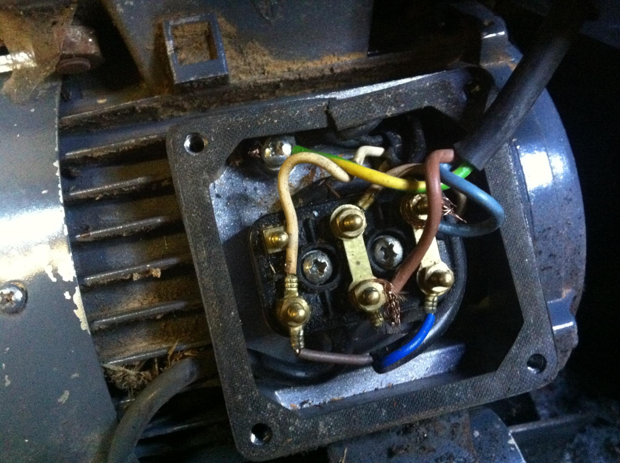

    Hi Clive
    Its single phase according to the plate and it has a single capacitor
    I hear no click on the run-up or run-down
    Its an old Clarke motor that yields very little when run through google :(
    Do you know how it was wired originally. Watch the vid till the end
    I have fitted a switch that impliments the bus bar change... it will now run in reverse ok but i get a single thud in foward but no rotation
    I swapped live and nutral which i didnt think would make any diffrence but i am now assuming if a swap them back over, it might run forward but not in reverse....?
    Attachment 27965
    Attachment 27966
    If there is something obvious I'm doing wrong, let me know :)
    If not, i shall continue the hunt for infomation on this motor.

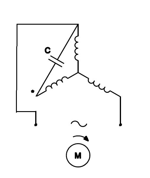

    To reverse in the schematic i posted earlier we may assume the right lead is neutral.
    Then the left lead is fase.
    when you move the fase wire to the top the motor will reverse direction.
    You should check what i am saying next.
    In the picture you posted i think the motor wires are all on the bottom row.
    Starpoint of the motor is hidden.
    Did you draw in green where the actual capacitor is ?
    Grtz Bert

    In its original wiring, it runs counter-clockwise as I face the shaft.... I can get it to run clockwise by rotating the bus bars through 90 degrees BUT I have to also move the Cap from pin2 to pin4 which seems odd and I don't have enough pins in the tumbler switch I have in order to implement that.
    I was hoping an expert would reveal how dumb I was and say something like "you reverse it by moving the cap only"
    I did, I don't know much about AC motor schemes but that motor looked (and sounded) like a different beast to mine.
  4. #14
    Quote Originally Posted by driftspin View Post
    The left lead is fase.
    Grtz Bert
    Are you saying I just move the capacitor like this or am I doing as I have been and moving the capacitor AND rotating the bus bars?
    You will have to excuse my poor grasp of AC motors

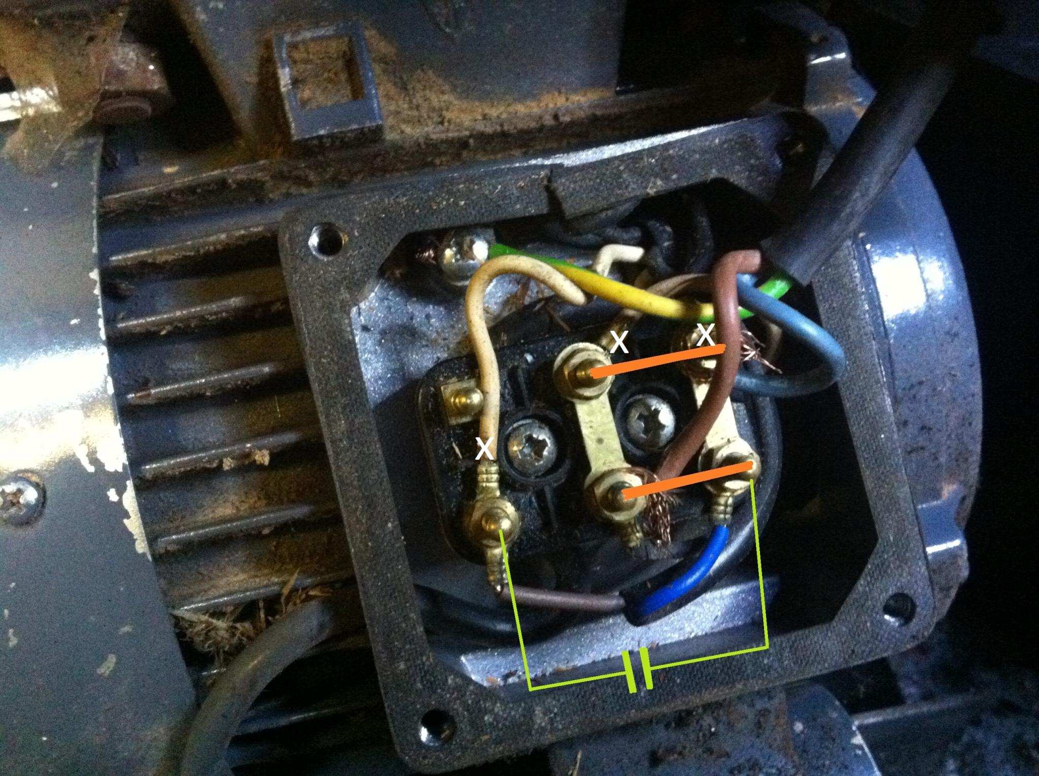

  10. #19
    The u1 v1 w1 (as you call them) must be the three white wires under the "X" symbols
    I might be able to make sense after some drawing and thinking :)
  11. #20
    That is my question now too.
    I would expect all motor wires on 1 side actually... may my bad.
    Do we agree on the schematic?
    Grtz Bert.
