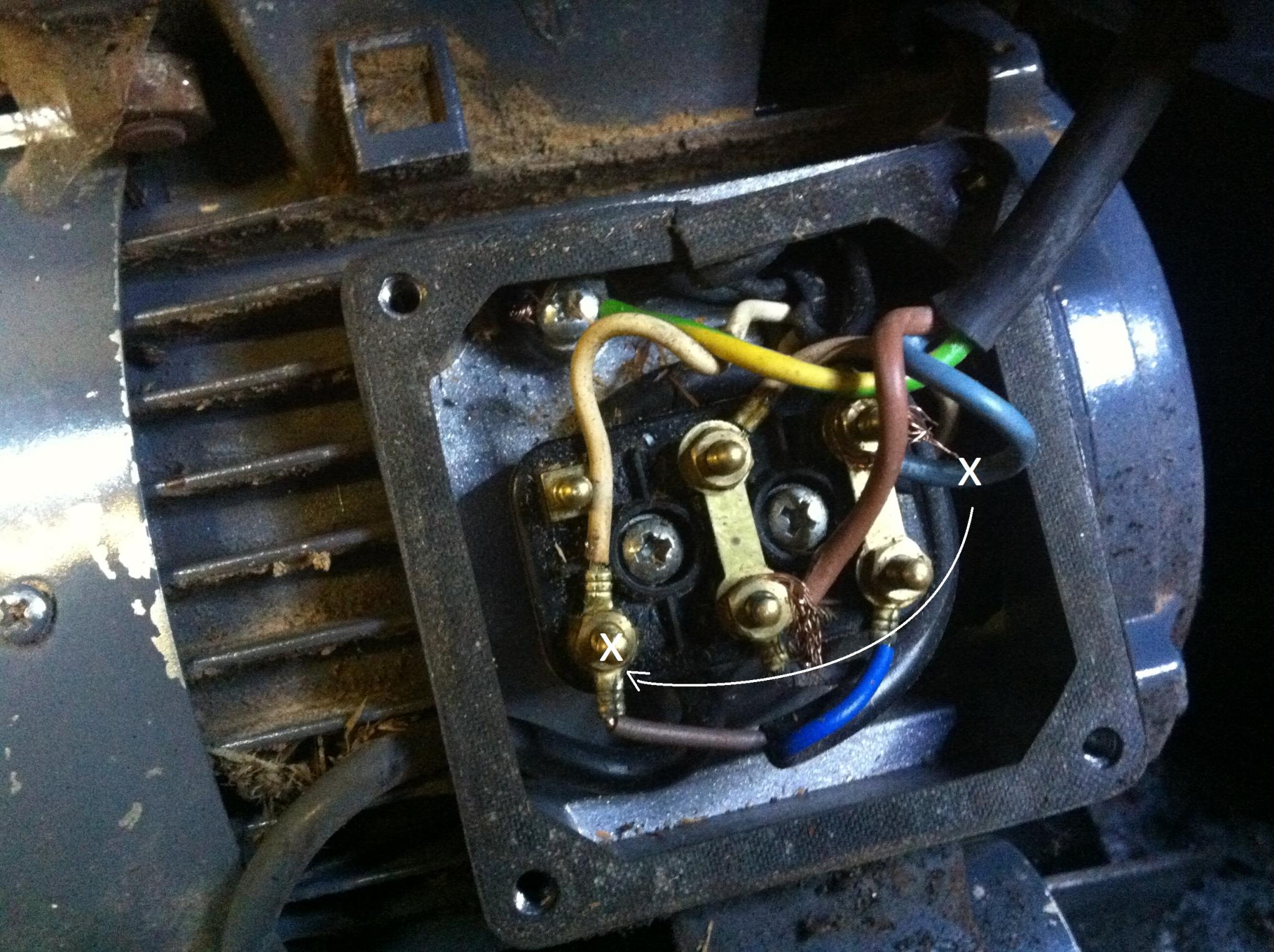

    The u1 v1 w1 (as you call them) must be the three white wires under the "X" symbols
    I might be able to make sense after some drawing and thinking :)
    If i had to make it run reverse i would move the power cord blue wire to the left bottom contact IE the other side Capacitor termination.
    Grtz Bert.

    Quote Originally Posted by driftspin View Post
    Grtz Bert.
    You mean like this?
    That would be bliss as I may be able to implement that without removing the motor again (infinitely variable drive and its a bitch)
    What's the chances of blowing something if I give it a try and its in Delta or some other strange format?

  3. #23
    I would expect all motor wires on 1 side actually... may my bad.
    I would too but I'm assuming its been dropped onto that pin for lazy convenience // the fact that it uses bus bars tells me all those pins are isolated so one is as good as another :)

    Lives in East Lothian, United Kingdom. Last Activity: 12 Hours Ago Forum Superstar, has done so much to help others, they deserve a medal. Has a total post count of 2,994. Received thanks 376 times, giving thanks to others 9 times.
    The wiring depends on what kind of single phase motor it is.
    You will likely find there are 2 coils (your main run winding, then a smaller start winding) with all wires brought out to the terminals.
    IIRC to change direction, you need to switch the position of the start winding/capacitor, however it's been a good few years since I've looked at a suitable diagram to be 100% sure about that.
    I "think" I may have cracked the logic of what I am seeing.....
Name:	Think I can see the logic.jpg
    Having not taken note of the drum switch position, it is possible that in both forward and reverse working conditions, the only change had been the capacitor (its hard to describe the logic, its been a bit of a Rubik's cube)
    I'm stuck at work for three days now so I cant test yet.... I think you guys talking of a capacitor switch were on the right track.
    Cheers for the help guys, you may have saved me from surrendering the cash and lumping for an inverter and three phase motor.
    I might finally get some use out of my thread cutting gearbox now (its metric so I cant easily disengage without losing position - I can just reverse out)
