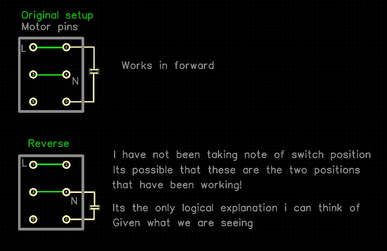

    The u1 v1 w1 (as you call them) must be the three white wires under the "X" symbols
    I might be able to make sense after some drawing and thinking :)
    If i had to make it run reverse i would move the power cord blue wire to the left bottom contact IE the other side Capacitor termination.
    Grtz Bert.
    Quote Originally Posted by driftspin View Post
    Grtz Bert.

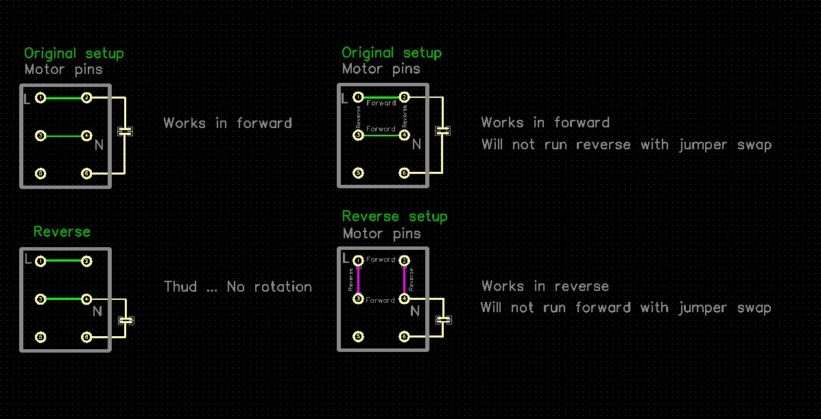

    You mean like this?
    That would be bliss as I may be able to implement that without removing the motor again (infinitely variable drive and its a bitch)
    What's the chances of blowing something if I give it a try and its in Delta or some other strange format?
