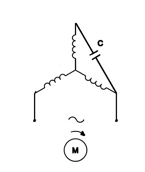

    Hi Mark,
    I think some of us can.
    It is just that i would want to see where the capacitor wires are going. just to be sure.
    Basically one moves 1 power lead from one side of the capacitor to the other.
    I cant really see where all wires are connected now so...
    I guess you have this setup.
    http://www.electricneutron.com/wp-co...-capacitor.jpg
    Grtz Bert.
    https://www.google.com/amp/s/www.ele...er-supply/amp/

    To reverse in the schematic i posted earlier we may assume the right lead is neutral.
    Then the left lead is fase.
    when you move the fase wire to the top the motor will reverse direction.
    You should check what i am saying next.
    In the picture you posted i think the motor wires are all on the bottom row.
    Starpoint of the motor is hidden.
    Did you draw in green where the actual capacitor is ?
    Grtz Bert

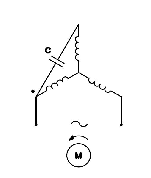

  7. #6
    Quote Originally Posted by driftspin View Post
    The left lead is fase.
    Grtz Bert
    Are you saying I just move the capacitor like this or am I doing as I have been and moving the capacitor AND rotating the bus bars?
    You will have to excuse my poor grasp of AC motors
  8. #7
    Ah... wait a minute... the three sets of two pins...
    My apologies Bert.
    I think I'm gaining some perspective, I need to have a ponder on what is going on.

  11. #9
    Lives in East Lothian, United Kingdom. Last Activity: 1 Day Ago Forum Superstar, has done so much to help others, they deserve a medal. Has been a member for 9-10 years. Has a total post count of 2,913. Received thanks 360 times, giving thanks to others 8 times.
    How it changes direction, depends on what kind of capacitor setup is being used.
    Essentially you need to swap how the two windings and capacitor are connected. If all you're getting is a thud, it sounds like you've missed the capacitor out of the circuit, or have shorted the capacitor out.
    I have tried searching for a suitable diagram, but have so far came up with nothing simple.
    I'd suggest putting it back to how it was, then try reversing direction with the bus bars.
    If that doesn't work, try moving the capacitor connection by moving the right/outer connection.
  12. The Following User Says Thank You to m_c For This Useful Post:
  13. #10
    I think I might have cracked it.....
    I have wired the cap to pin 4 instead of pin 2 (my error // I think my drawing is correct but my actual wiring is wrong)
    So in forward, pin 2 is not seeing the cap but in reverse it is.... ill know in an hour or so if I can get my hands in there with a mirror a light and a spanner :)
