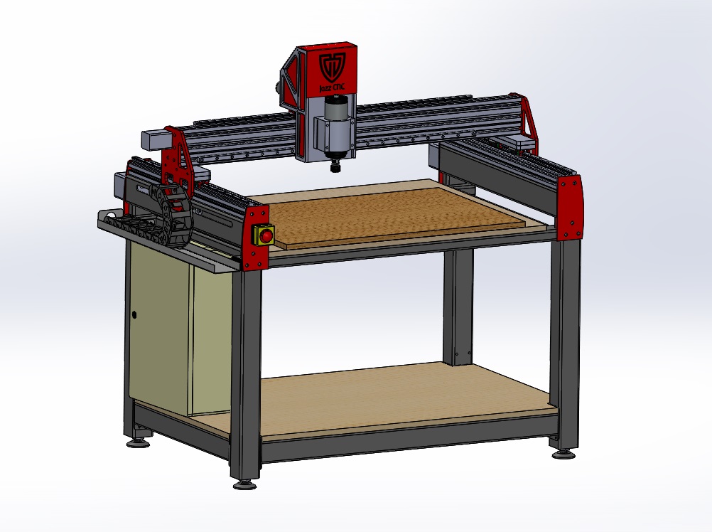

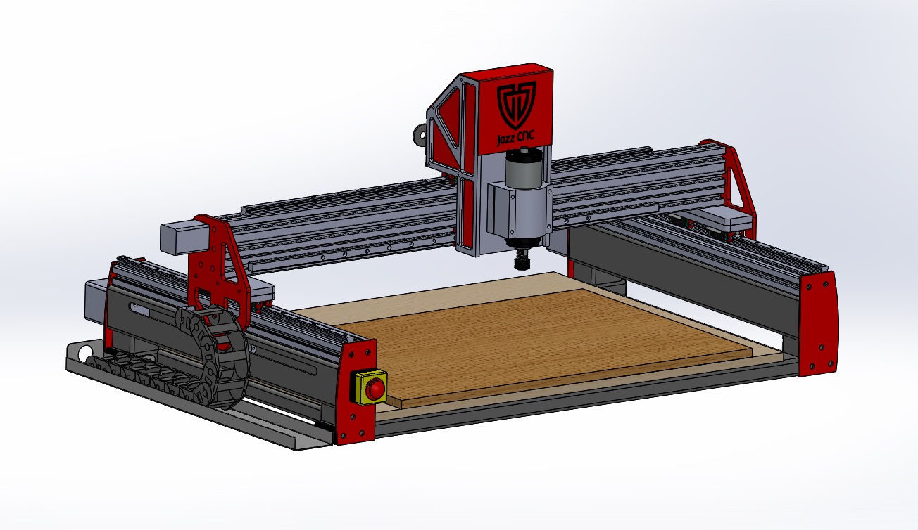

    So here comes the self-promotion.!! . .. I wasn't going to do this just yet but why not as others will no doubt be watching this and it may just save them buying rubbish.!
    I'm currently building several (8) machines in two sizes, 1250x600 and 900x600 that I'm going to offer for sale to meet the needs of people on a lower budget that uses the same wide/narrow format but obviously done correctly and with much better components, like profiled linear rails, etc.
    Fully welded steel frames using 100mm and 80mm 5mm wall tubes with 5mm and 10mm steel plates in various places. The Gantry will be using my proven "L" shape design using HD profiles directly sat on the linear rails with 10mm steel gantry ends for connecting to the ball screws which will be located inside the top tubes to protect and keep the width down to a minimum.
    The Z-axis will be a new design (for me anyway), which is still fully covered like what I fit on all my machines and using a 20mm Cast tooling plate but with pocketed 10mm side plates which bolt into the rear plate and make a much stronger z-axis.
    The Motors will be Lichuan 5.5Nm and 4.5Nm Closed loop with AC drives directly driving the ball-screws.
    I going to offer several options ranging from a fully built working mechanical frame with motors but no electrics or spindle etc for those that have the knowledge to tackle the electrical side. Then going up in electrical spec. In Total there will be 5 options starting at just over £2k up to £4k for the fully loaded floor-mounted Ethernet version with Spindle PC etc.
    All the machines are Bench mounted with an optional Stand to make it free-standing.
    Here's a sneak preview.! If anyone is interested get in touch via PM.

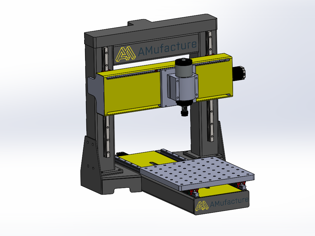

    Thanks, Moray, Quite a lot of time has gone into this project trying to get the best machine for the lowest budget, while at the same time making sure there's profit to make it worthwhile doing. So far I'm very happy with the design and the frames are rock solid, but the profit will remain to be seen...Lol
    The first batch won't be ready until Mid to late December and half of those are sold or spoken for already so the next batch if I do another, will be next year anyway.

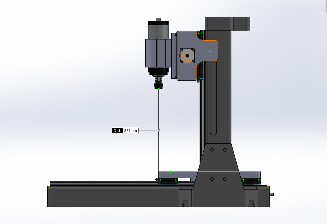

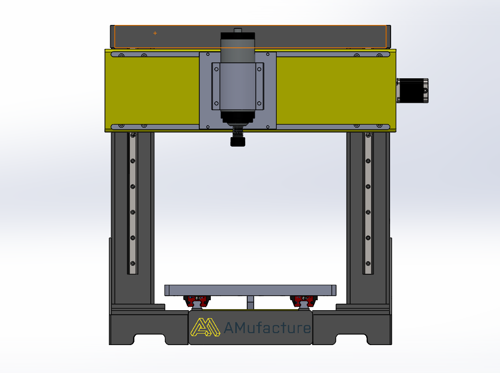

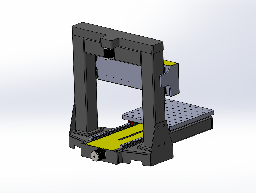

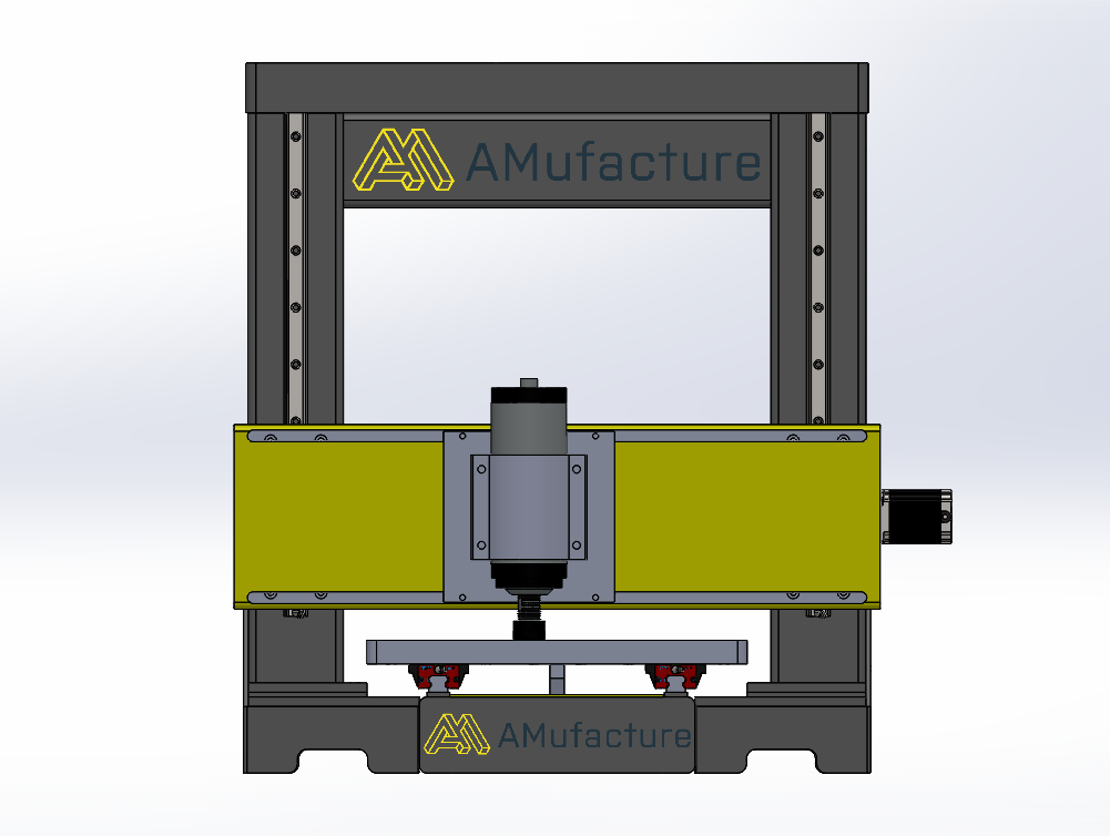

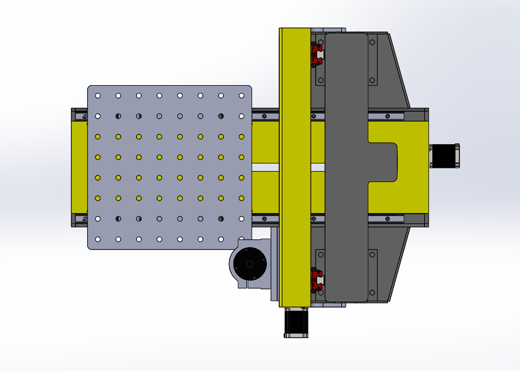

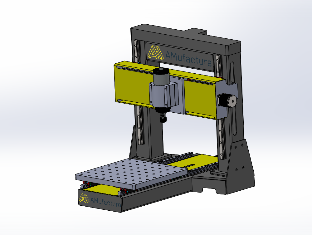

    I've also got this little beast in the line up as well which I'm going to offer up. 500 x 500 x 350 Cut. Fixed gantry which is a little different in the gantry department.! It's built like the proverbial brick Sh#t house. I'm on with this one at the moment which is spoken for and will be ready in the next 3/4weeks so I'll take a video of it to show more. Another will follow it and be up for grabs.
