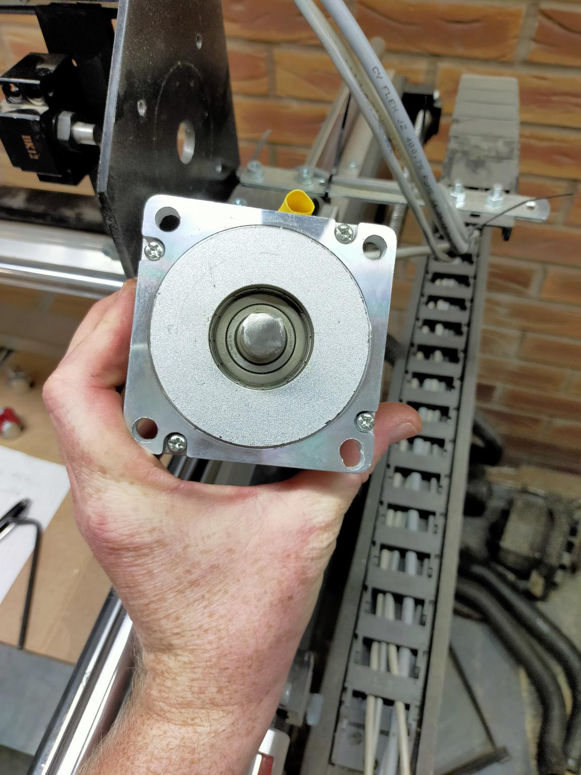

    Well a tear down for a creaking noise is proving interesting.

    It's not the best camera angle, but has that snapped, or have they shortened it with a hammer and chisel then buffed it grinder?
  7. #57
    Shortened yes but look at the bottoms right mounting hole also.

    You can see it better here

    I've seen a Chinese-built router where a lot of holes looked as if they had been drilled freehand, and the target for a proximity switch was a broken tap. Did have a locknut on it, though! And by the standards of these things, that was a fairly good router that's been doing a good job for a few years now. If that's what you find on a machine a step or two up, you realise that a few corners get cut to bring the price down. Cheaper to re-drill a stepper motor flange than scrap the badly drilled bit it bolts to?
  10. #60
    Another thing I see lurking in the back ground is where it mounts looks like there is no hole for the flange so it's sitting directly on the un-machined surface of the boss..!!
